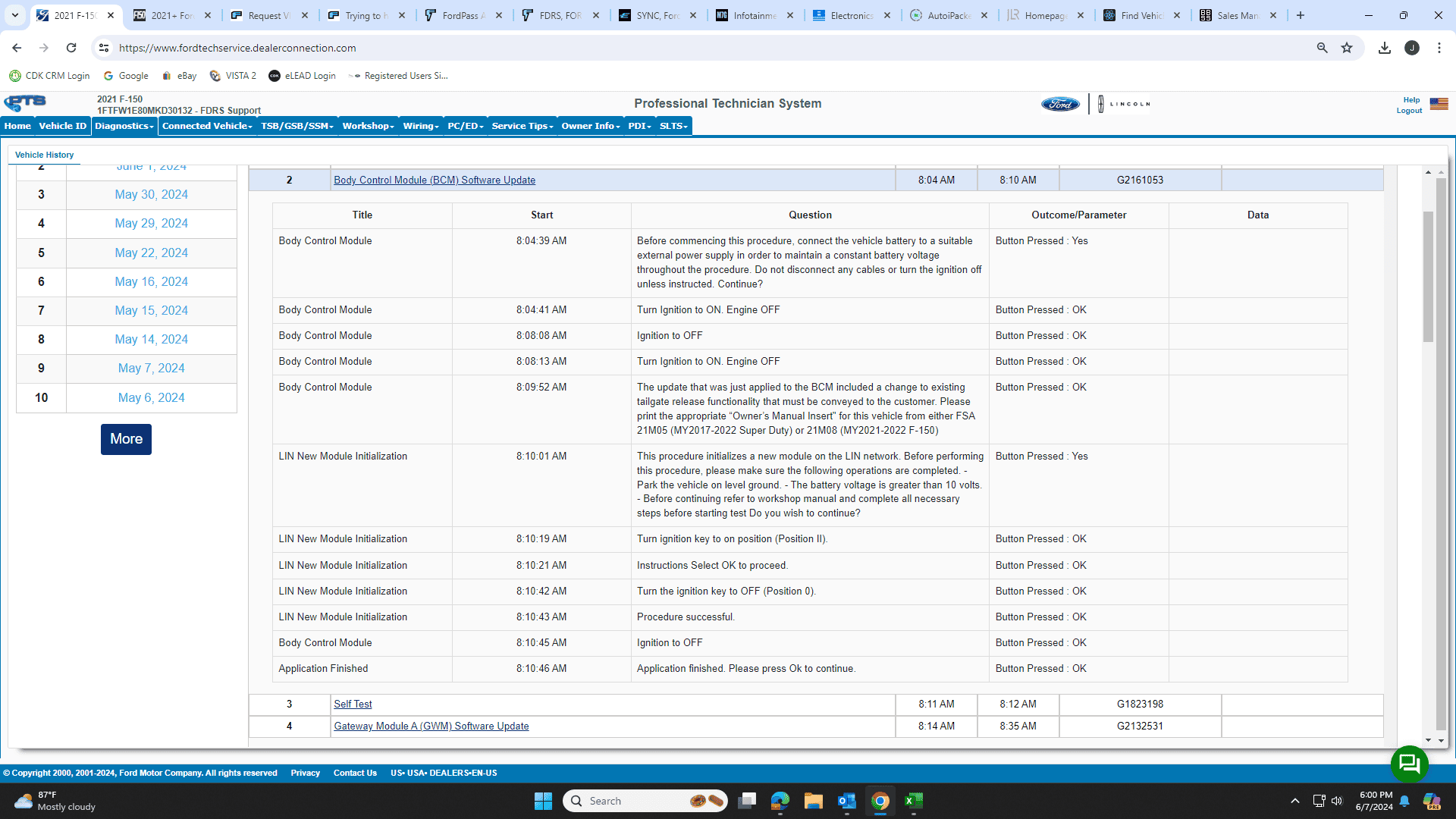

I agree with this. I don't have any BCM updates pending for my truck to try and see if my dealer login works. The dealer login gives you access to PATS to program keys, so I assume it is only an issue for independents, too.
Edit: Screenshot below is from a dealer updating an ICE F150. They updated the BCM with no problem on 5/29.

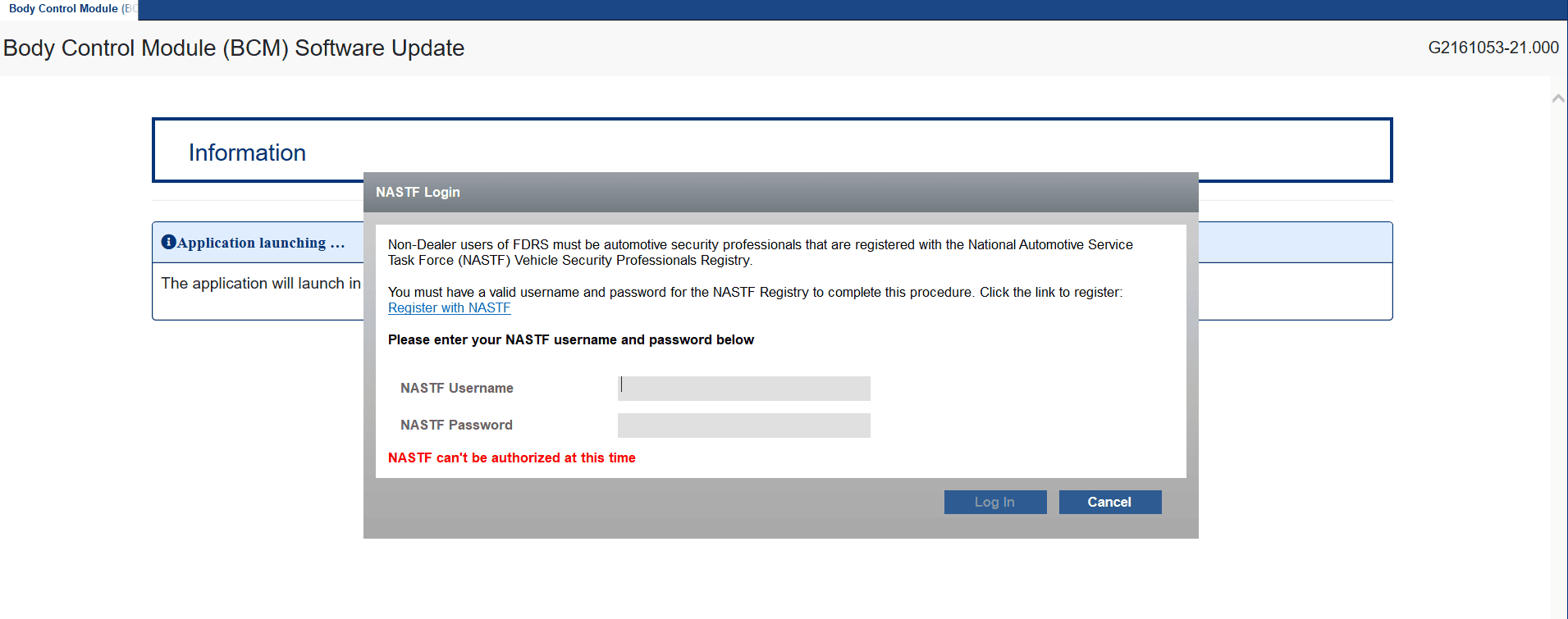

Looked around and found a screen shot, this is what I was getting when trying to perform the BCM update in FDRS:

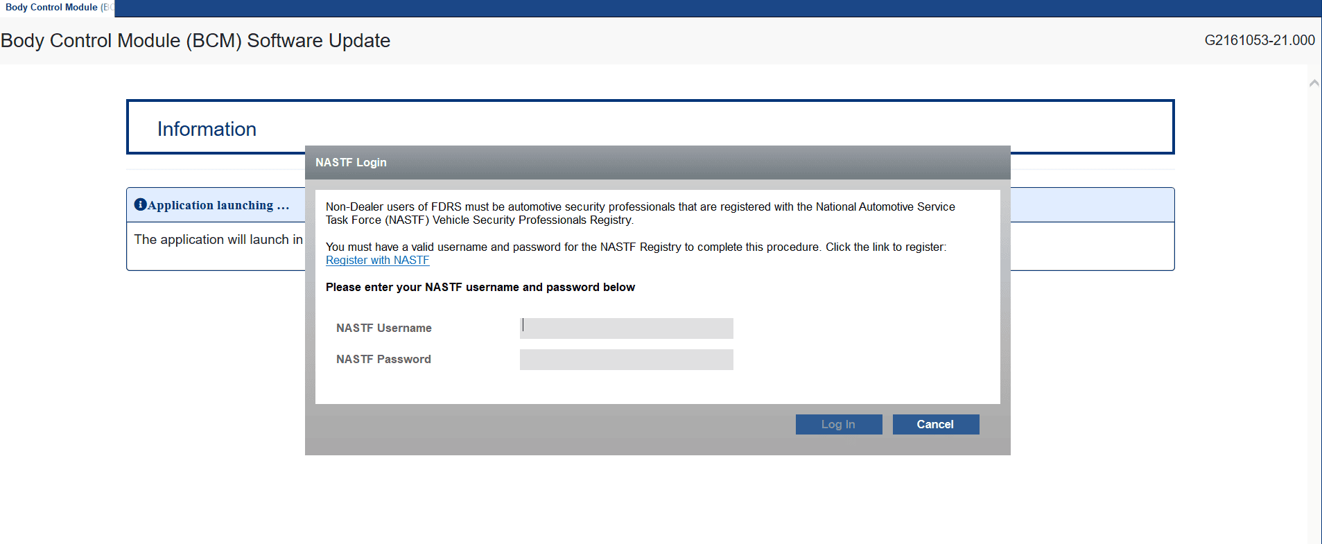

And this is what I saw if I tried to log in with an NATSF account, which didn't work:
Ford F-150 Lightning Lightning Software Updates using FDRS 1717800332307-7l
Thanks for that, I'll pass this along.....
