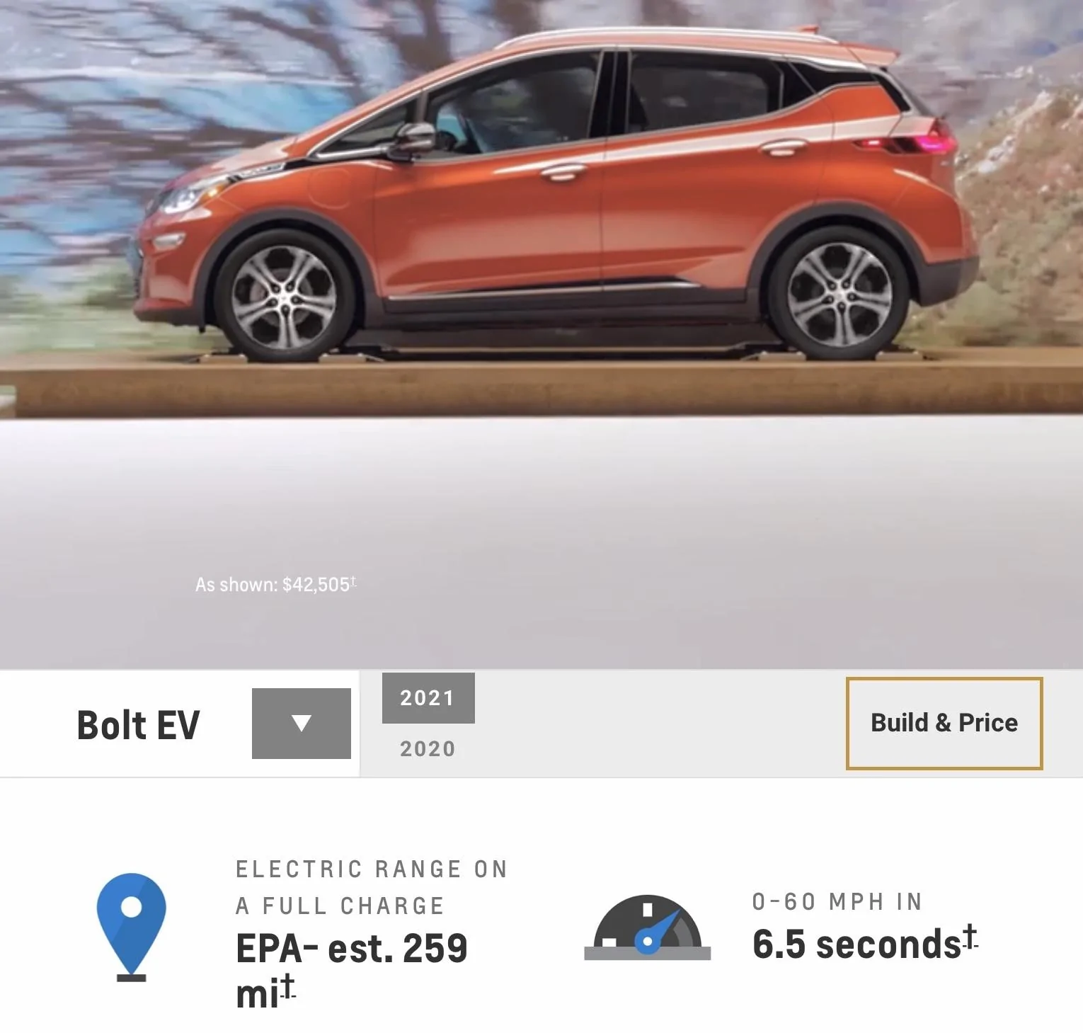

I think they need to adjust their marketing.
If I were in the market for an Electric car, of all the options available right now the F150 Lightning is the coolest looking BY FAR and THAT bar is pretty damn low.
So you can't "tow" with it... big deal!
Would you rather be driving the embarrassingly hideous Mach E or the Chevy Bolt?
Exactly! Price/range on Bolt is similar to the Base Lightning's numbers:
Ford F-150 Lightning Limited Lightning Tow Range 558EBAF0-D766-4460-9295-1EB8CB464042
If they are going down the path of offering the Lightning as a full fledged replacement for the ICE F150, showing it towing a double axle trailer and fail to provide an adequate charging network, Lightning will be a loser just because of that one detail that it shares with every other battery electric vehicle. Had they come out and said flat out, that it's not meant to replace your F150 with a gasoline engine but be an alternative to the battery electric sedans being used now and the battery electric trucks on the horizon, it would have been a lot more realistic.
Also, a plug in hybrid based on the Lightning, with a very small ICE engine and tank for highway cruising would have been more impactful, however not as much of something to brag about because hybrids are considered old fashioned by now.
