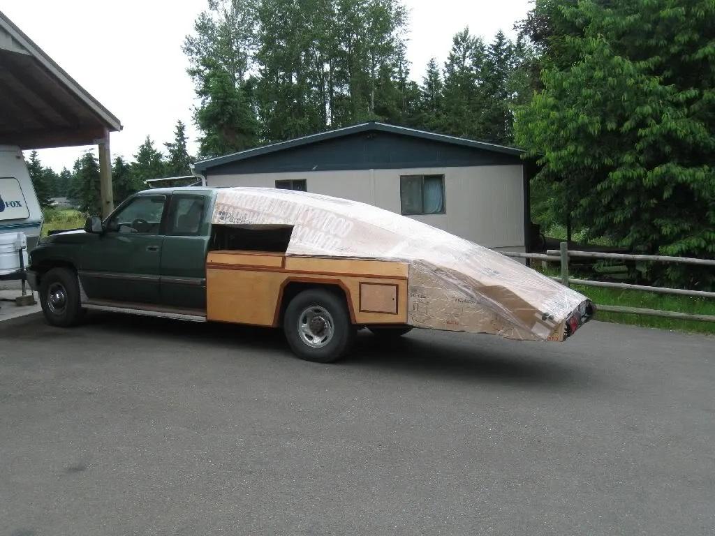

Additional information about Aero/Slant back caps for pickups:
https://ecomodder.com/blog/aerocaps-for-pick-up-trucks/
Scroll to the bottom and it shows DIY examples folks made and their results.....some nicer looking than others....
...this one looks the most cost effective diy (1/2" metal conduit & 4mm film) and not too horrible on impacting visibility....not so sure on the life span of the film...but should be easily re-skinable....on an 01' F250 lariat from 16mpg to 19mpg...
https://ecomodder.com/forum/showthread.php/f-250-7-3-4wd-light-aerocap-12573.html

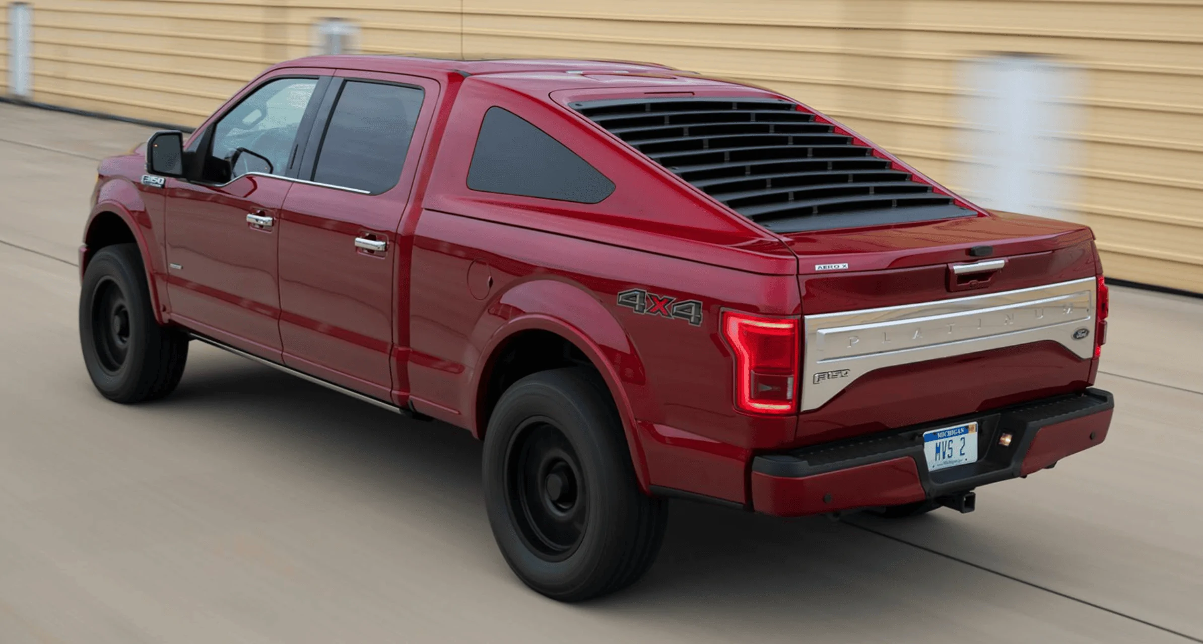

This entire video is pretty fascinating - it takes a thorough full body scan of a stock F-150 scan and does aero analysis on what could be done to reduce drag/increase mpg - however this one section of the video stuck out as something that seems easily (but costly) way to net a 14.8% reduction in drag:
Not sure how one would properly calculate the impact on range for this type of bed cover....but if going by the video and assuming if one did all the mods (some of which ford has already done with the lighning - ie more aerodynamic wheels, smoother bottom) and netting 26% reduction in drag equated to 12% increase in range - doing this one thing of adding a slant/aero bed cover yields a 14.8% reduction in drag - this should yield a 6-7% increase in range...so an standard range battery would go from 230 miles to 245 miles, and the extended range would go from 320 miles to 340 miles...
This seems really tempting to try out until seeing there really is only one group manufacturing a slant/aero back for pickups, and it is pretty costly ($4,500):
https://www.mivehiclesolutions.com/products/aero-x-f-150
If anyone tries this out - please post your findings! ;-)
Surprised this hasn't been mentioned before:
https://www.thedrive.com/news/26381...f-150-fastback-is-real-and-yes-you-can-buy-it
Pretty much an upsized Mustang fastback topper.

....yeah.... because this exact item was in the original post...with a link to ordering page.....
... there really is only one group manufacturing a slant/aero back for pickups, and it is pretty costly ($4,500):
