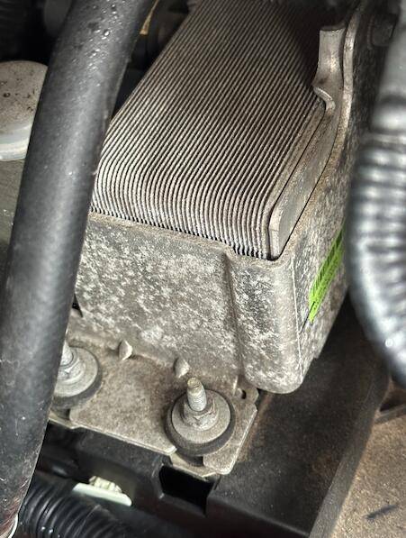

Nice set up! Question…I’m in central Texas, and salt is seldom used… are there any signs of salt induced rust/corrosion on your Lightning because of it?
I would say nothing to be concerned about. The truck looks new topside and underside side except for the road grime on the underside. This is my third winter in the slop and the truck shows no sign of corrosion anywhere except for a minor bit on the heat sink in the LVB bay to the passenger side of the LVB. Not sure what the component does but it is tied into the cooling system. It looks like a cooler.
Ford F-150 Lightning LVB EASY ACCESS JUMP/CHARGE  PORT 1738863979303-ye
Ford started using the aluminum bodies in 2015 and they've held up quite well here in the salty crap. The previous generation generally had holes in the cab corners around 8-10 years and we are just at that mark now for the aluminum. Time will tell.

It's your HVB heat exchanger, connected to AC compressor, on MaxTow trucks it's on the drivers side connected to the exclusive secondary AC compressor .

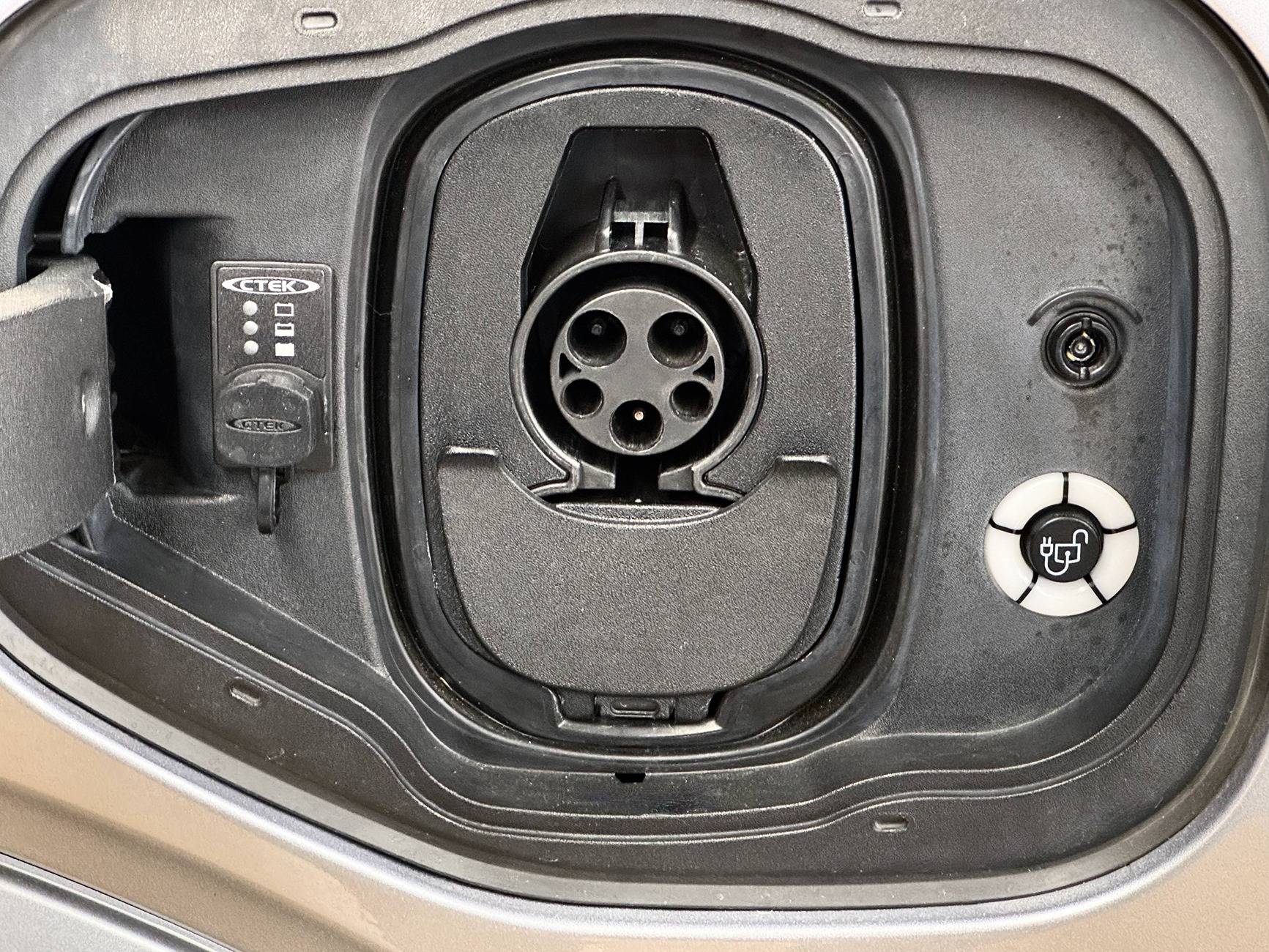

Nice setup, I to would like to find a better solution that's rearward of the Frunk zone, if God forbid my trucks LVB goes T/U I can't open the frunk in my very confined garage space, I need a port further back or inside the cabin where I could plugin the pack.
I had a similar problem, when my Leaf LV battery went dead-ish after I had been on vacation (before I set up a trickle charger).
It was nose-into the garage and my regular jump cable would not reach - I used two jumper cables clamped end to end to reach - then I bought an extra long one for the next time.
A jump location in the Lightning bed would be really useful if the Frunk won't open (manually) enough to reach the battery or jumper terminals when the truck is inside a garage.

EDIT: or locate the terminals under the charge port access cover.
