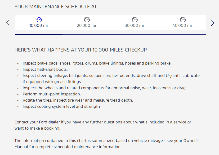

So, which is it... rotate tires every 5,000, or 10,000 miles? If I can remember right, I rotated my tires on my old F-150 every oil change (5,000 miles) because I think I read it in the manual. I did a quick search in the Lightning manual and I saw the rotation pattern but I didn't see how often to rotate them. I rotated mine at 5,000 and I will have 10,000 miles this week.

Officially the Lightning requires 10K rotations, but some of us old school thinkers go for 5k.

If you login to the Ford account dashboard, click on "view all vehicle details" and scroll all the way down to the tiles. One of them should say "Maintenance Schedule." It lists all the maintenance actions your lightning will ever need in 10K mile intervals, all the way up to 200K miles.
Ford F-150 Lightning Maintenance Schedule - 10k service 1710029905481

You didn't read that in a F-150 manual, and the Lightning manual (as well as FordPass) clearly says 10,000.
