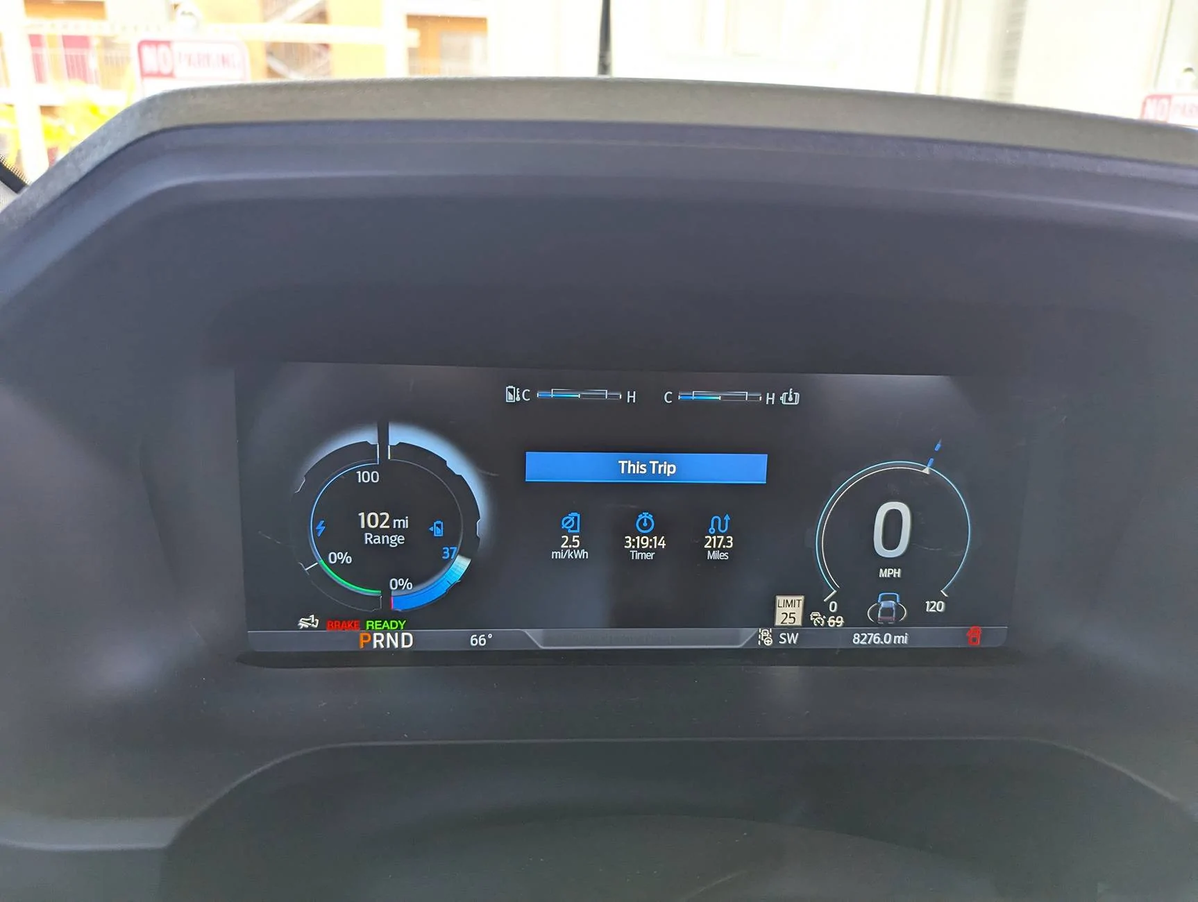

The estimate of remaining range is only as good as the data provided to the vehicle. If you just want the same range at a given remaining battery %, then take your favorite 100% range (320, 300, 270, whatever) and multiply be the % remaining.
If you want to know how far the truck calculates you can go with the energy remaining in the battery, then you'll need to understand why and how it uses the data it uses.
In this example of highway driving, I started at 100% battery and cold soaked at about 32 ā°F.
On one hand, after driving 217 miles, the truck estimated that I had another 102 miles of range, which would be 319 miles, almost spot on to the EPA estimate for my truck.
On the other hand, the miles/kWh efficiency calculated and shown on the screen (2.5 miles/kWh) suggested that I should have had a total range of 328 miles, so I should have a range of 111 more miles. Not a huge difference and nothing to worry about.
On the gripping hand, the remaining battery state of charge (37%) means I used 63% to go 217.3 miles, so that calculation would suggest I should have had a range of 345 miles at 100% (217.3Ć·0.63 = 345) and should have 345-217 = 128 miles of remaining range.
Which is correct? I'm my case it's the 100 miles or so distance to empty. Ford blends--via a weighted average--multiple long-term and short-term inputs to determine their best estimate of distance to empty. If my long-term behavior is to use a lot of HVAC, but I didn't use much in the last 50 miles, it might assume that I'll use more for the rest of my driving. If my long-term average speed is high, but I recently have only been driving at 45 mph (say because of construction), then the estimated distance to empty night be lower than the unusual 45 mph might suggest.
If you don't want that, I suppose you can reset your driving history every time you recharge so the vehicle starts over and uses the basic estimate instead of learning about your particular driving patterns.
