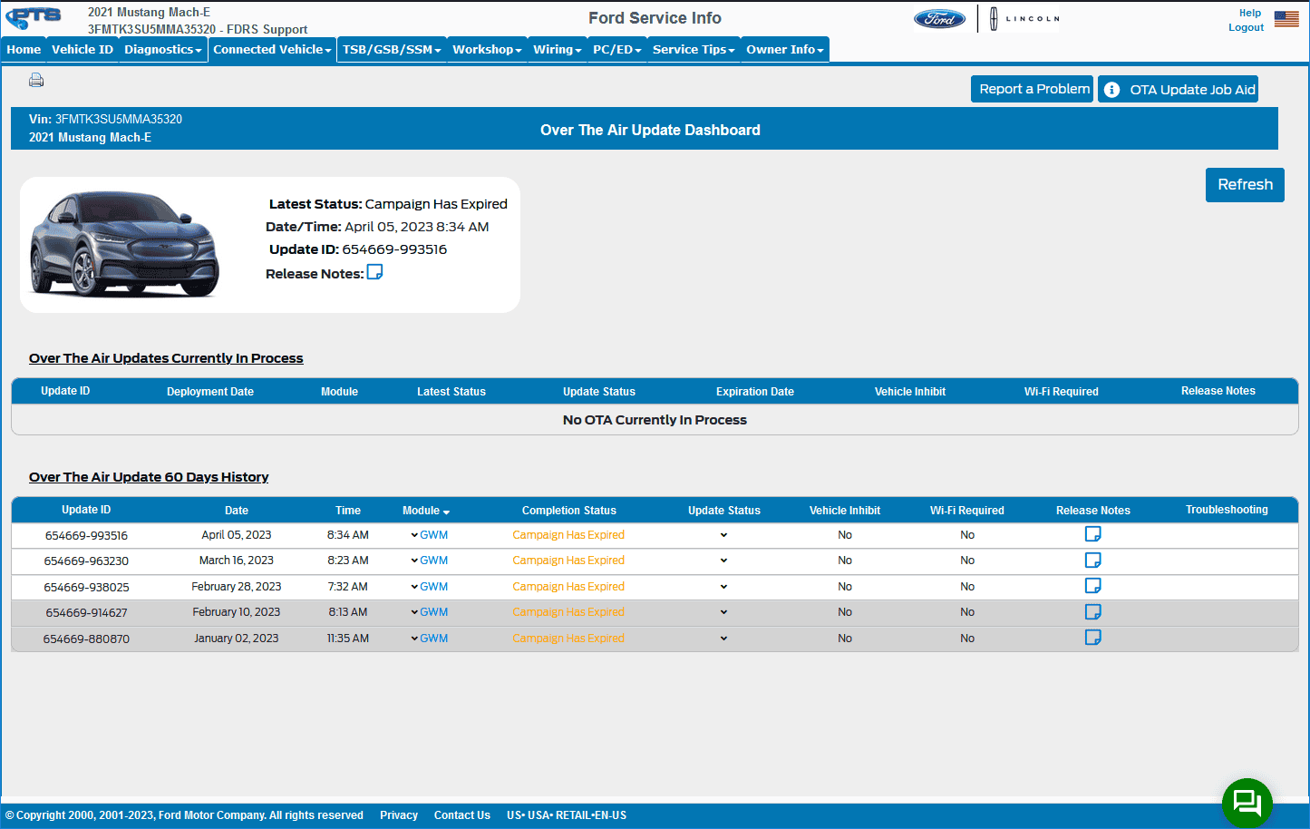

Follow up.
For those who bought mannequins and are not getting updates there are some additional things to know. Dealers were directed to put mannequins into a Ford system called FCTP which is used to manage fleet vehicles. There have been reports from some members that after the vehicle was sold to the first customer it was discovered that certain update functions in Sync were "grayed out" and unable to be changed or selected because the vehicle was still in "fleet mode". For some a trip to the dealer sorted that out, for others it required intervention of tiers above the normal levels of support.
The next thing is the fact that OTAs roll out on a schedule. If you have a '22 model truck and OTAs were pushed out but due to Sync update settings while the truck was still at the dealership, it never got updated, then those OTAs probably "expired". After a while if the updates don't get accepted or processed the system just gives up.
Here's what that looks like:
Ford F-150 Lightning No Vehicle Software Updates Received 3FMTK3SU5MMA35320-OTA-Expired
So if you check with your service advisor and the section that says "Over the Air Update 60 Days History" is completely empty as an example, the dealer tech is gonna have to diagnose why that's happening and actually do some update programming to get things back on track.
