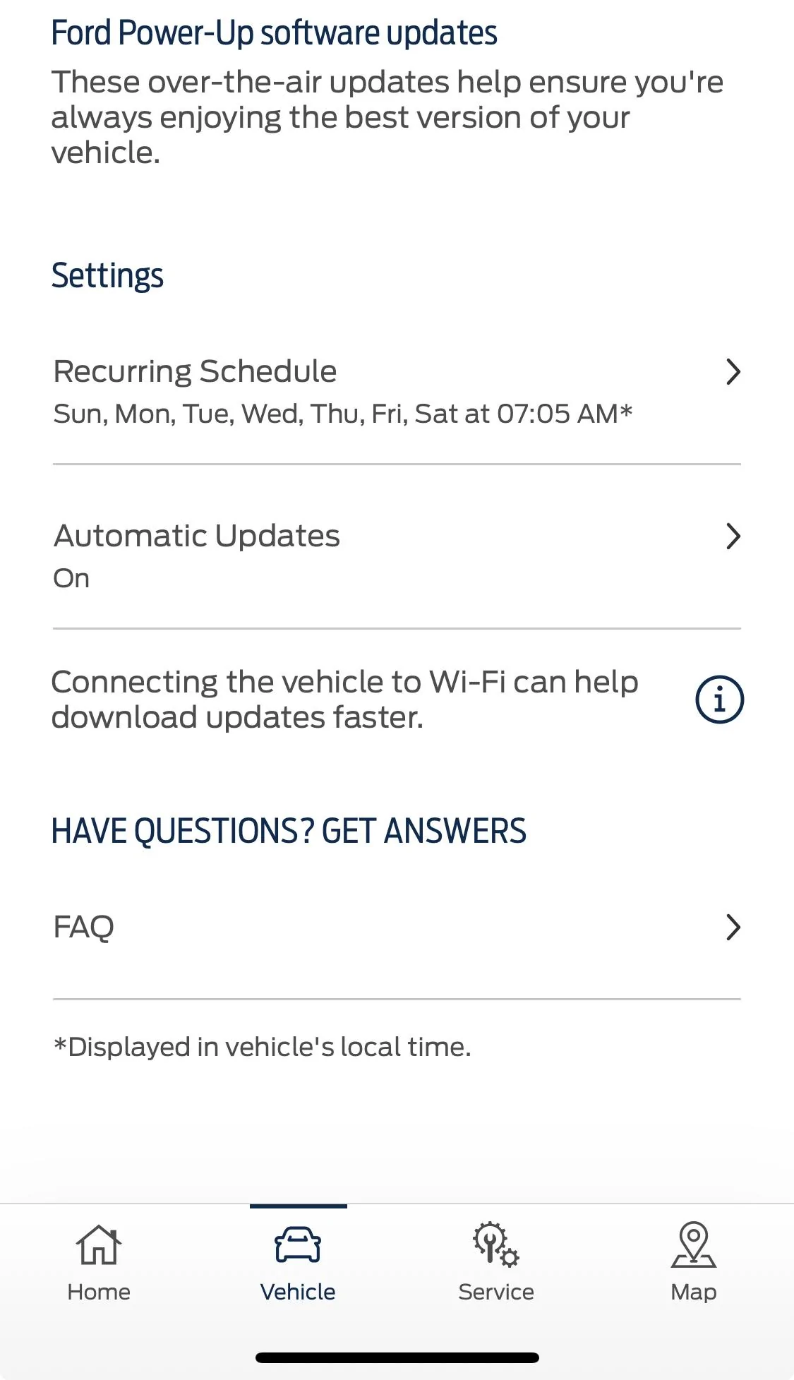

Leaving your truck plugged in to the EVSE does not "trickle charge" your 12V battery.
Your 12V battery starts discharging the moment you stop driving the truck and by 0100 in the morning you can be assured that it will be below the 80% state-of-charge threshold needed for the update logic to process an OTA.
By 0700 in the morning it's likely more like 45-50% SOC.
Once the 12V battery drops to 40% SOC an internal timer starts and after 48Hrs the system will then charge the 12V battery back up to 80% (using either the EVSE or charge from the HV battery through the DCDC converter).
If at anytime the 12V battery drops to 30% SOC the system will immediately initiate a charge of the 12V battery back up to 80% SOC (using either the EVSE or charge from the HV battery through the DCDC converter).
Driving it for a half-hour recharges your 12V battery back up above 80% so the update logic will allow the OTA to process.
It's analogous to starting an ICE vehicle and letting the alternator recharge the 12V battery back up.
Why anybody would think that having updates process at Ford's default time of 0100 when the 12V battery is virtually never going to be at the required state of charge after all that's been written about this is a mystery.
Set your schedule to check about 15 minutes into your normal daily commute either to or from work and you'll have far more success with OTAs.
