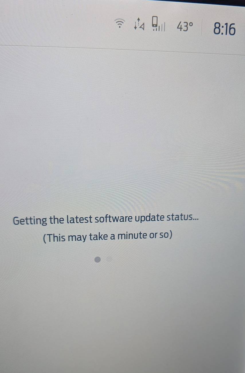

Posting this for any of you who might experience the same.
My 23 Lightning Platinum had been stuck on "Getting the latest software status, this may take a minute or so" for the past 10 days.
I made a couple of calls to Ford OTA support, and they were stumped, and suggested I take it to the dealer for a modem check.
I had tried pulling Fuse 32 (modem?)....
I tried charging the 12V battery....

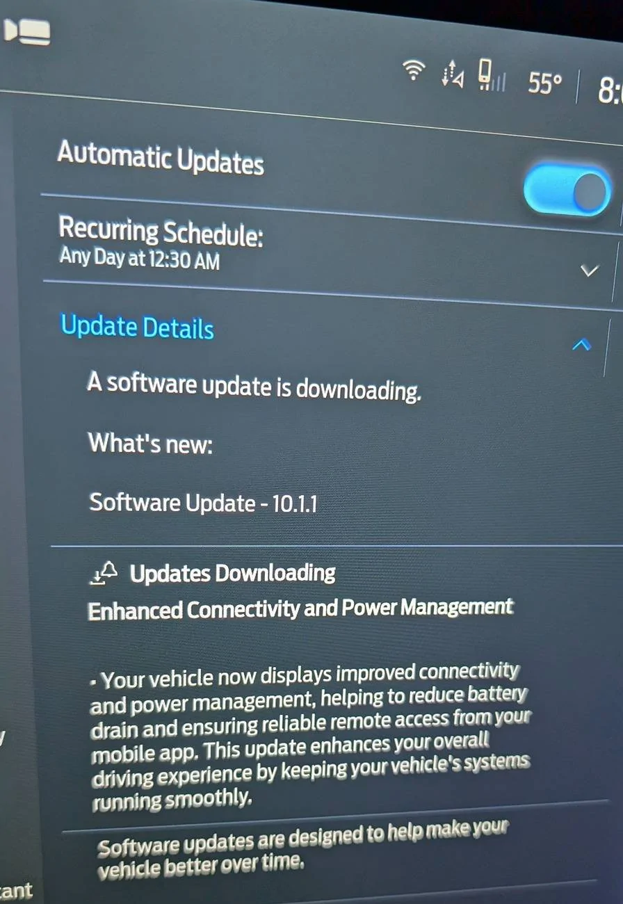

Against the advice of OTA help, I decided yesterday to disconnect the negative from the 12V battery for about ten minutes. After doing this I saw an immediate message, that a software update (10.1.1) had failed.
This morning, I got the message that a software download was in progress; 30 minutes later, I now have 10.1.1!!
A couple of caveats to watch for when doing this:
Don't have your tailgate down, and don't (inadvertently) hit the emergency release button on the frunk. I had issues getting both those back in sync, after I reconnected my battery.
