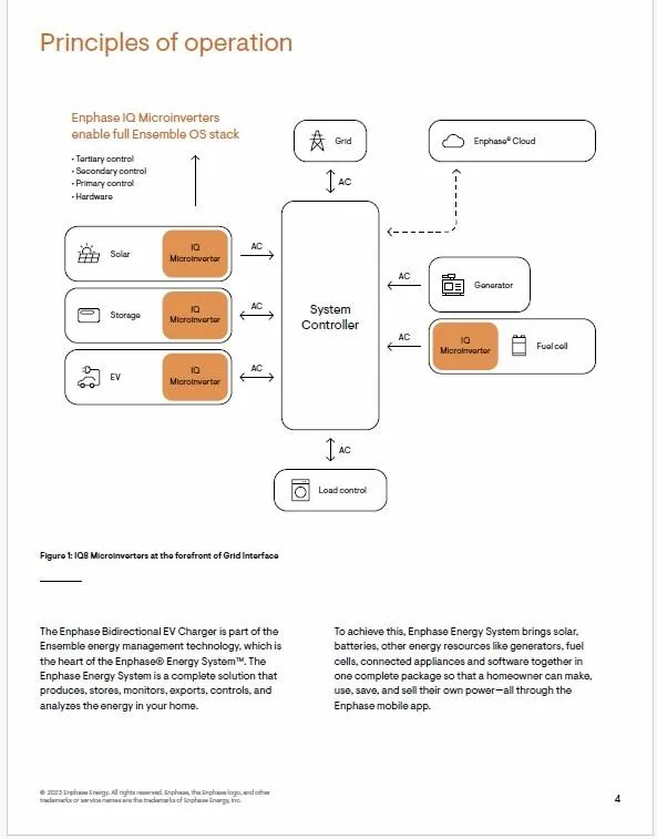

EDIT: I just read that "Enphase is in the process of making a bidirectional ev charging station. It is standards compliant so will work with any V2X capable vehicle...."
"We are working with EV manufacturers and power utilities to bring this revolutionary technology to market starting in 2025. If you would like to partner with Enphase, contact us for a technical demonstration."
Their web site has a white paper about it:
"The Enphase Bidirectional EV Charger enables vehicle-to-home
(V2H) and vehicle-to-grid (V2G) functionality. This product
will leverage the power of grid-forming IQ8™ Microinverters
and Ensemble™ energy management technology to seamlessly
integrate into Enphase® home energy systems, and will enable
homeowners to manage their solar, battery storage, and EV
(electric vehicle) charging all from a single app. In addition,
Enphase’s Bidirectional EV Charger will be simple to install and
will work with most EVs that support bidirectional charging...."
https://enphase.com/ev-chargers/bidirectional

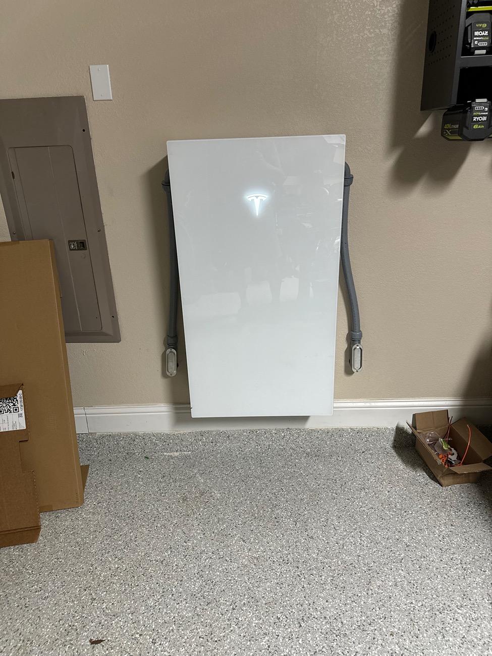

It is available with the cyber truck they call it PowerShare, but I am not sure it is enabled yet and you have to have the powerwall 3? (I think) So I am hoping that in the future, this will allow us to use It as well, although I may have to change out the FCSP with the Tesla universal adapter?? I am currently installing solar with the power wall three so fingers crossed.??
https://www.tesla.com/powershare

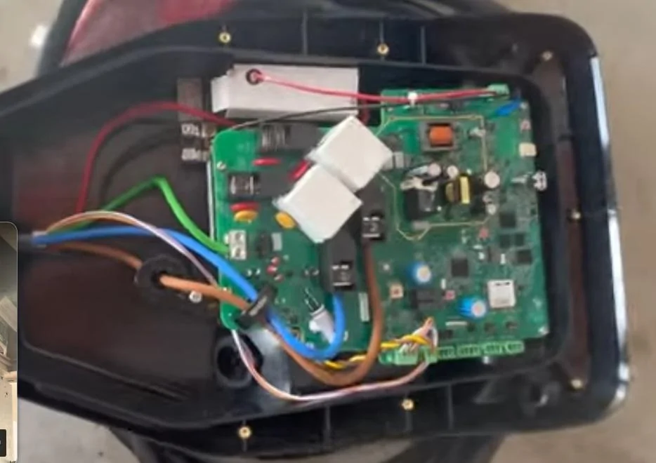

Unless he is going to use the Home Integration, he could take this opportunity to just swap the FCSP CCS1 cable for an 80A J1772 cable (assuming he's wired to charge at 80A ).
I though about doing that, everyone seems to be sold out of the 80A J1772 though, and some day I hope to integrate through the FCSP.
Maybe less hassle to replace the cord with a J1772 than replacing the FCSP with another brand (Tesla with a J1772 adapter for example) or trying to get the plug open?
Just 5 wires to cope with in the J1772 cord.

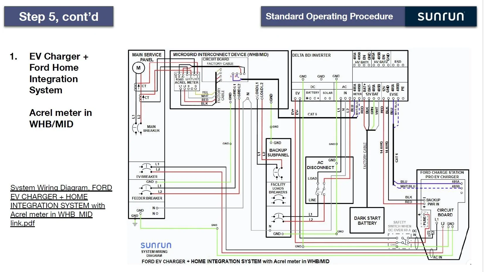

You can get the hardware for the home integration for about $3900 from aeesolar.com and have someone else (or DIY) install it for less than that $6k:
Ford F-150® Lightning™ customers can choose any installation provider of their choice. The Home Integration System and Ford Charge Station Pro hardware are required to enable Home Backup Power. The Home Integration System hardware is available for purchase without Sunrun installation through our vendor AEE at his.aeesolar.com, and the Charge Station Pro hardware is similarly available through Ford, here. Both systems should be installed by a licensed electrician.
https://www.sunrun.com/ev-charging/ford-f150-lightning
Please note that you are only purchasing the hardware from this site and there is only a 30 day return window. This product requires professional installation by a licensed electrician. It is recommended to select an electrician and order the equipment as close to the installation date as possible.
Please visit
Sunrun after your truck is scheduled for production if you would like to purchase the hardware with installation.
Also note that this page is for Customers only. If you are a Professional Installer
click here to be directed to the Ford Professional page to complete your purchase.
030-09844-ITC26 = 4kW On-Grid, 9.6kW Backup Inverter Capability
030-09845-ITC26 = 6kW On-Grid, 9.6kW Backup Inverter Capability
030-09846-ITC26 = 8kW On-Grid, 9.6kW Backup Inverter Capability
030-09847-ITC26 = 10kW On-Grid, 9.6kW Backup Inverter Capability
(All versions come with a Bidirectional Inverter, Microgrid Integration Device, and Dark Start Battery)
Only consider an inverter larger than 4kW if it is being integrated into a solar electric system. Sizing above 4kW will increase the likelihood of additional electrical upgrades from the utility, which could incur additional cost and time. Consult with your solar provider to determine which inverter your system requires.
If you are a Ford customer, click the "Register" button above and create your account and place your order.
What is On-Grid Inverter Capability?
On-Grid means the Utility Grid is still functioning and you are NOT in backup mode. This capability is only available for solar and stationary battery storage.
The Home Integration System is a required component for Ford Home Backup Power. When paired with the Ford Charge Station Pro, the Home Integration System will allow energy to flow from your Ford F-150 Lightning to your home. This enables your truck to power your home in the event of an outage.
The Home Integration System will arrive in 3 packages.
  1. Bidirectional Inverter (4, 6, 8, or 10kW)
  2. Microgrid Integration Device
  3. Dark Start Battery
So it looks like you'd also need to have, besides the FCSP, an AC disconnect, a back-up sub-panel, a feeder breaker and some wire/conduit to run from the sub-panel to the main panel.
Ford F-150 Lightning Plug Will NOT Disengage From FCSP FIXED POST 87 Integration System CSP-SunRun wiring
Maybe another $500 or so in parts for the above.
Then the rest is labor.

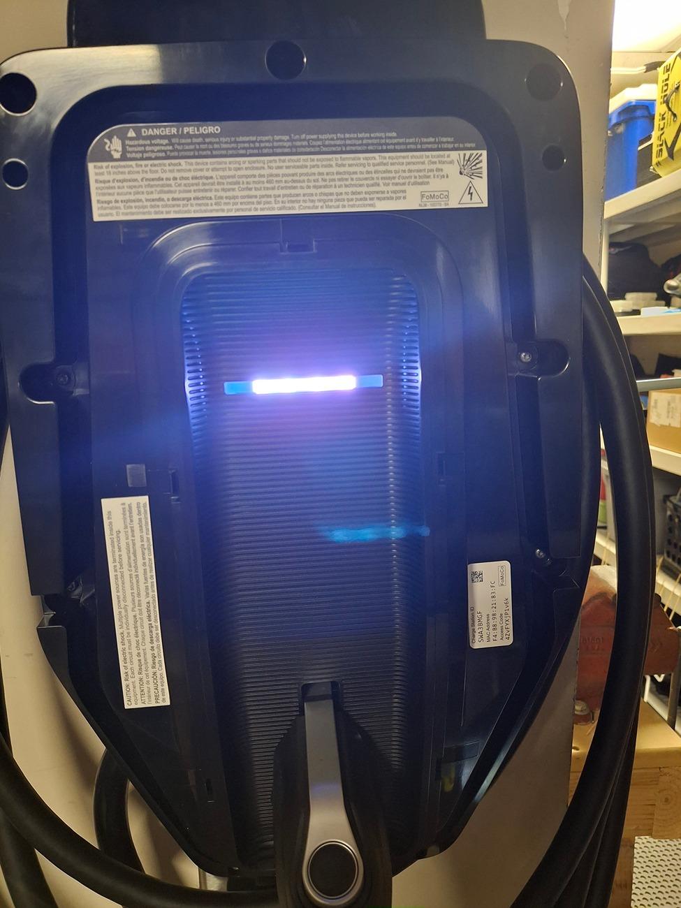

I finally got through to Siemens customer support at the number listed above. They promptly referred me to their Emobility support group - which is 855-950-6339. That group is only open Monday through Friday, from 6:00 AM until 8:00 PM Easter Time.
Just got off the phone with Siemens and need to send them some pictures. They are then going to reach out to FMCO. We will see what happens.

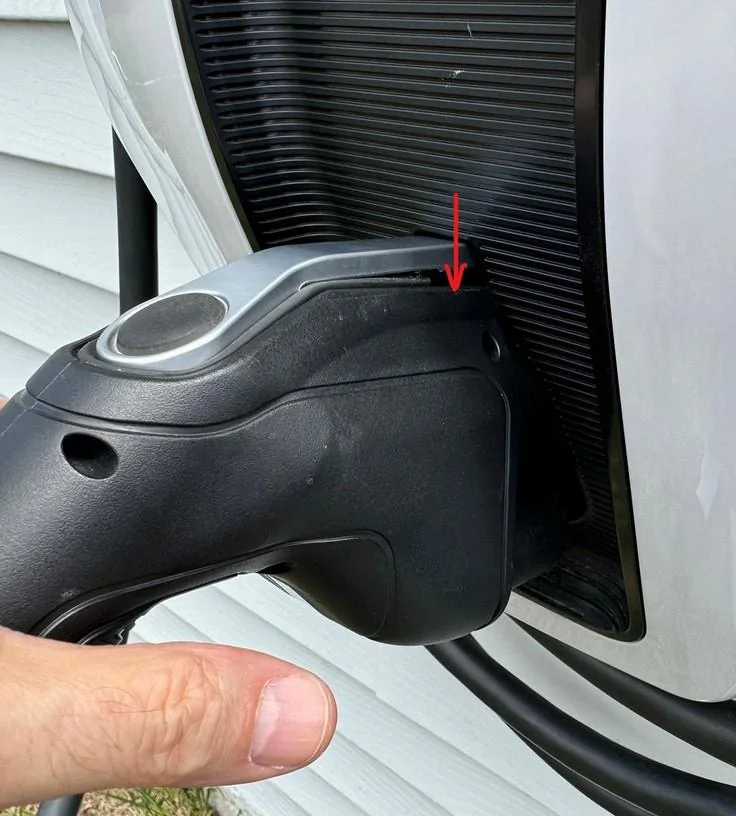

I wish you good luck, but waiting and not being able to charge would inspire me to solve it.
Ford F-150 Lightning Plug Will NOT Disengage From FCSP FIXED POST 87 20240710_110550

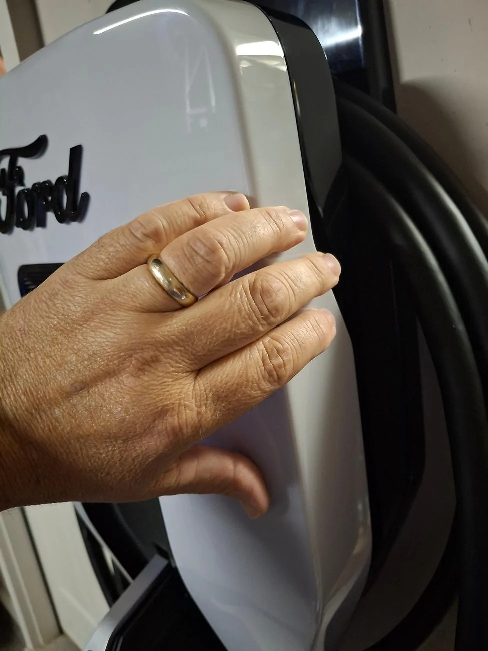

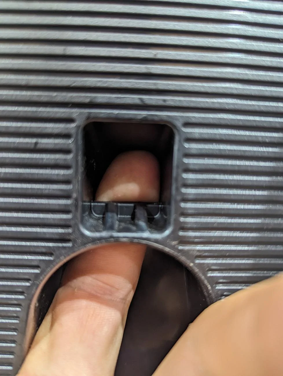

This is the slot you jammed the handle on, it is a solid plastic lip, it could be cut and not hurt the weather integrity.
Ford F-150 Lightning Plug Will NOT Disengage From FCSP FIXED POST 87 20240710_110726
If you didn't know the white cover is easly pulled off, on each side are thesen cut outs for you to pull from
Ford F-150 Lightning Plug Will NOT Disengage From FCSP FIXED POST 87 20240710_110756
Once it is off you have access to the screws to open the charger up.
I'd turn off the breaker, remove the cover and try twisting the handle to get some space for the clip to disengage. If that doesn't work, see if you can get a long thin flat screw driver between the latch on the handle and the plastic tab it engages and push the latch up. Finally you could drill a hole.from the inside at the tab location that would break it free, you would need to glue it back or at least cover the hole to keep water out.
Seems very silly to be put out this much because the handle is jammed in and the charger is easily functional even if you can clip in the future.

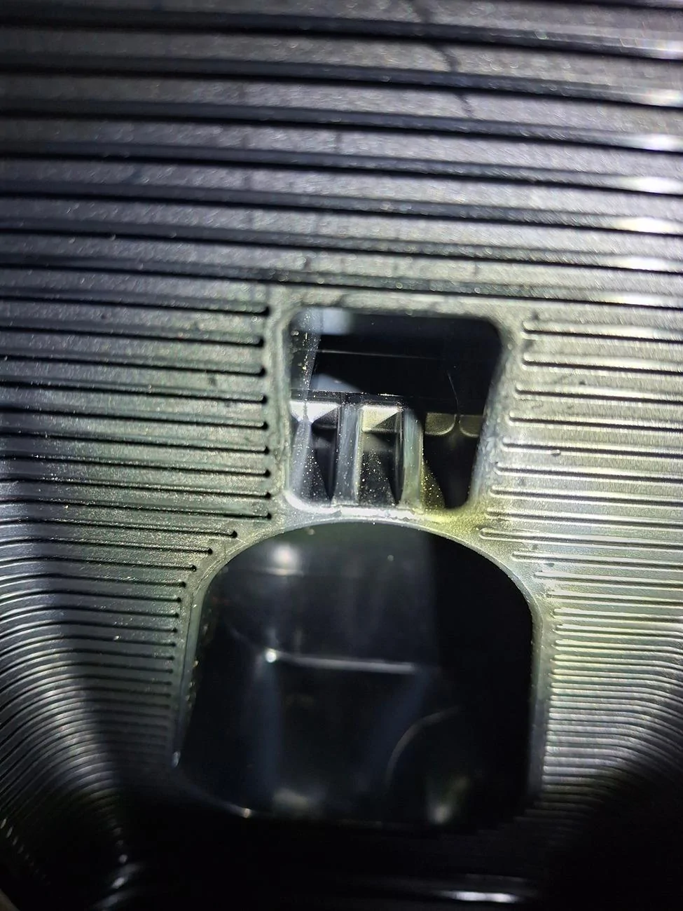

If it were mine, I would first turn off the power to the charger. Then, I would try pushing gently straight down on the top of the plug where the red arrow is in the attached photo. Gently pushing down with a large blade screwdriver in the gap between the top of the plug and the latch may also help. It looks to me like the front of the plug pushed up and wedged against the face of the charger and has the lug on the tip of the latch pulled tight against the latch seat. The idea is to push back down on the plug in the reverse direction of what may have caused the jam. I would not overdo the push. I would apply just a little pressure down to determine if the plug would move down and release the pressure on the latch.
Ford F-150 Lightning Plug Will NOT Disengage From FCSP FIXED POST 87 Handl
rdr854
Oct 19, 2021
1,330
921
Northern Virginia
Thank you. I had tried something similar to no avail, but will give your suggestion a try.

It looks like you want to insert a trim tool or lockpicking tool in from the side and below the latch (beside the plug) to press UP on the latch so it disengages with the cover. There's open space between the holster and the latch.
