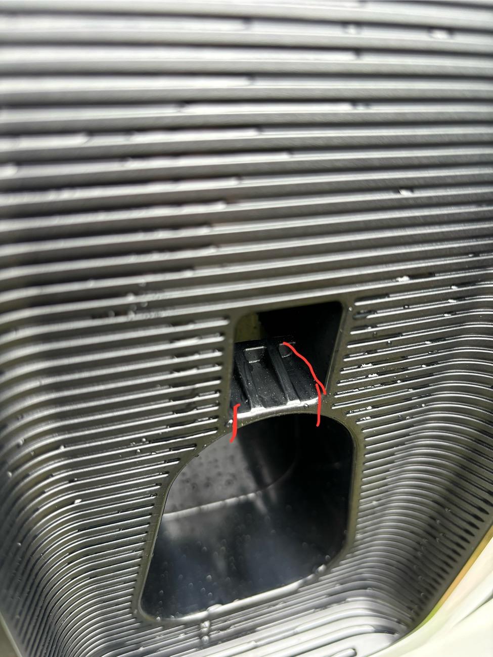

So, now that I can the pictures, I understand the problem. That’s quite a strange thing to happen.
i looked at mine and there is some gap on either side of the locking tab. You may be able to slip a jigsaw blade in on either side and saw out the tab. Then you can either epoxy it back in or buy a wall holster off Amazon.

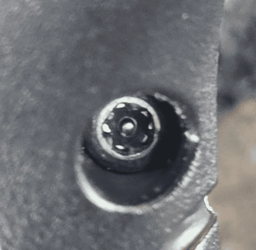

I think the safest non-destructive solution is removing all the fasteners on the plug, be careful as it comes apart so you don't misplace any springs, pins or damage anything inside (micro-switch) if one is present.
Hopefully the locking lever will separate from the handle allowing you to unhook from the current bind and then reassemble.
You're going to need a tamper resistant 5 point torx bit in the range of t10- t15 that has a long reach, conventional bits mount on a 1/4 driver might not reach, you would need a screw driver length version to reach in to the depth these fasteners are seated.
