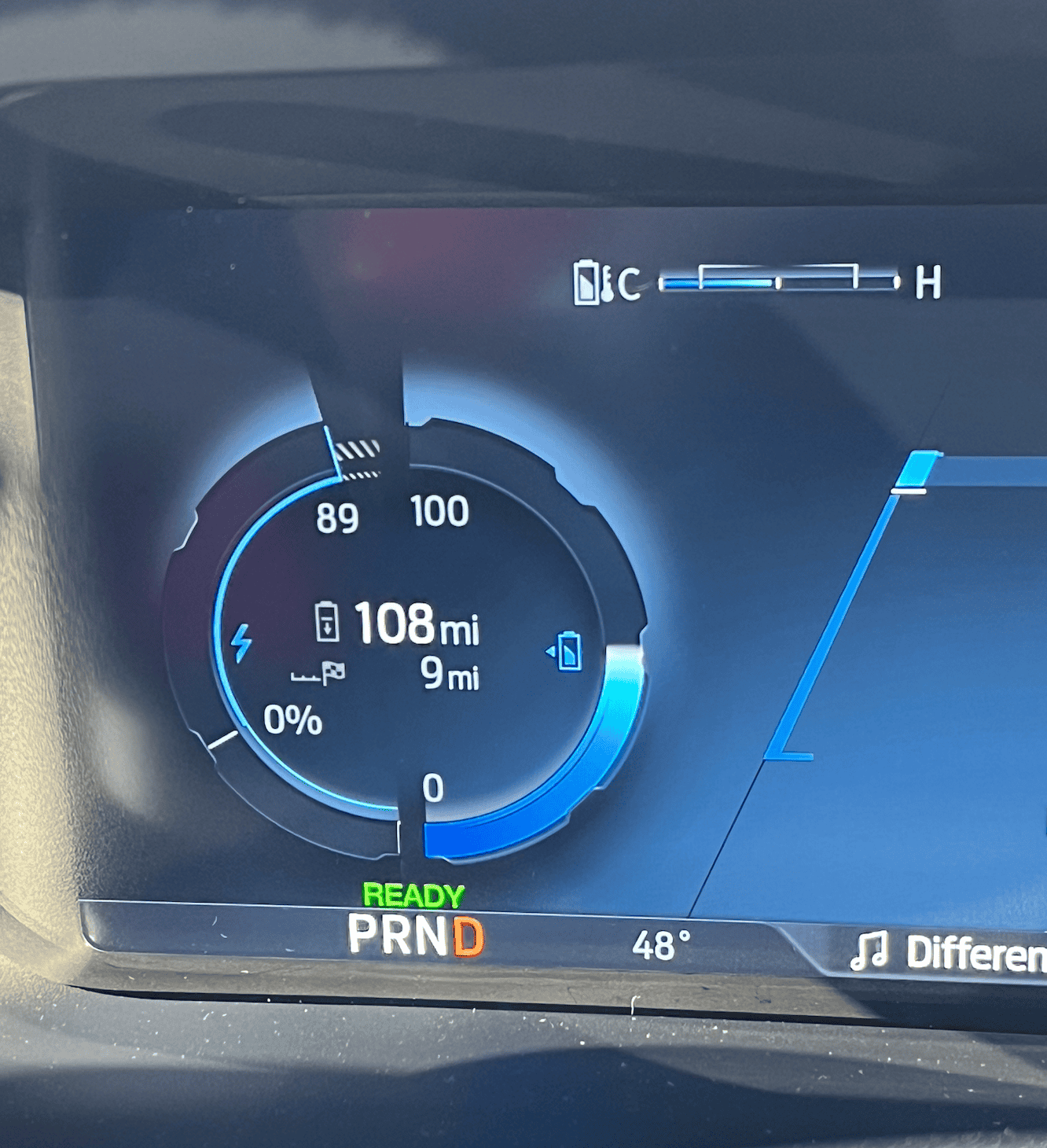

I've seen some folks posting about malfunction / reduced power to the point where it has limited driving and repairs were needed. Temp dropped to 22 degrees last night, wasn't plugged in and was 48 degrees late morning when I drove it. Today, my power gauge was reduced to 89, no malfunction warning and truck had no noticeable loss of power. Is this normal? @Ford Motor Company

Yes, normal. When the battery is too cold or too hot, it will reduce the max power available.

Confirmed normal. I posted earlier about this and it's what I see too. The cold will do it.

So does this pic confirm that the battery temp and motor temp gauges at the top are in fact dumb gauges? I have also noticed the reduce power on a cold morning. But no matter if its 20F with reduced power or 100F in the middle of the summer(took delivery in July), the temp gauge for the battery remains exactly in the middle.

They are not dummy gauges. They should be considered logarithmic a large swing in temp is a small shift in gauge. I have measured battery temps in the low 20’s so far. Power seems to start reducing at 30degree batt temp. Battery loses about 10 degrees per hour depending on outside temp measured mine at 5 degrees OAT. Precondition appears to be trying to heat battery to 55-60degrees. Precondition uses a lot of power 20-30kwh thus why it asks if you want to do it if vehicle is unplugged.
