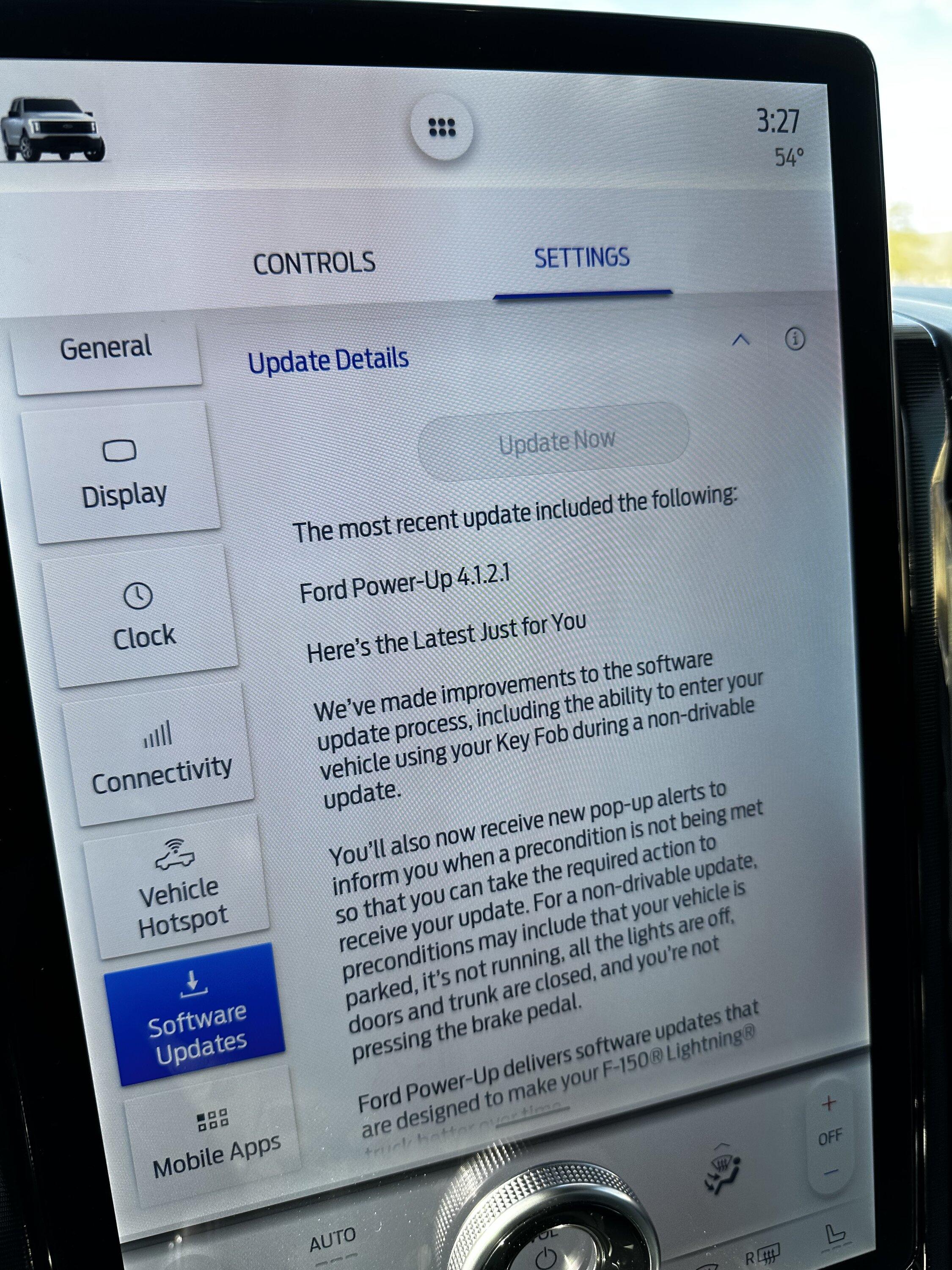

Something is not right here. I got “4.1.2.1” on Feb 17 with the exact same text? 🤔
I have the same text and it never goes away. I recently got an email from Ford saying an update is coming, but so far no update.

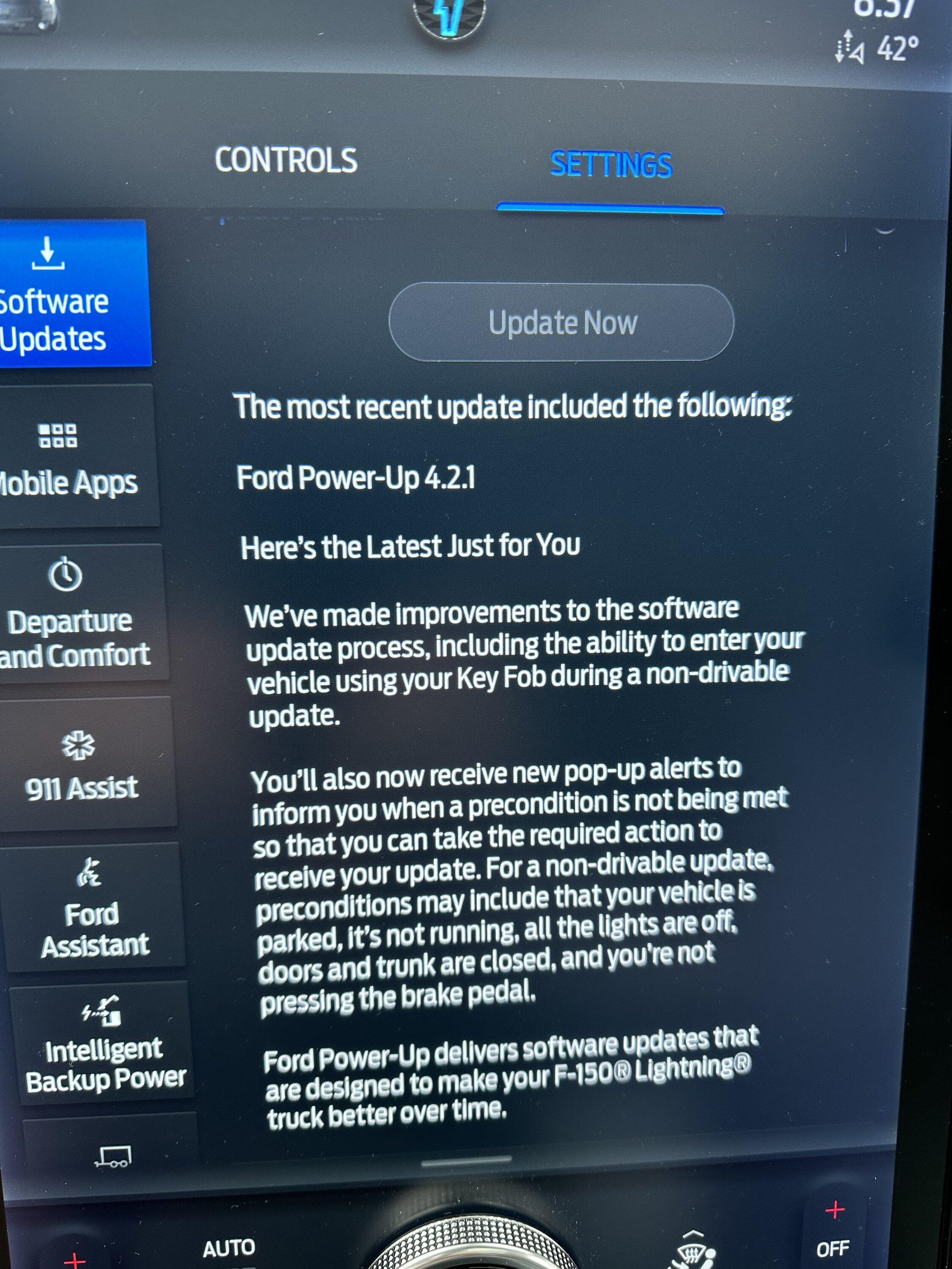

Mine just updated from 4.1.1 straight to 4.2.1 without ever getting the 4.12 and 4.13 enhancements to the UI. My dial still only adjusts the radio and I don’t have any streaming icons under entertainment

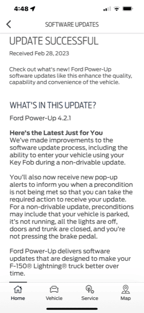

Mine updated this morning.
Didn't know until I checked the Ford Pass app.
