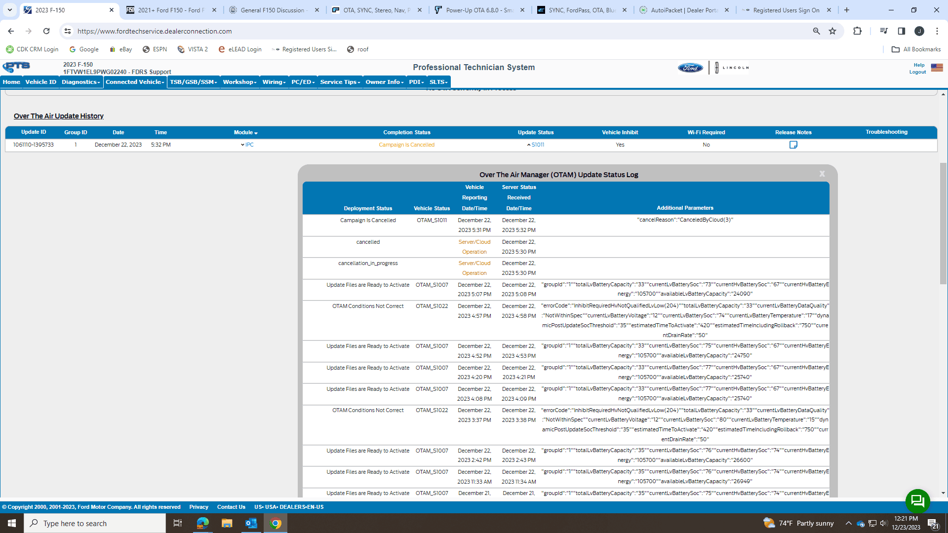

Post or PM me your VIN and I can check the status of the OTA in PTS.
Mine did the same. Downloaded on Thursday, failed twice Thursday and twice Friday and now says it will try again with the next update (pictures above). My VIN is 1FTVW1EL9PWG02240 if you can check it too.
The update was canceled and recalled by Ford. This is not a bad thing. That I know of, three Mach E's, two F150's and one Bronco have been bricked by a recent OTA. I have not able to obtain the VIN for any of these cars nor do I know which update caused the problem, but maybe this is why the update was canceled by the cloud. I just did this update to my truck this morning with FDRS with no issues. In your case, it was failing due to low SoC/capacity, but at this point, the OTA trigger is no longer active. You would have to wait for it to be resent to you.

I have checked a few cars today and this update seems to be being pulled off of the shelf. Several vehicles show the update as "canceled by the server" in PTS which means Ford is pulling it. Something must be wrong with it.

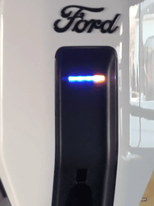

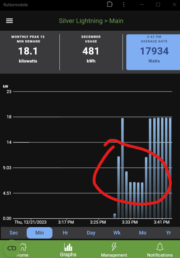

My charge rate is working as it was previously, the FCSP is dialed at 80 amps on the hardware and the Fordpass is also dialed in for 80 amps, effective output 76 amps.
Thursday afternoon I tried to prolong the "charge session" by dialing down the rate, the Fordpass control allows us to dial down the rate to lower AMPS, but it has been malfunctioning for the most recent versions of Ford pass, I could get it to slow down for about 5 minutes, then the truck started calling for the full rate even though the app said it was dialed for a lesser rate.
The yellow indicator on the right of the FCSP status bar indicated reduce charging requested when I dialed it down, Emporia Vue2 graph confirms the reduced flow, but shortly after [ 5 minutes] it jumped back up to full rate. IMHO this is a problem with Ford Pass not the EVSE/FCSP.
