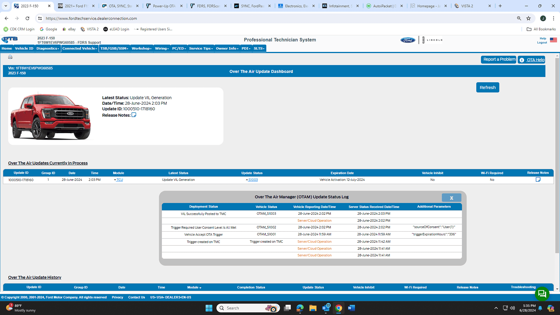

Yea OTA 6.4.0 is in your queue right now. It is not downloading the files for some reason. Not the first time I see this, but there is nothing you can do to help the process.
Was hoping this would download at 1AM but didn’t. I am wondering if you know or recall anyone mentioning this issue just resolve itself or need dealers to fix it?
It will either download the files and install before the OTA trigger expires, or it won't and it will fail and you'll have to wait for it to be resent. Dealers can apply the update manually, but they are usually not helpful with these types of things.
Do you happen to know how long before it expire? Sorry for all the question.
No worries. That info is in the screenshot I posted, but I don't expect you to be able to decipher everything there. The OTA trigger was accepted by your car at 11:59am on 6/28 and is good for 336 hours (2 weeks). So it will expire at that time on 7/12.
