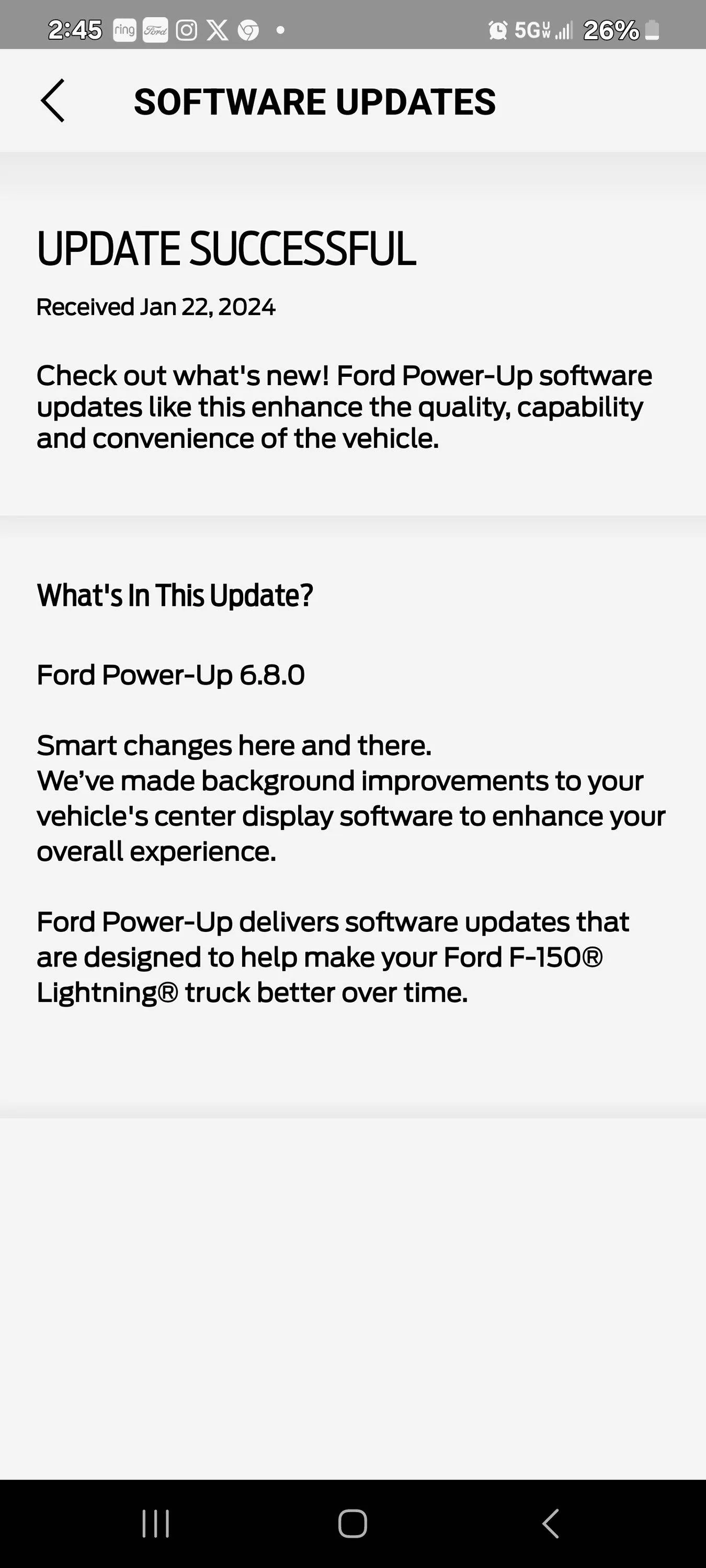

Done .. guess I'm ready for the next update now.
Ford F-150 Lightning Power-Up OTA 6.8.0 - Smart Changes: Center Screen 1000001039

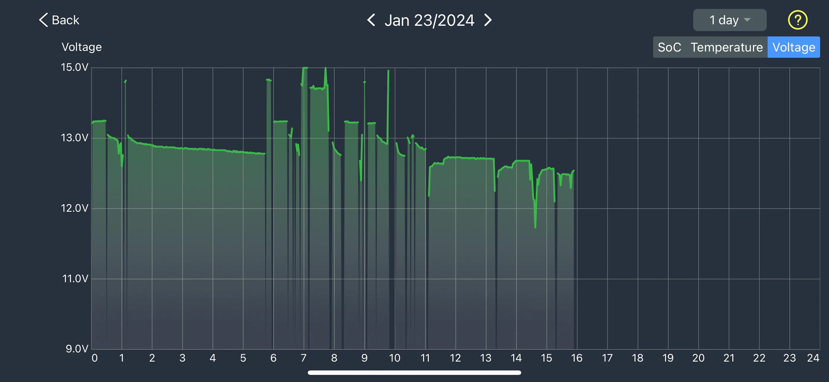

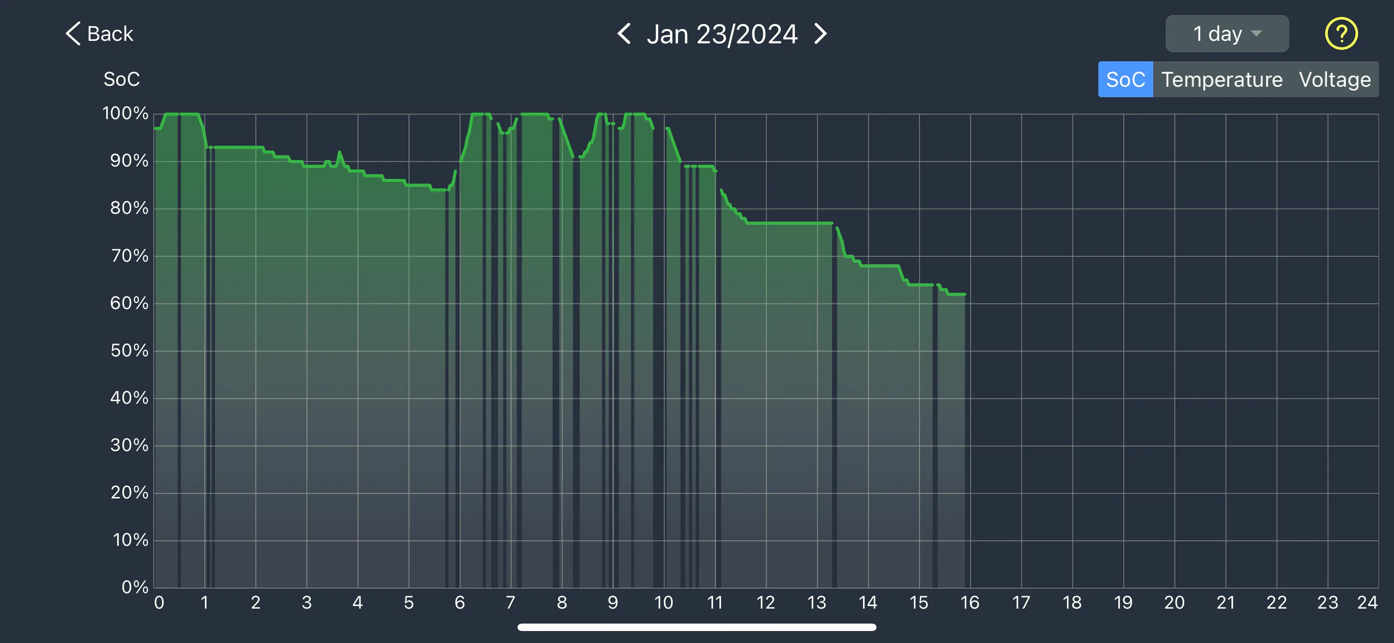

Thanks a million @rugedraw Interesting, I had a 10 amp charger on the 12v since first thing this morning. It turned off at 11am. My SOC and voltage was higher at 11am than at 2:30pm based on my independent battery monitor.
Ford F-150 Lightning Power-Up OTA 6.8.0 - Smart Changes: Center Screen 2024-01-23-15.55.13.412
Ford F-150 Lightning Power-Up OTA 6.8.0 - Smart Changes: Center Screen 2024-01-23-15.55.56.028
Hoping the CSP for the BMS shunt will fix that. :)
