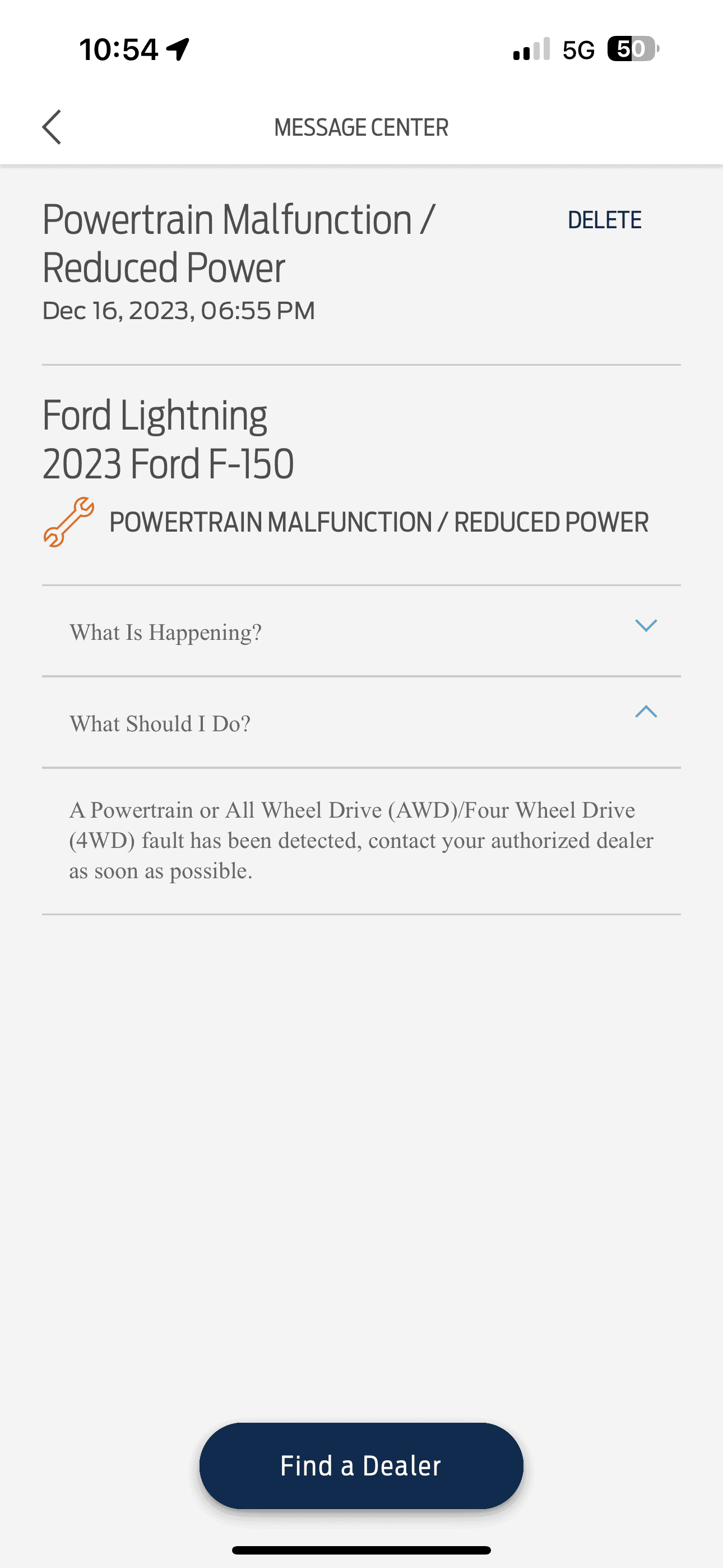

I need some guidance with my Lightning. I have a 2023 Lariat SR and I’ve only put 2800 miles on it so far. Recently, it showed a powertrain issue while backing up, losing its one-pedal drive function which caused the regenerative brakes to fail almost causing me to roll into the car behind me. I stopped using the manual brakes just in time before I hit the car behind me, and after restarting a few times, the dashboard warning disappeared and one-pedal drive came back. But hours later, while charging, my Ford app flagged the same powertrain issue that had popped up on my trucks dash, despite no dashboard alerts at this time. The truck seems to run normally, but this inconsistency is confusing. Has anyone experienced something similar? Is this just a minor bug or a bigger problem? Online, I've found varied experiences, from software updates to needing new batteries. Would love to hear your thoughts.

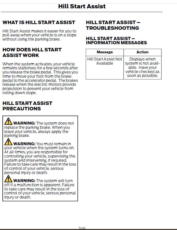

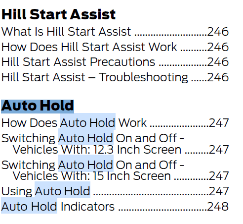

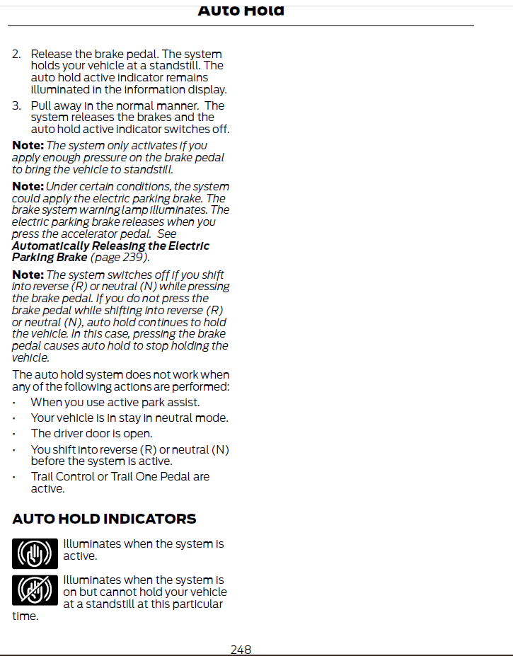

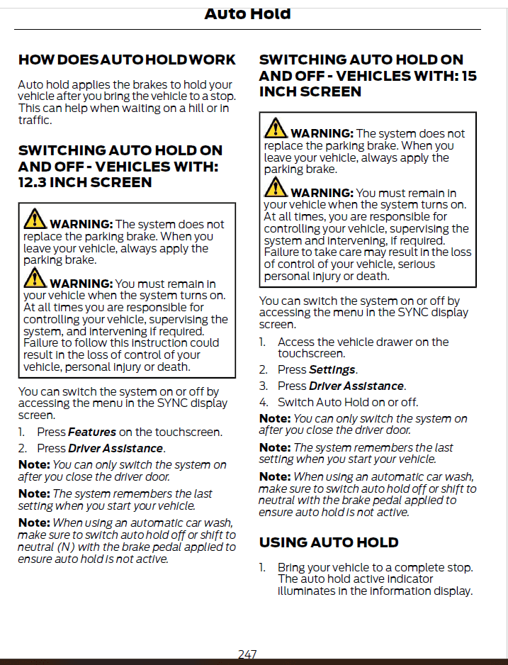

Doesn't explain why it suddenly stopped working in your situation.
Things to look into as far as settings on your truck and drivers profile:
Ford F-150 Lightning Powertrain Malfunction/ Reduced Power 2800 Miles | 2023 Lightning Lariat SR 1702916887668
Ford F-150 Lightning Powertrain Malfunction/ Reduced Power 2800 Miles | 2023 Lightning Lariat SR 1702916977587
Ford F-150 Lightning Powertrain Malfunction/ Reduced Power 2800 Miles | 2023 Lightning Lariat SR 1702916903951
Ford F-150 Lightning Powertrain Malfunction/ Reduced Power 2800 Miles | 2023 Lightning Lariat SR 1702917144099

The Ford App notice was likely related to the first occurrence. It is notoriously slow to present alerts and stays updates.
If everything is back normal now, no new messages, no reduced power, no additional notices while charging and no red ring if death on the charge port, I’ld keep on keeping on.
In the meantime I’ld schedule a visit to the dealer to run the codes and see if shows anything from the first occurrence.

Got it, that explains the delay in getting the message 3 hours after the incident. Thanks for your help! I'll schedule an appointment to have the codes checked and in the meantime, I'll keep on trucking. Really appreciate it! 😊
