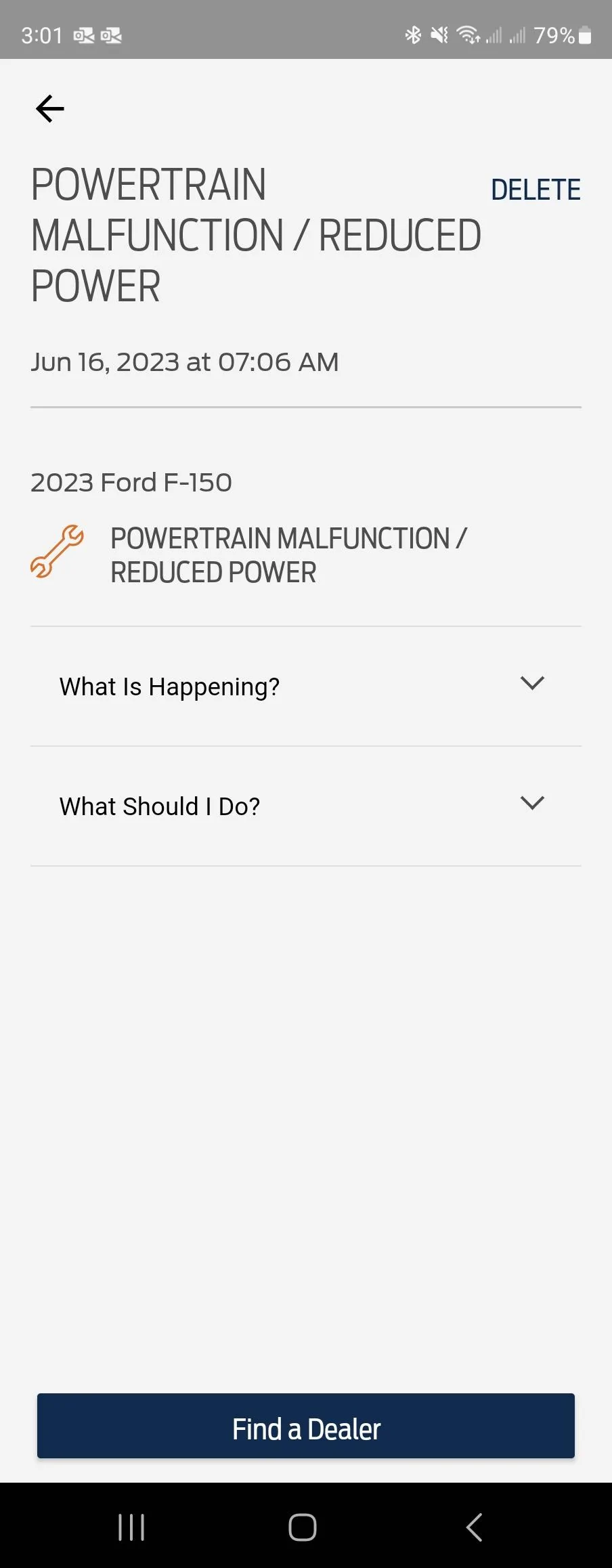

Hmm i have the same thing on June 16th but it went away. Only had 200 miles on the truck. Should I be concern or should I contact the dealer. Brought the truck May 25th, 2023. 2023 Pro. Dealer recieved the truck May 10th, 2023.
High probability of bad cell in a module of the battery pack. Let Ford BEV setup the repair. When was the truck manufactured? See my spreadsheet of tracking battery associated repairs needed.
