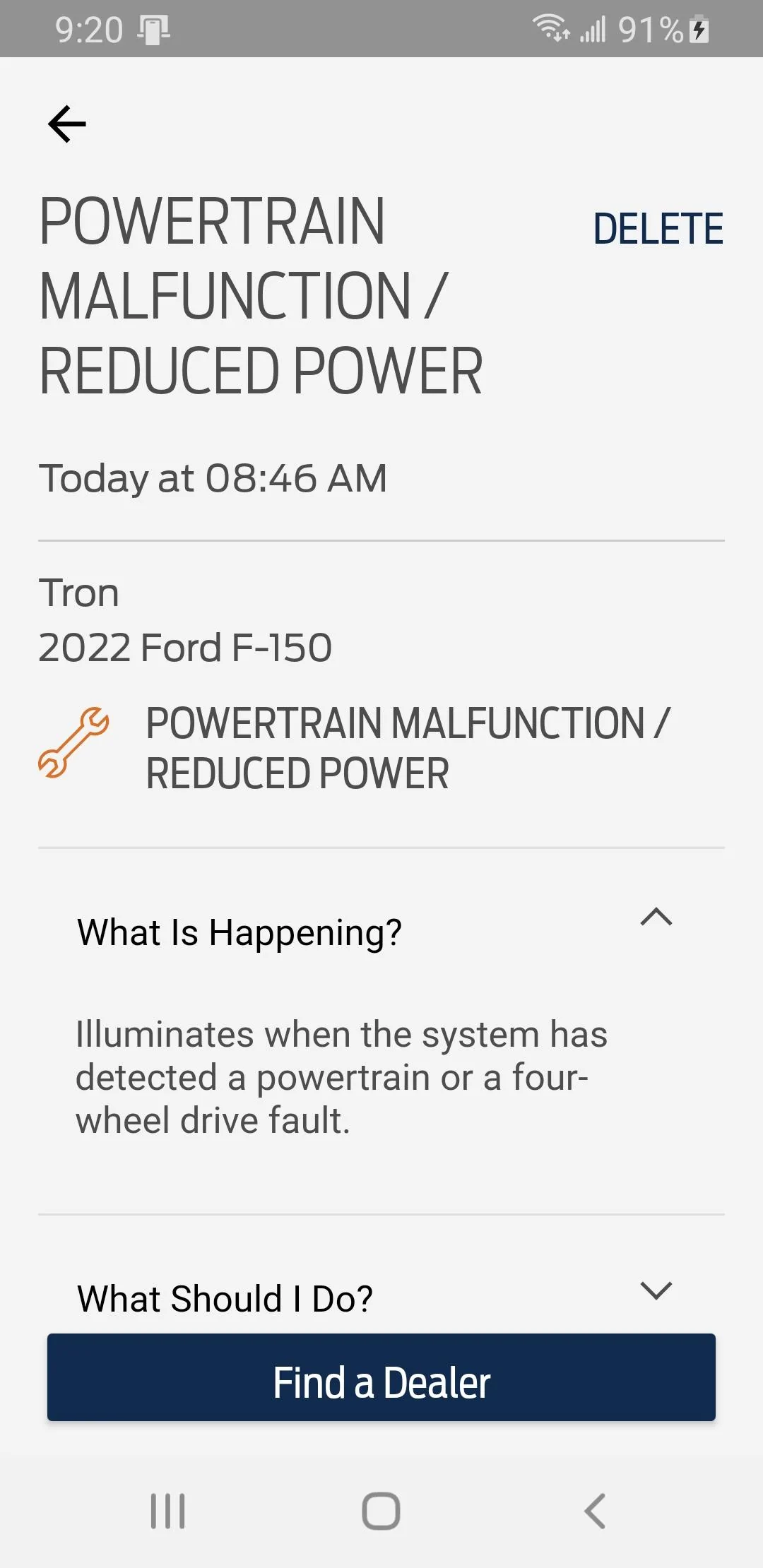

I guess add me to the list. I will be checking my 12V. It was after leaving the store. Light is off now.
Ford F-150 Lightning Powertrain Malfunction/ Reduced Power Screenshot_20230421-092013_FordPass
