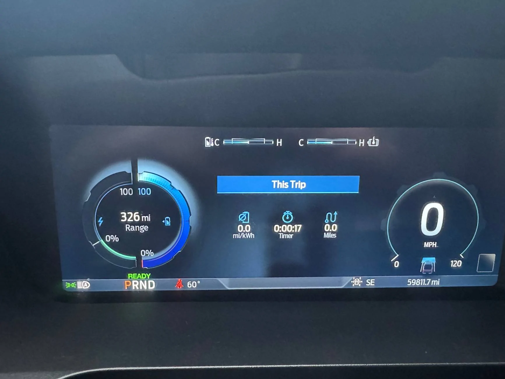

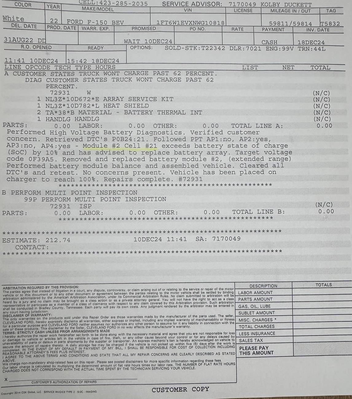

Update got my truck back today. Only took a week from drop off to pick up I’m impressed! They replaced module 2. Interesting it said module 2 cell 21 exceeded 10% SOC. They charged it to 100% to test.
