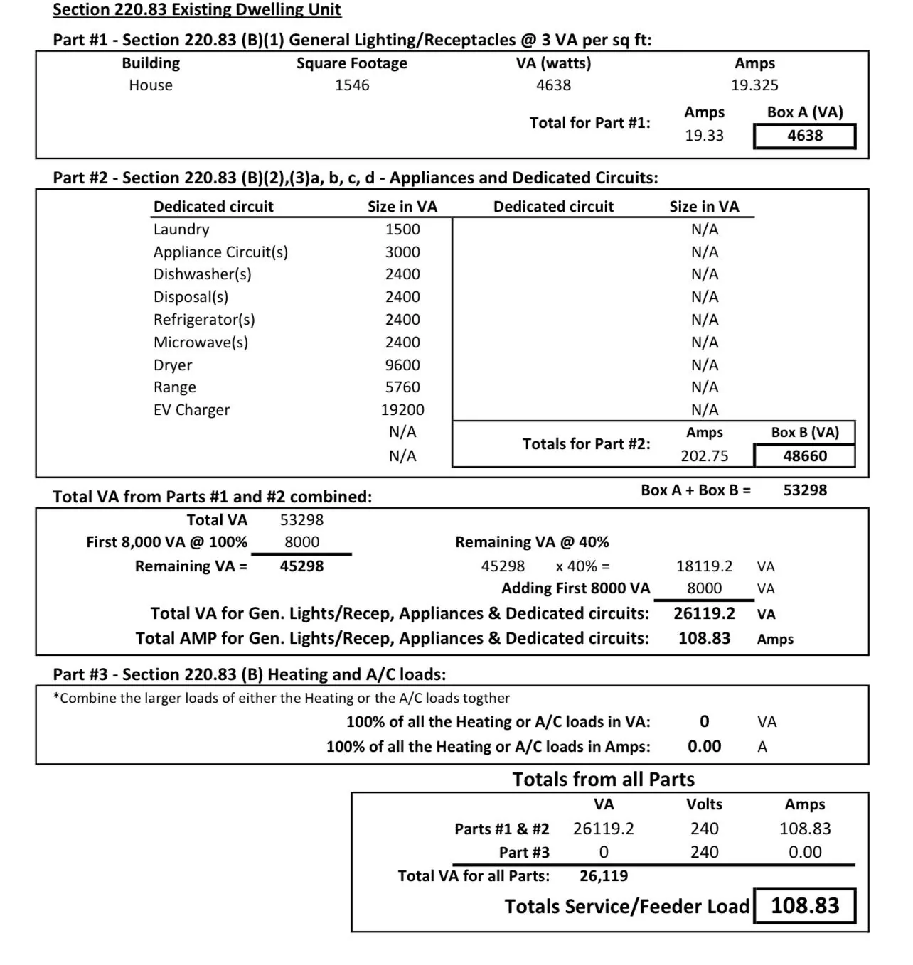

The VA ratings they used for appliances is way too big. A typical dryer would be 5000VA, a disposal and dishwasher 1200 each. The refrigerator isn’t normally specified separately. It looks like they simply took the breaker sizes and used that as the load. What a mess.
Yeah, I wish I could speak with the engineer directly. I want to understand his reasoning.

The math checks out if you shut off the house breaker while you charge the truck.
This is the load calc they did
Does this panel not provide HVAC? Because it looks like that calculated 108.83 amp load excludes HVAC.
Right? Who needs the light on at night? Lol
I have central heating only and a portable AC unit.
Hard to do actual calculation, as one pictured above says you have multiple of some appliances but doesn’t say how many. Even saying that, the values look suspicious Dryer should be 5000 unless gas?
