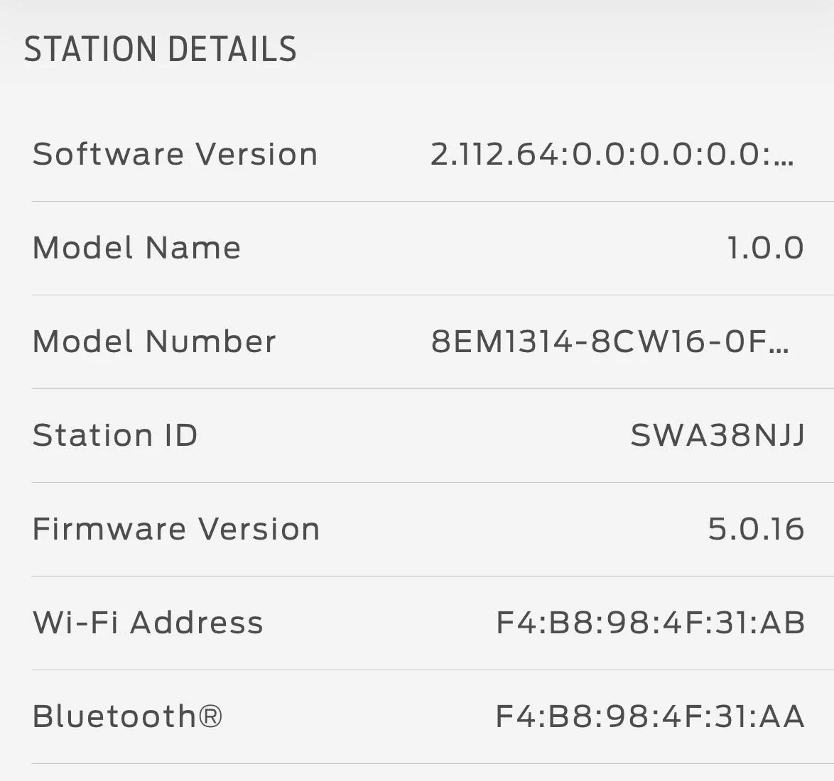

finally got my Charge Station Pro installed by an educated electrician yesterday. During my 1st charge at 80A, the cable got hot and the charger faulted. Called my guy back out this am. The did a total re-assessment, read the Ford literature and even called Ford. Had to cut my A down to 60 (64?). Now trying again.
13,565
14,576
What's your software version on the FCSP?
13,565
14,576
here it is. I’m hoping will update soon?
Leave your truck unplugged this evening.
Sunday morning switch off the circuit breaker for 30 seconds.
Switch it back on, wait 15 to 30 minutes to allow it to reconnect to the Ford cloud ☁
Recheck the version level, hopefully it will show the current release

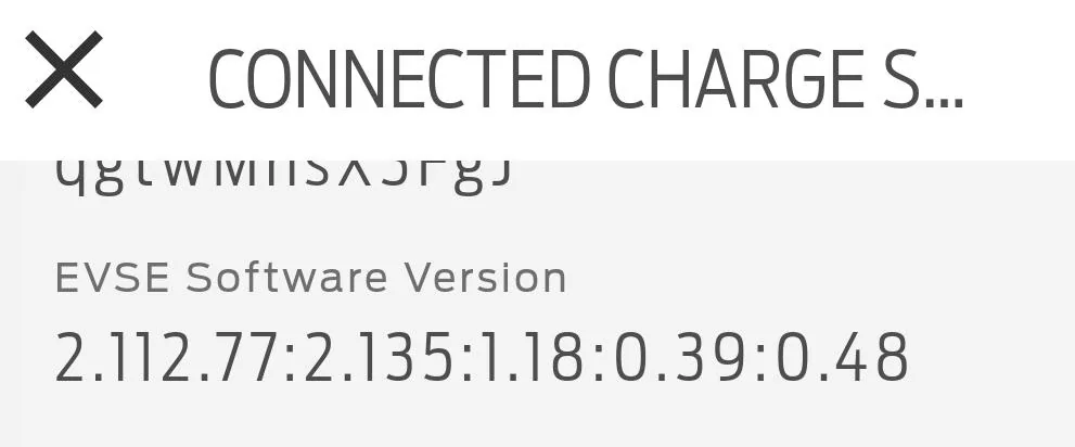

your post seems to state the problem. Almost all of us who installed in warm weather had high temp charger fault. The CSP shipped with .64 firmware after a couple of days of being connected to internet firmware updates. It adjusted the overheating internal tolerances.
well documented here in this forum.
cuurent firmware is xxx.77xxxx
enjoy n

Do you think I'll be able to adjust back to 80A after the update?
