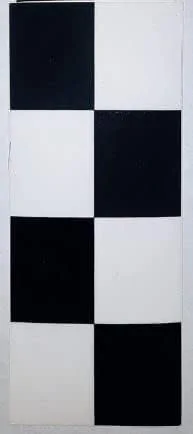

Inside the pamphlet are three stickers that look like this:
Ford F-150 Lightning Pro Trailer Backup Assist sticker
They are just vinyl stickers, like bumper stickers. You place one on your trailer in a location specified in the pamphlet, and then you learn how the system works. You put the other stickers on other trailers you own. When you hook up a particular trailer, you tell the Ford software which trailer you've hooked up. You don't have to move stickers. Presumably you can buy more stickers from Ford.
The pamphlet states that if you cannot locate the sticker on your trailer in the designated position for some reason, you have to buy a "sensor" from Ford. Apparently this "sensor" is more forgiving as to its exact location on the trailer than the sticker is.

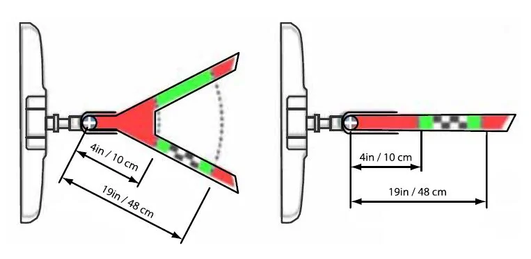

Here is a graphic depicting sticker installation:
Ford F-150 Lightning Pro Trailer Backup Assist sticker installation diagram

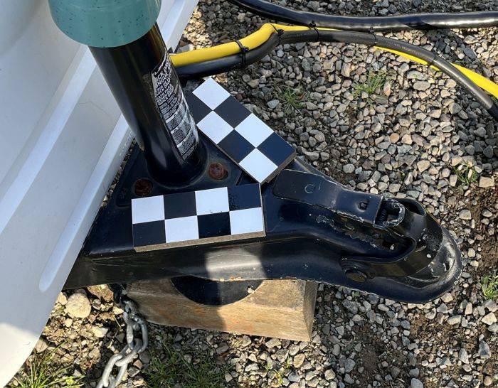

And here are two stickers installed on my trailer tongue. (I haven't tested with the Ford software to see if these work...)
