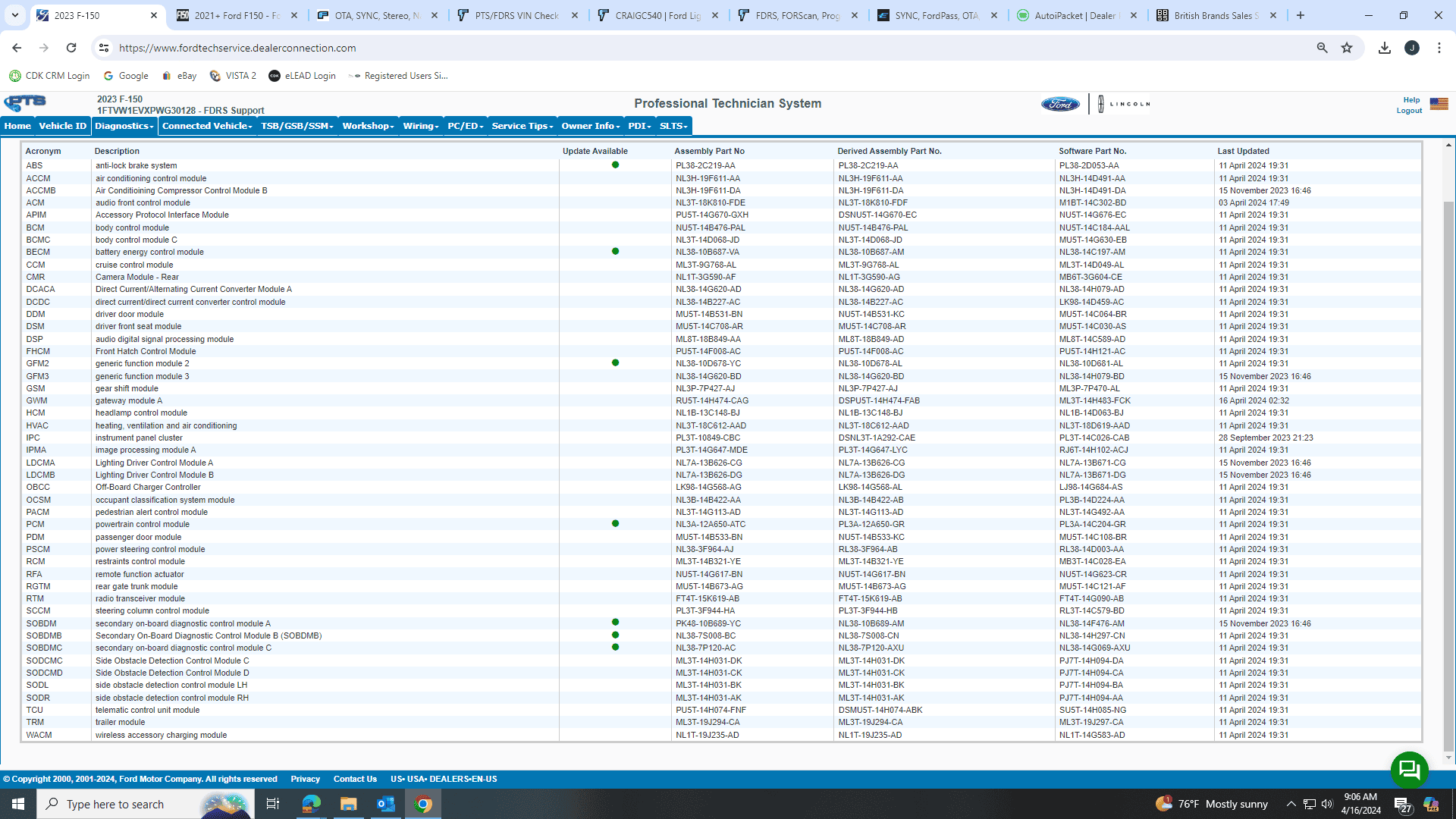

Did you do the GWM I see on 4/11? You are still showing some modules pending updates and you are not on the latest Sync version. If you do not have the SoC on your IPC, it is because you were most likely not showing all the updates you needed at the time you were doing the updates. This is due to a issue affecting many vehicles where the next updated needed to progress through the process was now showing for you on the server. Do you still have the Mongoose?

Correct. That and/or the PU-CMR-FX is for the CMR and only BC equipped vehicles have BC. I do not see any mention of BC on your window sticker.

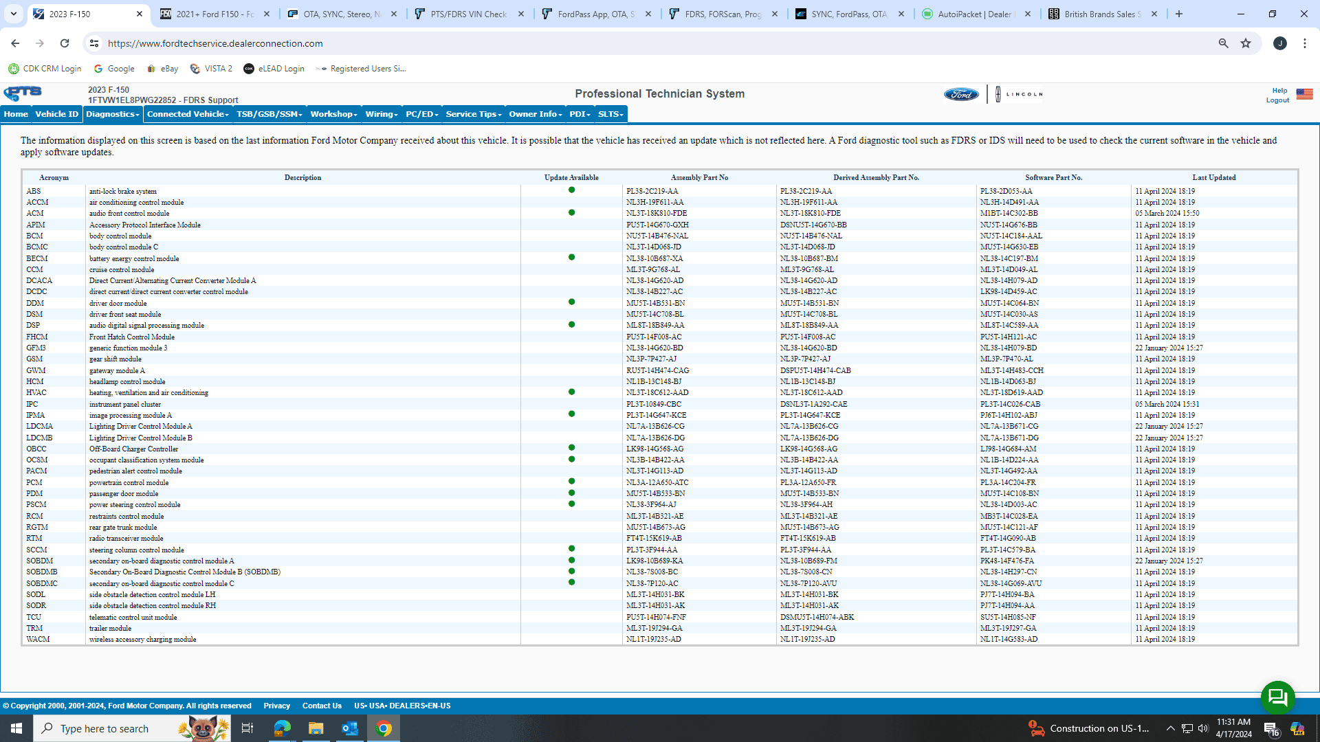

All they did was update the OBCC. Nothing else. Modules needing updates are below. Need more details on the "minor issues", but your truck is reporting an ethernet failure code between the GWM and APIM. Those ethernet codes are automatic red flags to me when something isn't right.

You've gotten all the Power Up updates through 6.13.0/CMR-FX. You're missing a few of the PU updates. Overall your truck is in a good place in terms of updates.

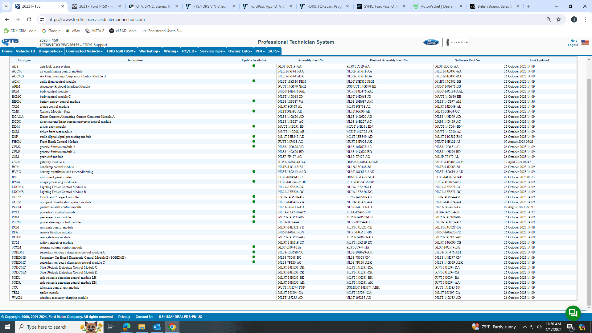

Morning all. I was hoping someone could pull the FDRS info for my newly purchased 2023 F150 Lightning. I already have the mongoose plug and a battery maintainer/charger on the way. My vin is: 1FT6W1EVXPWG28125
This is what PTS is showing. Remind me after 7pm eastern today when I'm home and I'll pull the list from FDRS for you.
Thanks for the help with this. The issues I am having is the parking sensor blocked error and the drive mode is greyed out and unable to be selected. The adaptive cruise control is wonky which I am contributing to the sensor issue. Sure do appreciate your service to the community on this! Much appreciated.
