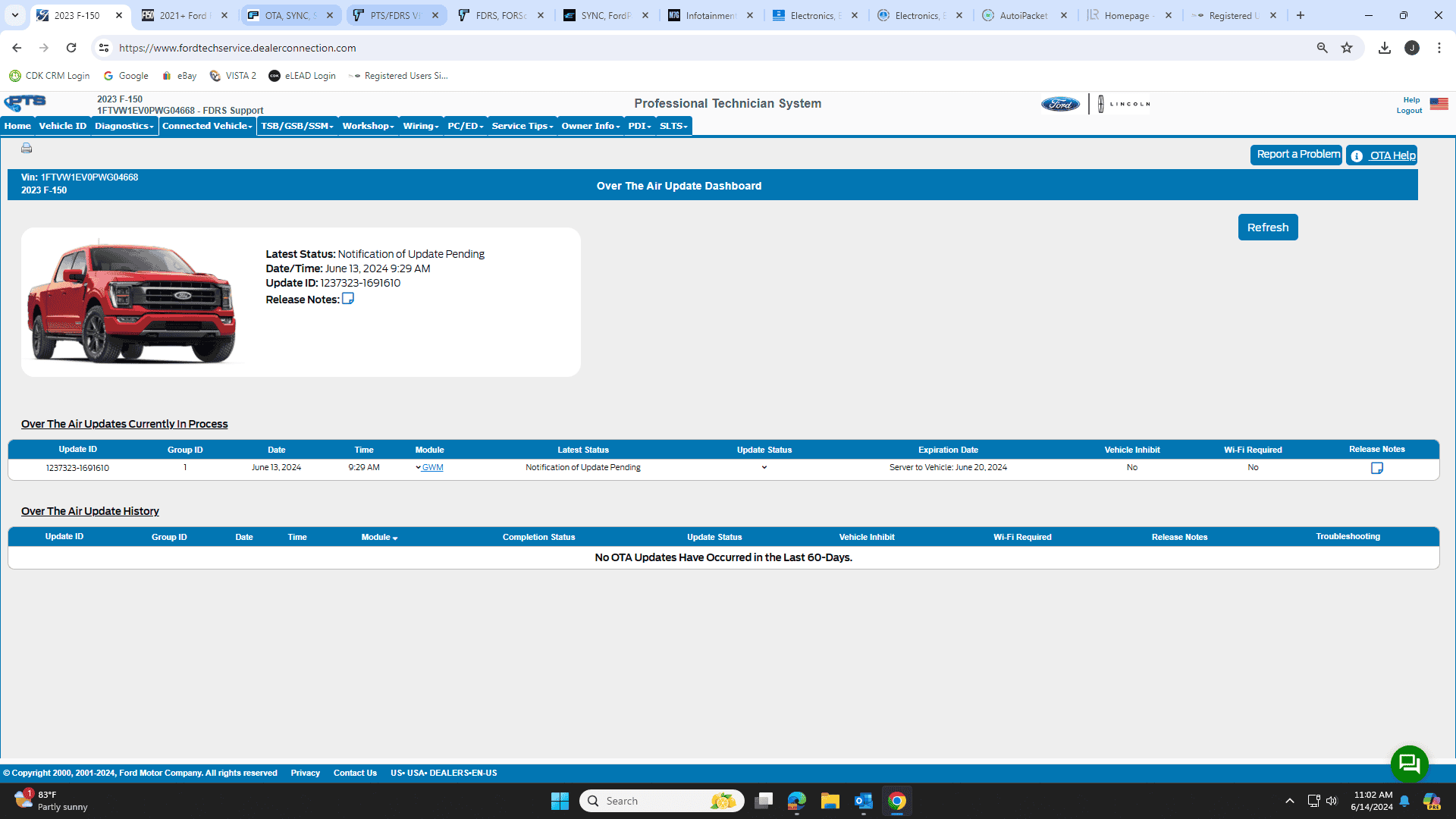

Haven’t driven in months.
1FTVW1EV0PWG04668
You have the new GWM update sitting in your queue from earlier this morning. Go to the truck, start it and manually check for updates. Leave the truck running for 10 minutes or so and that should be enough for it to install.
Ford F-150 Lightning PTS/FDRS VIN Check Thread 1718377392653-i3

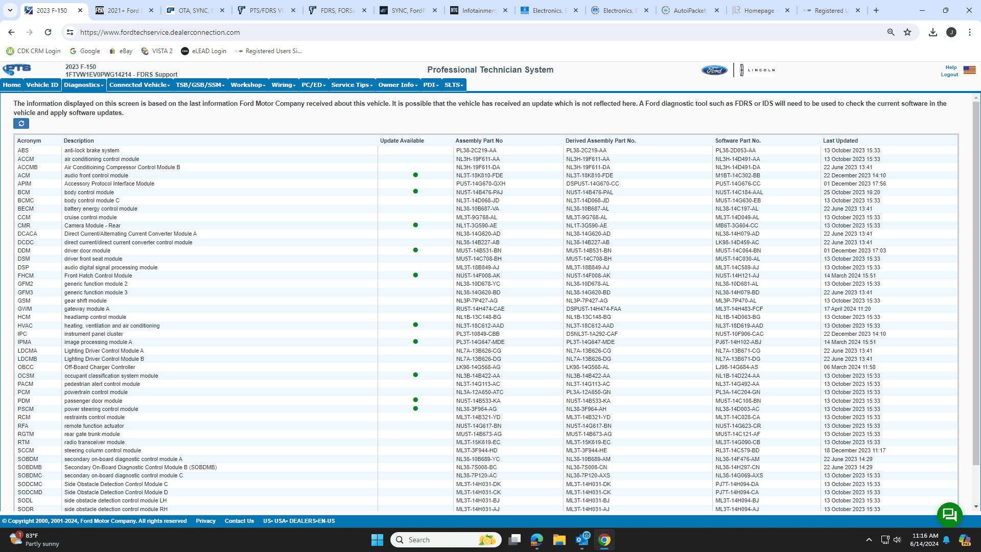

Hi! Could you please check my VIN 1FTVW1EV0PWG14214
I haven't seen an update in a very long time, but recently got the low-voltage battery sensor (CSP-23B70) work done -- and still no updates. So I thought it would be worth checking out.
Thanks!
rugedraw
rugedraw
Javier
Dec 14, 2021
1,783
2,149
Miami
Auto Sales
Thanks!
Your truck is on the latest Sync version and the modem seems to be working just fine. You do not show a lot of pending updates. I think you may only be missing the 6.13/CMR-FX OTA as far as the power up updates go; maybe the 6.8.0 IPC update, too.....I can't tell as I don't know the software version by memory. All the other pending updates are minor PU updates and the IPMA/PSCM updates you see here are not available OTA. I don't anything to be worried about here, tbh.

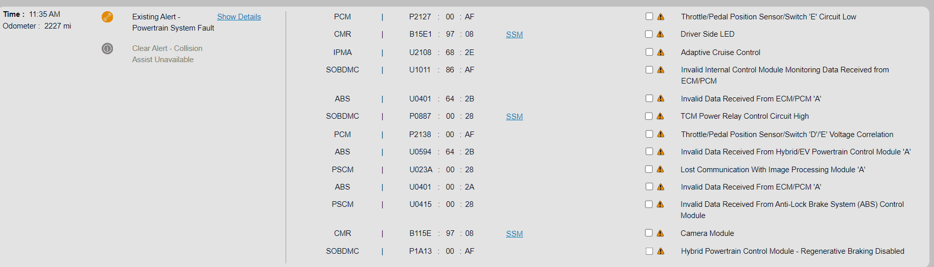

Could you please check VIN 1FTVW1EV9PWG17869. Thank you
rugedraw
rugedraw
Javier
Dec 14, 2021
1,783
2,149
Miami
Auto Sales
I assume you're asking about the powertrain fault message you just got? Attached is the SSM associated with the SOBDMC code is reported. Your car does not qualify for the SSM referenced the CMR code; that can be ignored.
Ford F-150 Lightning PTS/FDRS VIN Check Thread 1718463249107-jb
As far as software goes, the truck is on the latest Sync version and shows recent OTA history. You had the OBCC update for the Tesla chargers fail due to vehicle inactivity.....seems like it was parked for a few weeks in April and the truck was not turned on while the OTA trigger was active to allow it to install.

Thanks so much. No idea what all that means yet. Not sure if it is fixable. Seems like a lot.
rugedraw
rugedraw
Javier
Dec 14, 2021
1,783
2,149
Miami
Auto Sales
It's hard to tell remotely. If the powertrain fault was a one time deal, then maybe it was a glitch in the matrix. The SSM is could be cause by a loose connection or ground. If you continue to get the powertrain fault, you will have to have the dealer take a look at it.
As far as the failed update, that is nothing to worry about. They will resend it to you eventually.
