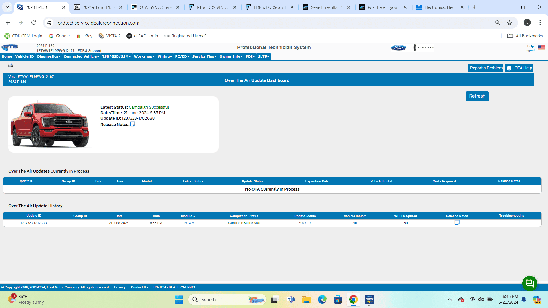

Just got ECG-24.2.4.9 not completed did I do somthing wrong ?
1FTVW1EL9PWG12167
thanks

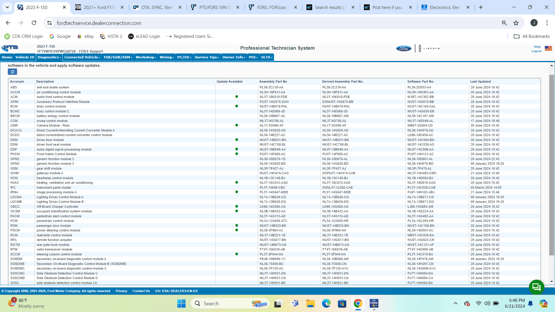

Hi @rugedraw. New to the forum and a new F-150 lightning owner. Picked up a 2023 Lariat ER this weekend. I’d be grateful if you could look my VIN up in FDRS. I had a few errors day 1 of ownership and had to bring it back to the dealer for a day to correct (front parking sensor, no forward anti-collision, no blue cruise) that appear to have all been corrected by a software update. I also received my first power up last night. Thanks for your help!
VIN: 1FTVW1EV9PWG28726

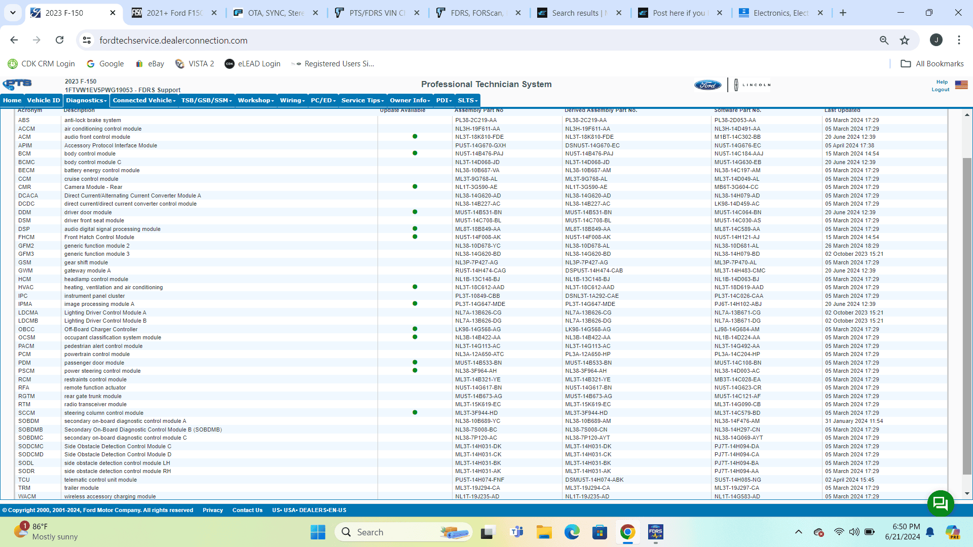

Hello @rugedraw . Thank you so much for providing this service. I don't know how well it will apply to Canadian Lightnings, but could you check.
VIN 1FTVW1EV5PWG19053
1FTVW1EL9PWG12167
thanks
According to PTS, it went through just fine.
OTA history shows you got 4.2.1.1 on 6/20 and 4.2.1.2 today. Modules with pending updates are below. Not shown below are several APIM, GWM TCU and at least one IPC update you would need to be fully updated, too.

OTA history shows a few updates came in in April; same ones as above plus one more for the APIM which was OTA 23-PU0724-DOM-RS. Your list is below and also need updates to the modules I mentioned above.
Ford F-150 Lightning PTS/FDRS VIN Check Thread 1719010278049-du

Thanks still says not complete ? I’ll assume it will disappear at one point.
Reset the APIM. That should get it to clear.

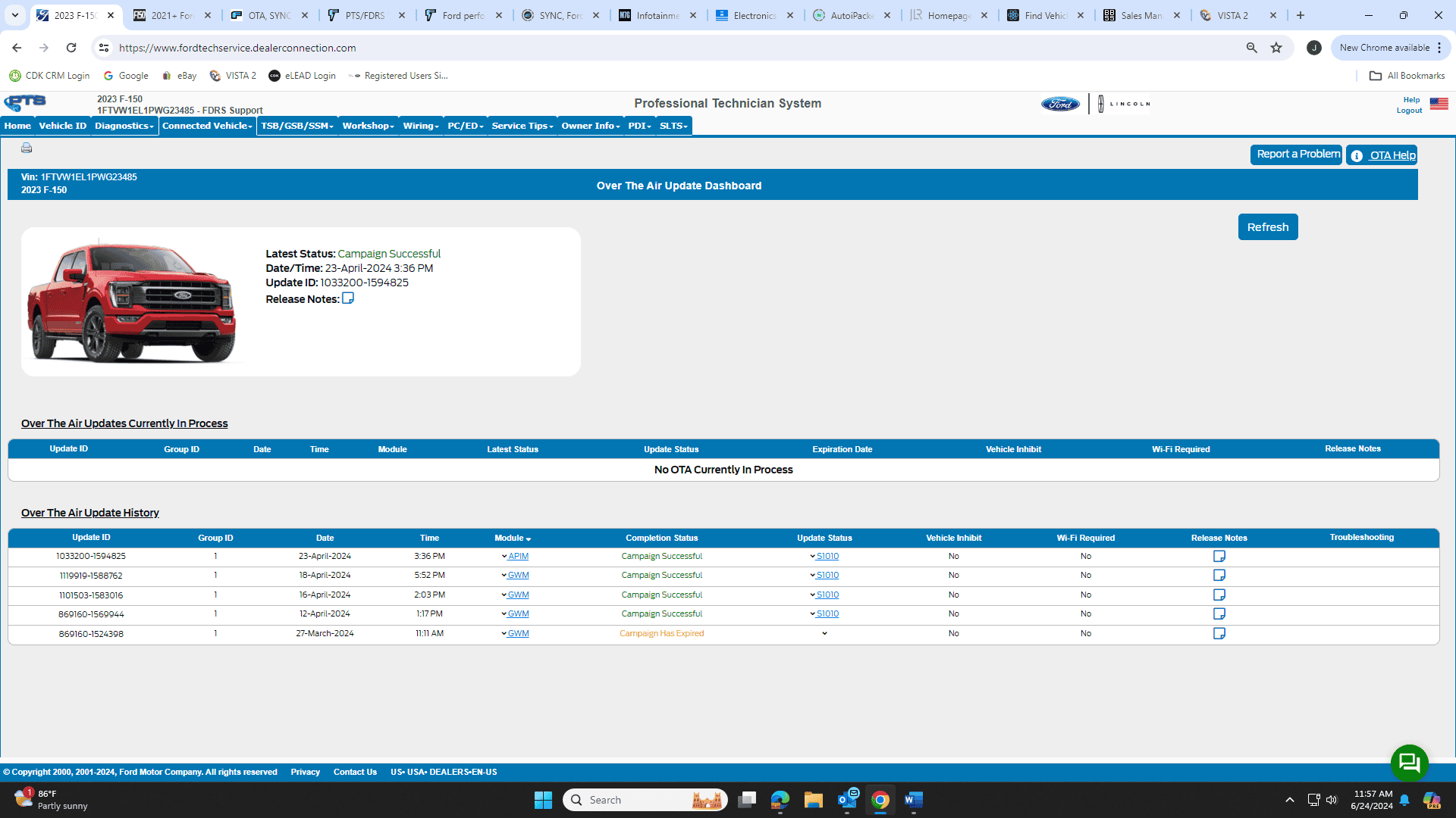

I was on a long road trip and kept getting software update notifications in the in-car display that would say the update was scheduled, but then they'd disappear upon next startup of the truck and didn't seem to apply. VIN is 1FTVW1EL1PWG23485, could you help take a look? TIA
It's a phantom message and you can ignore it. No updates have been sent to you since the end of April.

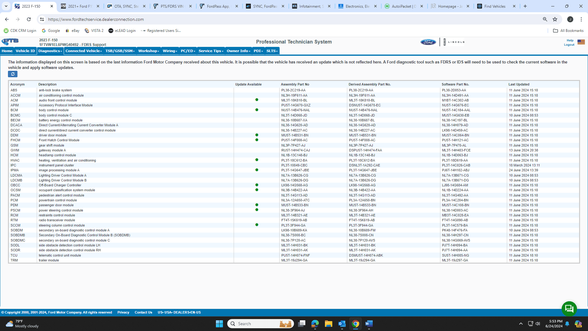

Hello, would you be able to check my vin again. I’ve had a flurry of updates over the past three weeks. Thanks for everything you do!!
I didn't compare it to the previous one, but the list will most likely the same. The updates you have gotten have been for the GWM and TCU and when those modules have a pending update, PTS does not show it. None of the updates you got would have cleared anything from the original list.
