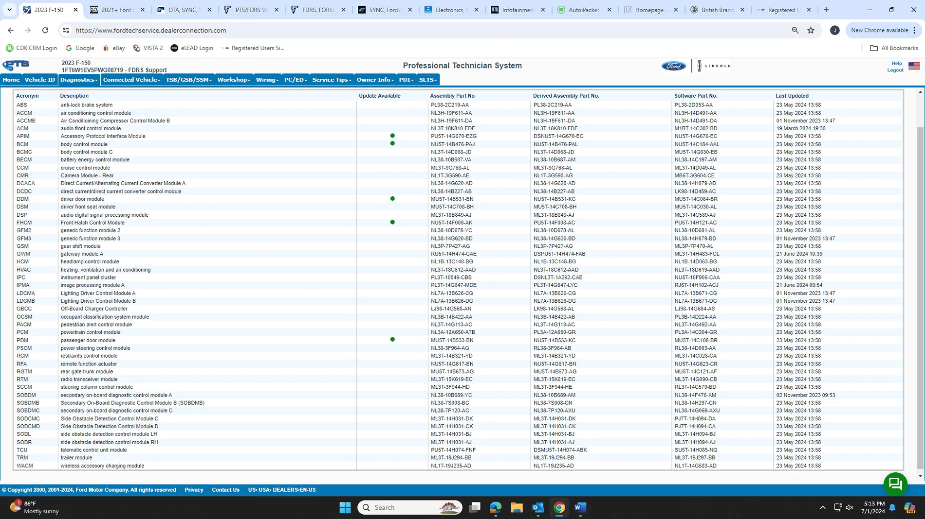

I would appreciate a. Look at my VIN 1FT6W1EV5PWG08719
Took delivery of my 2023 Lightning Lariat ER late April 2023. I had a not completed last month for 6.2 but never saw that complete before the truck successfully completed ECG-24.2.4.9.
I had the dealer apply some updates (where I got the SOC percentage but nothing else I can see) and Ford customer service says I have what I’m supposed to have for Sync but I’m sure I’m missing some Power Ups.
Thanks for taking a look.

Seems like the dealer did do your updates, because you aren't showing much available. There's an APIM update showing for you now, but it is possible that was not there when they updated your truck. This means you will not get many updates others have gotten because they were already done with FDRS.

Thanks very much for the information and screenshot! I notice many rows under ā€œlast updatedā€ were on 23 May 2024. That was the day I first saw the ā€œNot Completed ā€œ message for 6.2 and Priority Update 23-PU11O3-NAT-VCE. Never saw a successful message but apparently a bunch of modules did update after all. The truck was at the dealer on 19 March 2024 and I only see one entry there even though I know they updated a bunch of modules to the tune of about 8 hours (no charge bless their hearts)
I’ve received my Tesla adapter from Ford a few weeks ago, but have not seen the Tesla plug and charge update. Guess I’ll need to find a compatible Tesla supercharger nearby Tucson and give it a whirl.
Thanks again. This was very helpful and guess I’ll stop obsessing over updates.
Ignore that column. That is the last time that particular module reported it's status to the mothership and now when the software itself was updated.
Well that is unfortunate. I guess I’m not sure what it all means then. Do I take it from the report that all is well and updates will eventually get scheduled and sent from the mothership on Ford’s schedule?
Seems the update obsession/confusion returns. The truck has received only one now two OTAs in the little over a year since delivery. (I mistyped earlier…I took delivery 30 March 2023.) It was built over Christmas/New Years and sat in a Phoenix rail yard most of February/March 2023 until the Rouge holding yard battery fire was settled.
Every module with a green dot means it has an update pending for it.
You are not alone. It is unknown why some vehicles get more updates than others.
