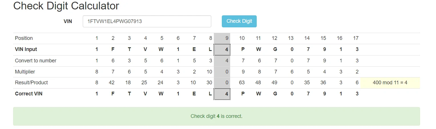

Could you please check VIN - 1FTW1EL4PWG07913. Recently purchased truck, was told everything would be up to date. After reading these forums it seems like nothing was done.
Thanks
VIN is missing a character somewhere.

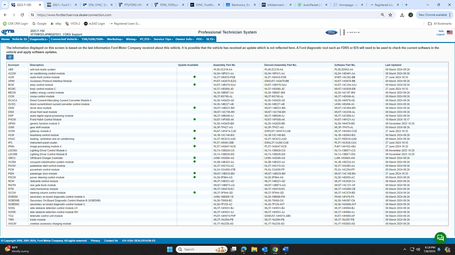

Sorry - 1FTVW1EL4PWG07913
Truck is on Sync version 22326 which is two versions behind the latest one. Modules with pending updates are below:

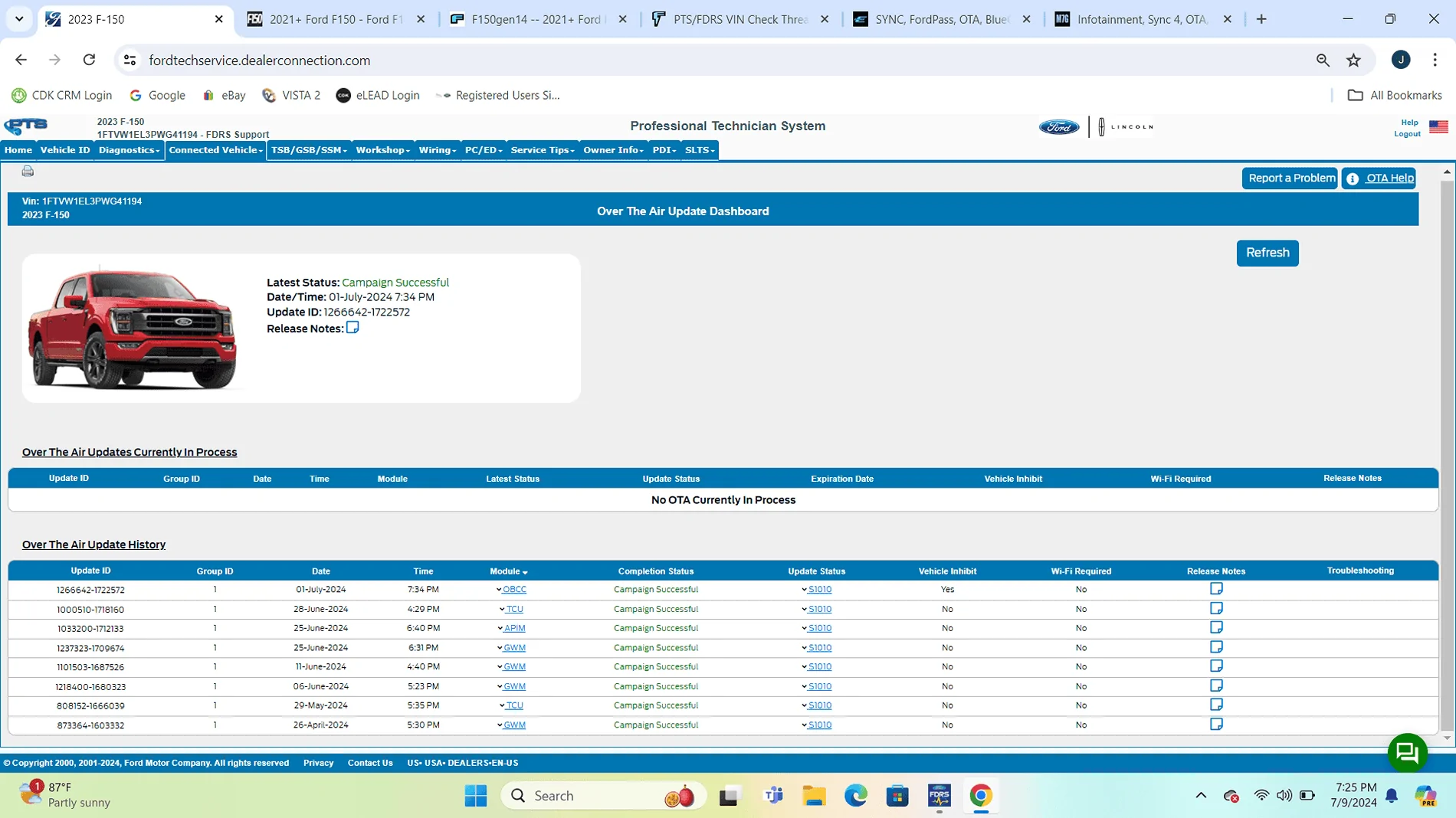

Could you please take a look at VIN 1FTVW1EL3PWG41194 ? I was getting updates pretty frequently for two weeks. Then last week I received notifications 4 times that there would be an update overnight. It would not tell me what the update was and would not let me install it immediately. Said it would install at 1am but never did. Just had the same notification today and am wondering if updates are failing or something.
Thanks!

What you're seeing is what we playfully refer to as a "phantom update" over on the F150 forums. There is no active OTA trigger for your truck at this time. Ignore it.....it will eventually go away.

Thank you for checking. I was optimistic that I was getting caught all the way up. Back to waiting…
