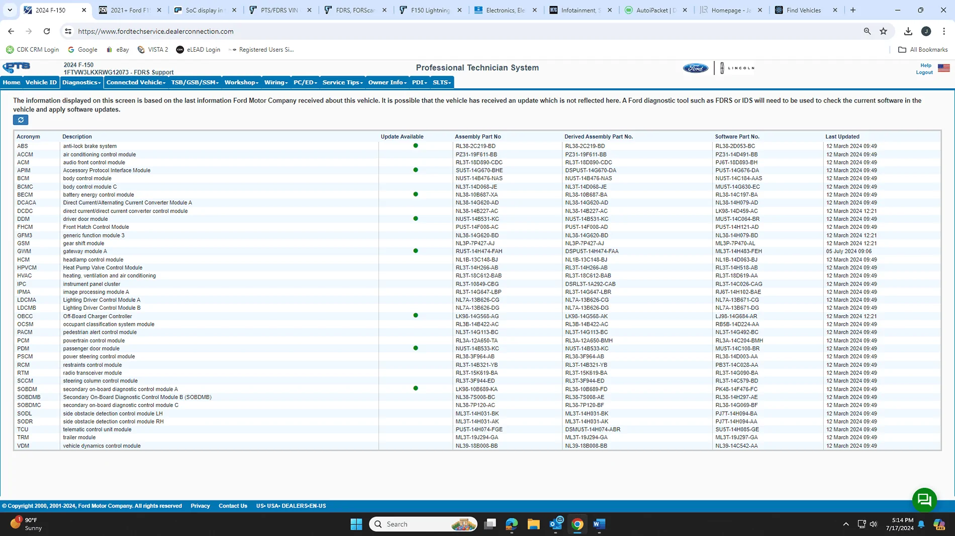

Took delivery July 4th - no issues to report
Modules with pending updates are below. Not many as expected since it is a 2024. However, it does not seem your dealer has reported the sale to Ford yet. The modem appears as both retail and fleet authorized (supposed to be retail only), but all connectivity seems to be working just fine.
