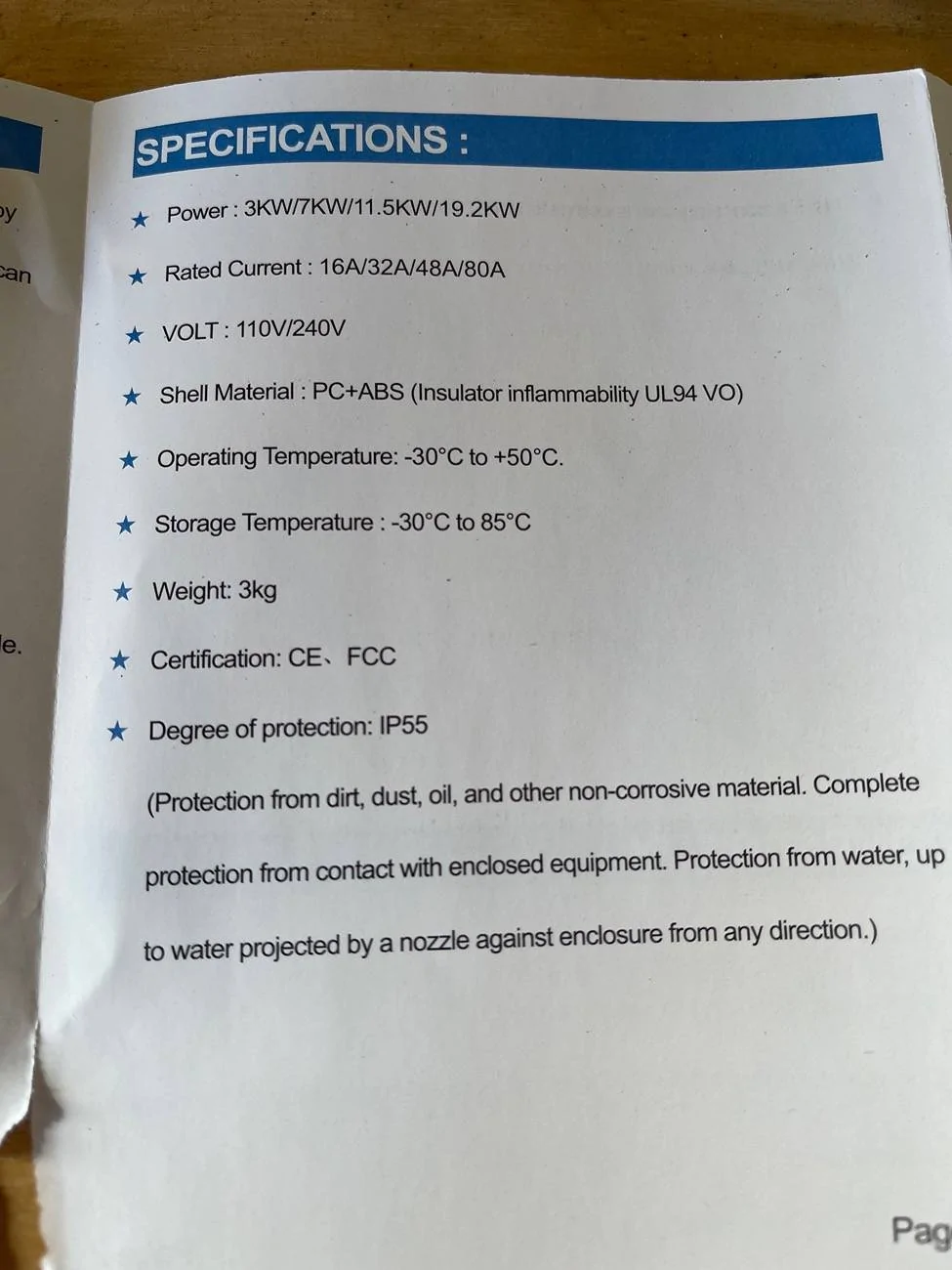

I have since charged my Bolt EUV and Lightning using the ext cord, without issue. It says its rated up to 80a (19.2 kw).

The product you linked is only rated at 48 amps. If you ever try and use it on an 80 amp charger it might get spicy :)

Ford F-150 Lightning Purchased the A2Z j1772 ext cord IMG_1025
You can’t get 80A on a J1772, ford used CCS for that so you’re good.
