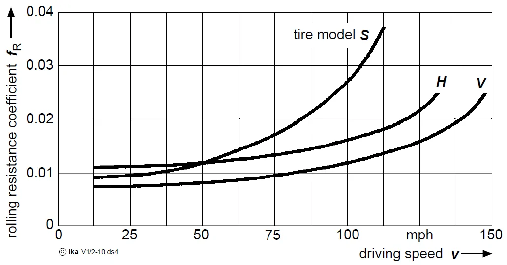

While I don’t know of anyone doing the test in a Lightning, C&D did it in the Rivian and at 75mph the AT’s resulted in a nearly 30% range reduction. And that was at proper tire inflation (it could get significantly worse if tires are under inflated), and ~consistent air temps. The C&D test also doesn’t account for the possibility that certain ATs can perform differently / even worse at higher speeds.
That C&Ds test was done at 75mph is telling. Since drag increases by velocity squared, the difference un drag between 60 and 75mph is something like 50% higher, which means the engine power required to overcome that increase in drag is significantly higher (if it takes 20hp to push the car through the air at 50mph, it will take eight times that – 160hp – to overcome drag at 100mph). If air density (due to colder weather) also increases, grab your ankles.
And while rolling resistance is more like a constant for a given tire at given inflation at a given vehicle weight, at higher speeds rolling resistance does increase due to essentially the tire itself changing certain materials qualities and forces at higher speeds - as such these increases of rolling resistance with speed can be materially different between different tire models due to their different construction/materials:

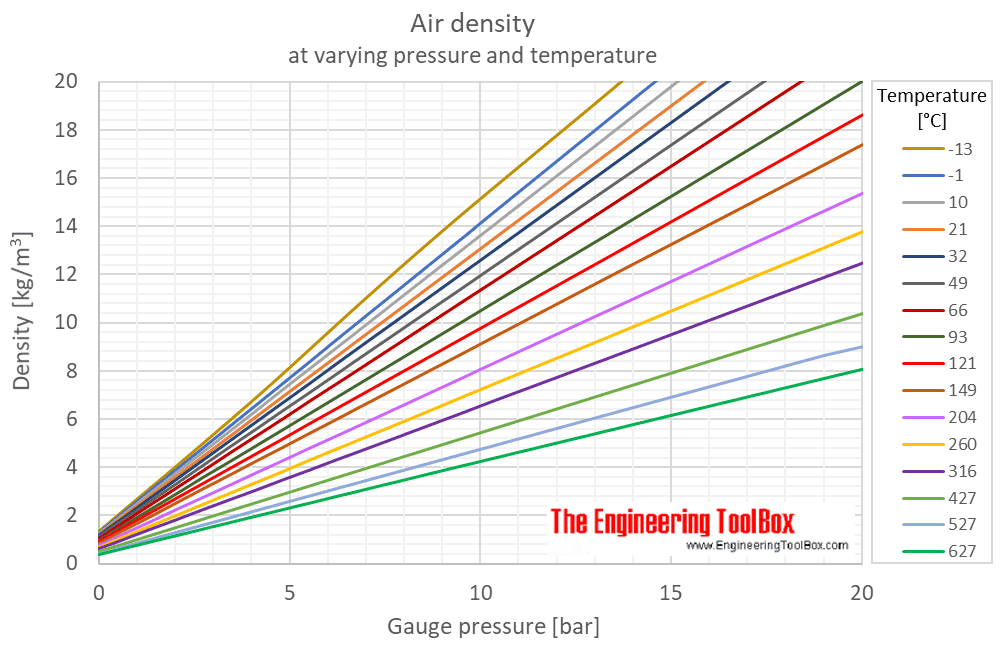

But as a separate matter, air temperature (and pressure! and dew point!) when driving at highway speeds is a significant contributor to drag:
Ford F-150 Lightning Range Super Low? Lariat ER at 1.7kwh 1675881559214
Humid, low pressure, hotter air is far easier for a vehicle to push through than dry, high pressure, cold air. And these air resistance effects are seen as between any temps including 70°F and 80° not just those colder temps that may affect battery performance.
For related reasons (and altitude effects on density/pressure), this is why pilots of certain aircraft (as I understand it) have to consider all these metrics to understand aircraft performance under varying air density conditions.
2,375
2,517
Wouldn't higher humidity make the air more dense since there is an increase in water droplets and thus increase the amount of energy required?
That would be my intuition as well, but apparently the physics of it all is contrary to intuition.
Namely, that ā€œwater dropletsā€ are not what is ā€œinā€ the air, but instead water vapor - which on a volume basis is lighter than (and displaces) air.
