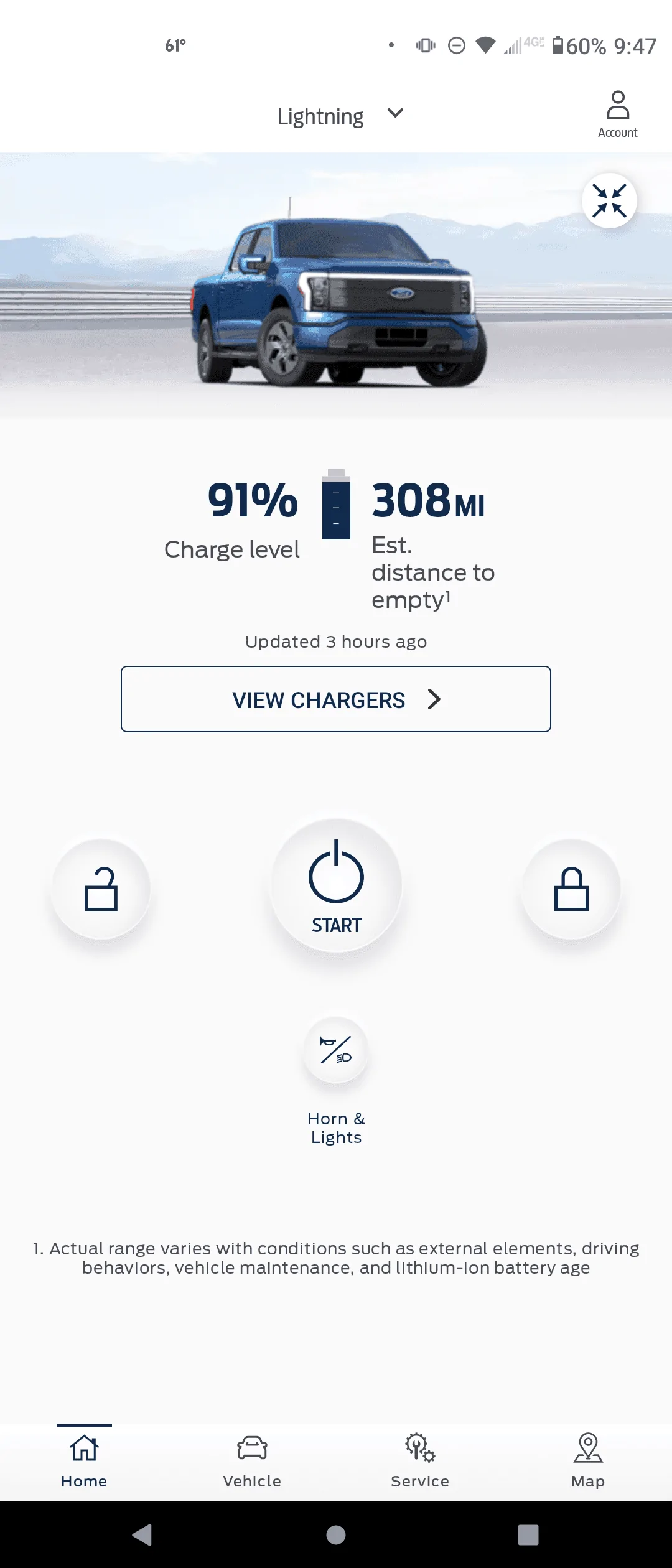

Charged today while at work (free charge is about 2km away yielding a 25 minute walk in the morning and a 4 mile run after work). 9.75 hours on the charger went from 54 to 93 percent. At home now at 91 with 308 estimate. Most of my driving is fairly local averaging 3+miles per kWh, so the GOM is giving me a 2.6 mile per kWh estimate. Echoing a previous post, please give us the raw kWh remaining and instantaneous and recent Wh per mile. With those numbers we can make a guess at our remaining range.
Great suggestions. I hope @Ford Motor Company is listening.

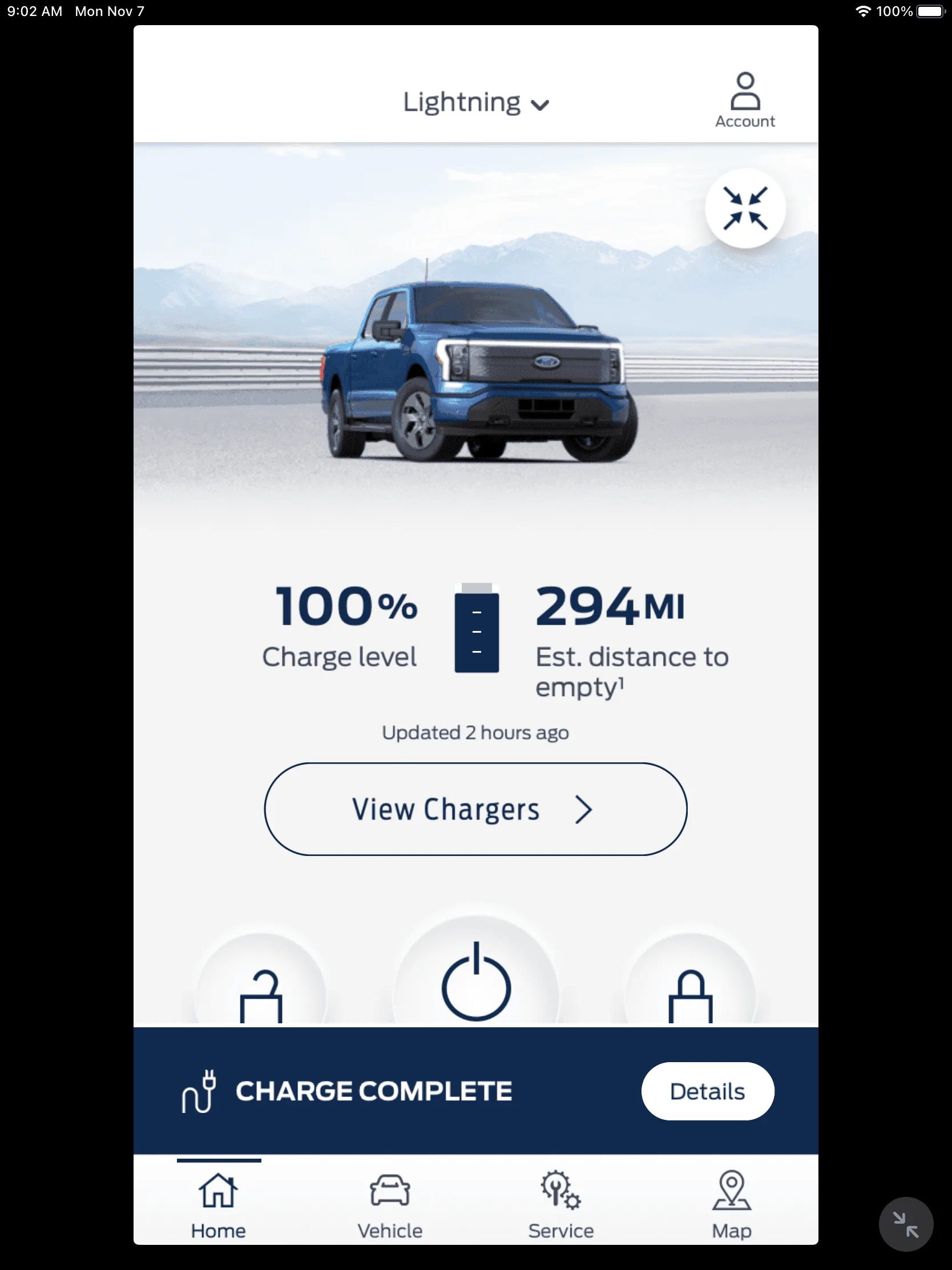

Here's today's range:
I've got a Standard Range... but the warm 77 degree weather + NYC driving give me quite a bit above the promised 230 miles. I'm curious to see the winter drop. My Mach-E SR would drop to about 190 or less.
