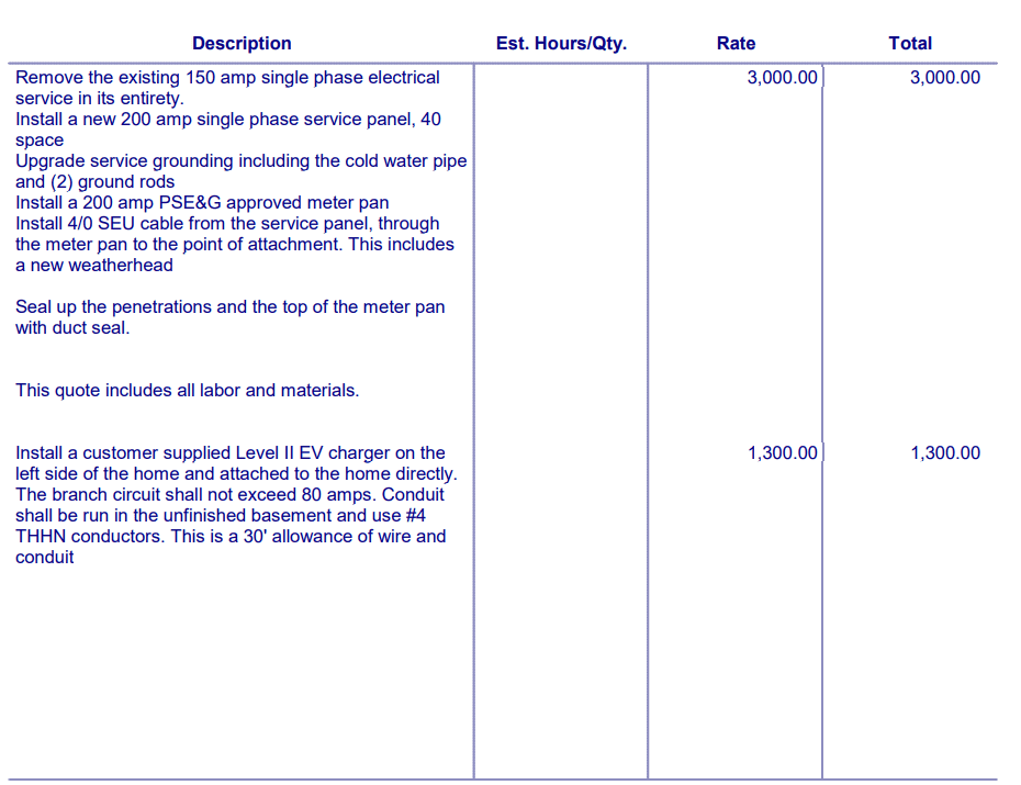

I got a quote from a local electrician...$4300 for a new panel going from a 150amp service to a 200amp service. The panel is full but the main run is on the opposite side of the panel, so its a short run.
Ford F-150 Lightning Ready For The Ford 80A Charge Station Pro 1649963482970
I have another coming out this weekend for est.
An 80A branch circuit with #4 wire will not allow the Charge Station Pro to operate at full output. It needs to be a 100A circuit with #3 wire.
Trying to find that info you provided to show the electrician. Does Ford have a document that you found?
4,193
5,558
My comments were based on my knowledge of the NEC, which treats an EVSE as a continuous load, thus requiring a 20% derate of the branch circuit.
But here is a link to the Ford installation specs calling for a 100A circuit.

Here is the Ford document showing that you need a dedicated 100a 240v breaker to get 80a usable amps. It also says that you can use a 20a-100a breaker which is adjustable in the charge station pro. And, you will get 80% of the breaker amperage as usable. So, if you have an 80a 240v breaker, you should get 64a.
https://www.ford.com/cmslibs/conten...ning/pdf/FordChargeStationPro-Specs_06_v2.pdf
Just a clarification. The EVSE can’t read the breaker size on your circuit. You have to specifically set the switches in the EVSE to limit the charging current.
