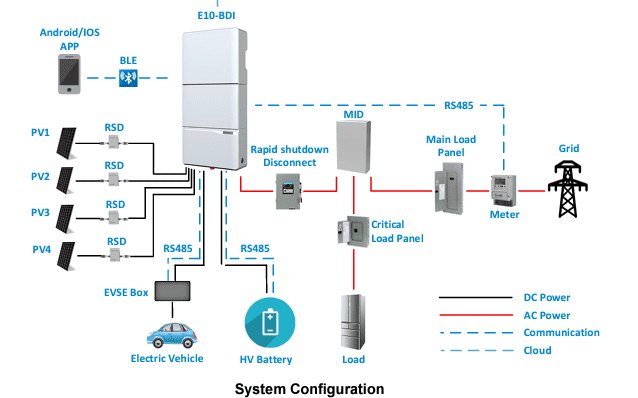

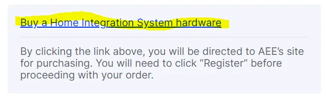

Is this the hardware that Sunrun is going to sell us for intelligent back up? If so, where did you get it? Thanks!
I don’t think so. The diagram shows the only connection to the EV through an EVSE. There is no D.C. connection to the battery in the EV shown.
The final solution may be a derivative of this, but it can’t be this exactly as it’s depicted.
I could be wrong, but think the Pro EVSE and the HIS will switch out the AC current lines to carry the 400vDC back to where it will be inverted to 240vAC, another switch out relay [MID] diverts the inverter output to the critical load side transfer panel.
