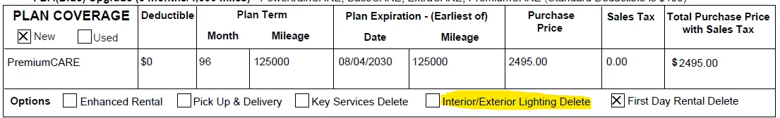

disclosures.
I bet they will not cover it after the 3-year /36000-mile factory warranty period!
Does your plan have an X for "Interior/Exterior Lighting Delete" if so, you're {NOT] covered.
I did not buy the light insurance, thinking the lightbar was fixed after the recall was done on it.
I have had no problems for 2 years until now with this new light bar.
I will get it replaced again now before the factory warranty expires.
