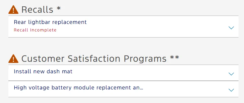

Without having to read the wiper motor recall issue, if I did not receive any notice about the wiper motor issue (or the steering wheel heating issue), my vehicle probably does not have those issues (no problems noticed with wipers or heated steering wheel), so it is probably safe to assume those issues were limited to certain vehicles. Will double check, but I need that major software update, the microcracked tail light and dash mat so that I can put my salt water aquarium on my dash.
Not used to having so many recalls at once, but this is the nature of having one of the early models of a new technology. Was reading an article on the Chevy Blazer EV by Edmunds, and 23 unique problems were discovered in 2 months. We are lucky!
Yes, they updated the part mid production year, you were built with the revised part. This is what your VIN shows from the public search engine.
Ford F-150 Lightning TSB/Safety Recall 23S30: Rear Light bar Replacement for 2022-23 F-150 Lightning 1703171064394
