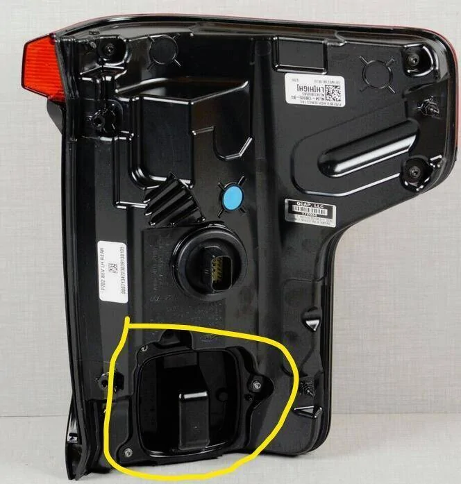

Thank you. Maybe a silly question, but how do I determine if the BLIS sensor is damaged? I don't see any errors in the truck when it's on and it beeps if I back up close to something. Is that sensor the one that shows up on the rear view mirror when a car is on my left warning me not to change lanes, or just the backup one? Is there a place to check this in the settings in the truck or something?
3,163
4,544
It is for lane change and if a car is approaching from the side when you are backing. It is separate than the parking sensors which are in the bumper.
If you're not getting DTC's with a code reader then it is probably fine. What has happened to others is the lens gets cracked where the BLIS is and water gets in and damages the module. If you have a crack, cover with red or transparent tape to limit water intrusion until you get it replaced.
Here is a photo of the BLIS module. It is held in by 3 Torx screws. From the outside, it is at the bottom of the light.
