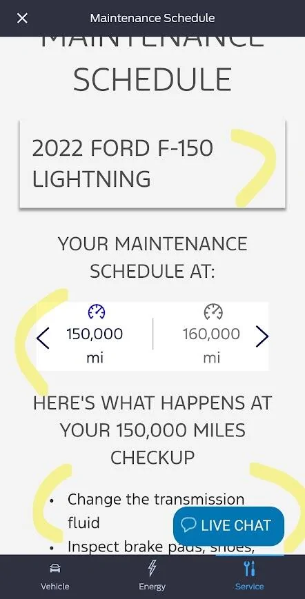

If I recall: someone said oil service around 200K
Truck has just over 18K
200 K is the coolant
150 K is the motor oils
