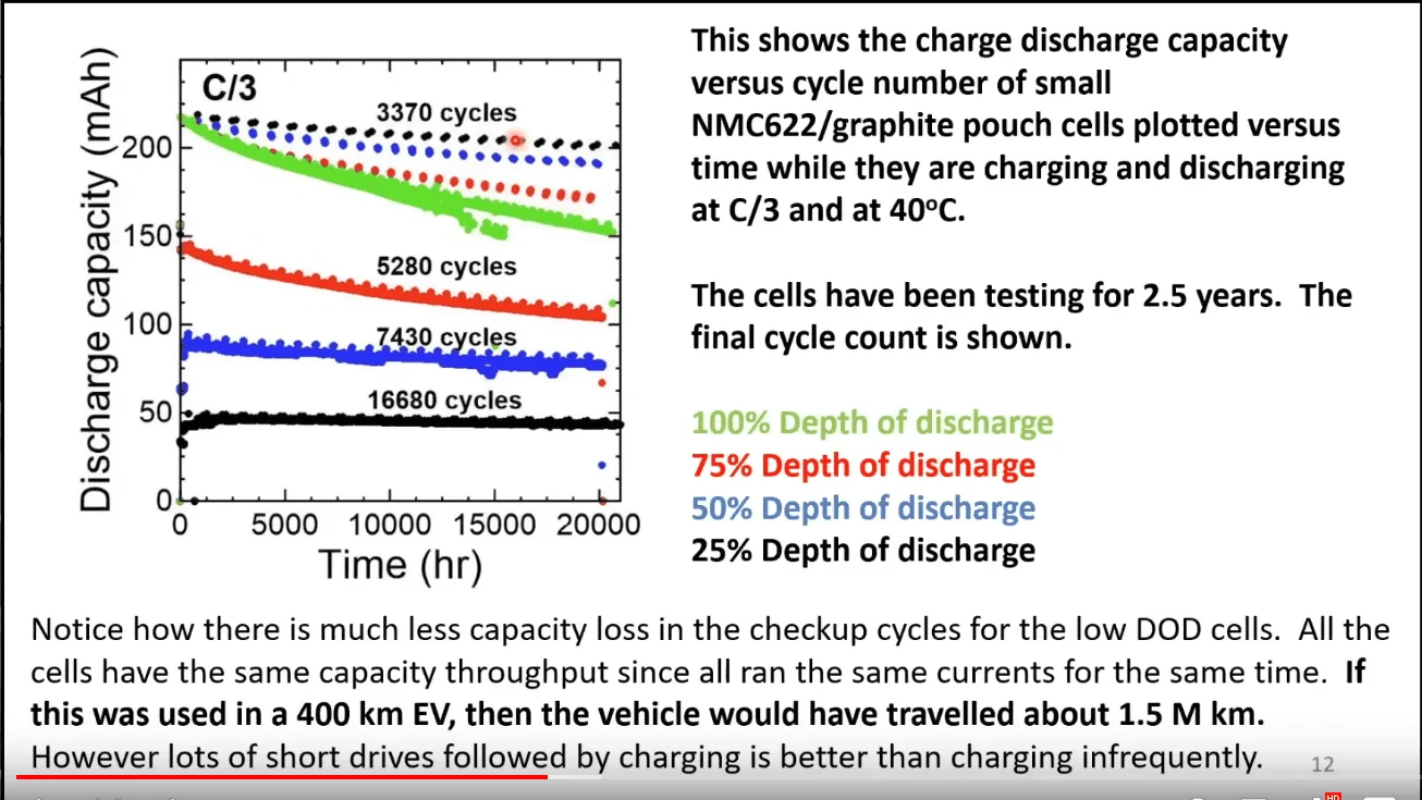

I think it’s perfectly fine to drive the battery down occasionally if needed. You wouldn’t want to do it on a regular basis for longer battery life, but this chemistry will last for a long time.
This chart supports your assertion. The black\blue\red dots across the top are full cycle "capacity checks" taken time to time during 2.5 years of testing.

I don't know if you have seen this chart (I am only a month or so late to the conversation):
https://www.f150lightningforum.com/...epth-of-charge-graph-for-nmc-batteries.19465/
