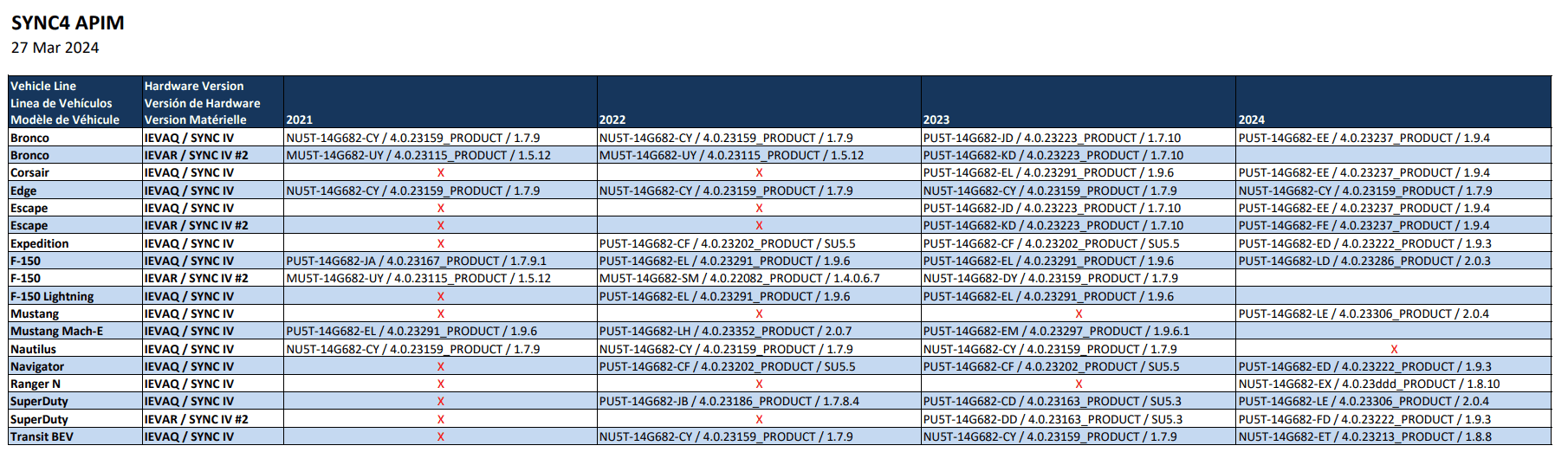

• Find the SYNC 4 Software Version followed by a number structure such as 4.0.*****. (*=numbers) Compare that version to the latest version located in this link: SNYC 4 Latest Software Level.
• If the version in the vehicle is lower than the number in the document, then follow the applicable TSB or SSM to update the software.

• When the system loads, highlight the Diagnostics tab and scroll down and select SYNC. Review the part number or version located next to the CIP and compare that to the latest version located in this link: SNYC 4 Latest Software Level.
• If the version in the vehicle is lower than the number in the document, follow the applicable TSB or SSM to update the software.
