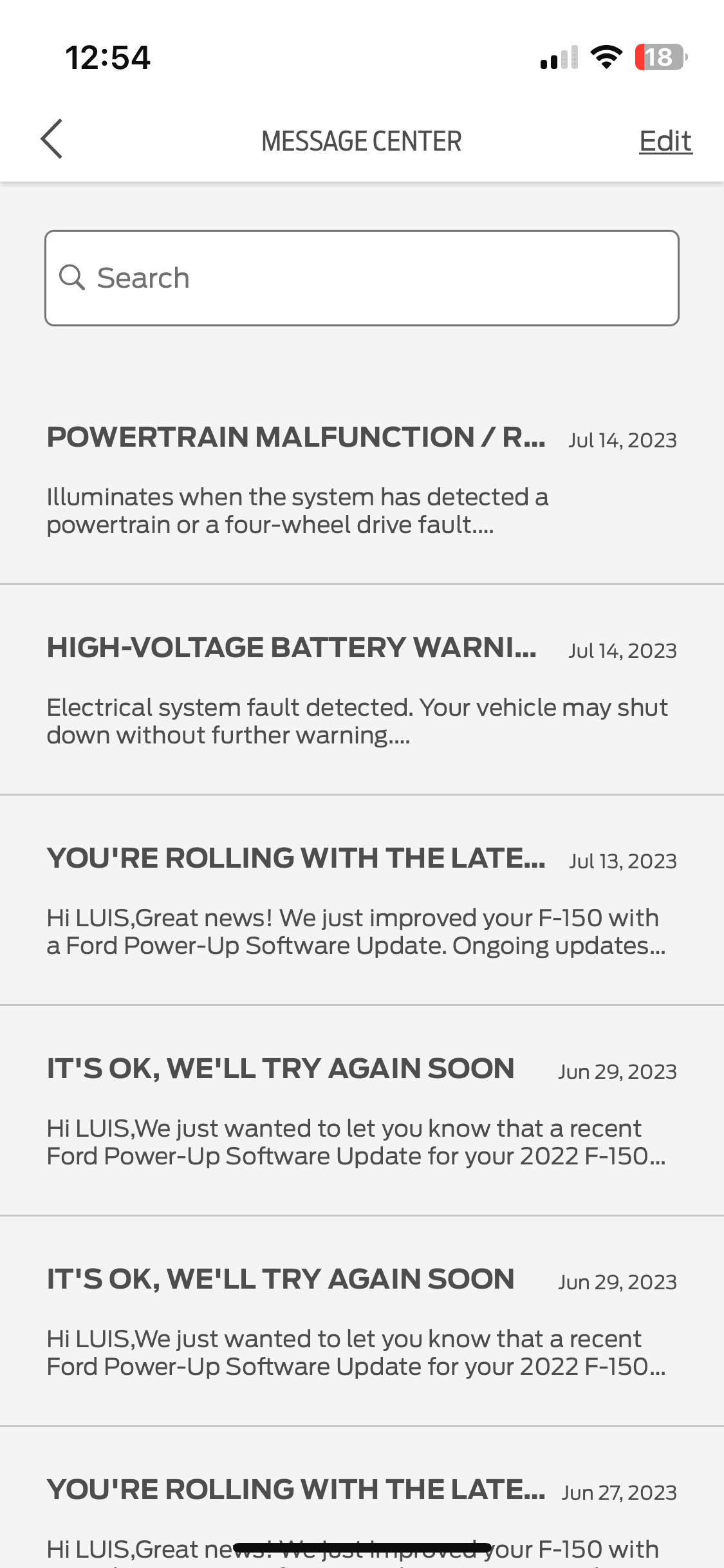

Yep that is the update. Same morning, the error codes arrived. I don’t know if they are related or just a coincidence. I’m on vacation 3 hrs from my dealer. Trying to figure out if this this thing is safe to drive home (at reduced power) or not.
are folks thinking the fault errors are caused by the update (and is there a fix?)

It is coincidence. If your truck will drive it is safe to do so but if the fault reoccurs it will limit your power significantly. Call the customer relations team, ask for the BEV team, and tell them what is going on. They can help if you end up needing a rental to get home

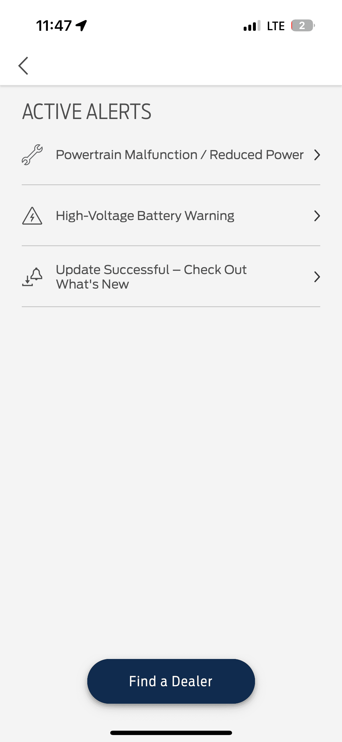

Received these same notices after an update installed. Truck only available with 25% power now ?

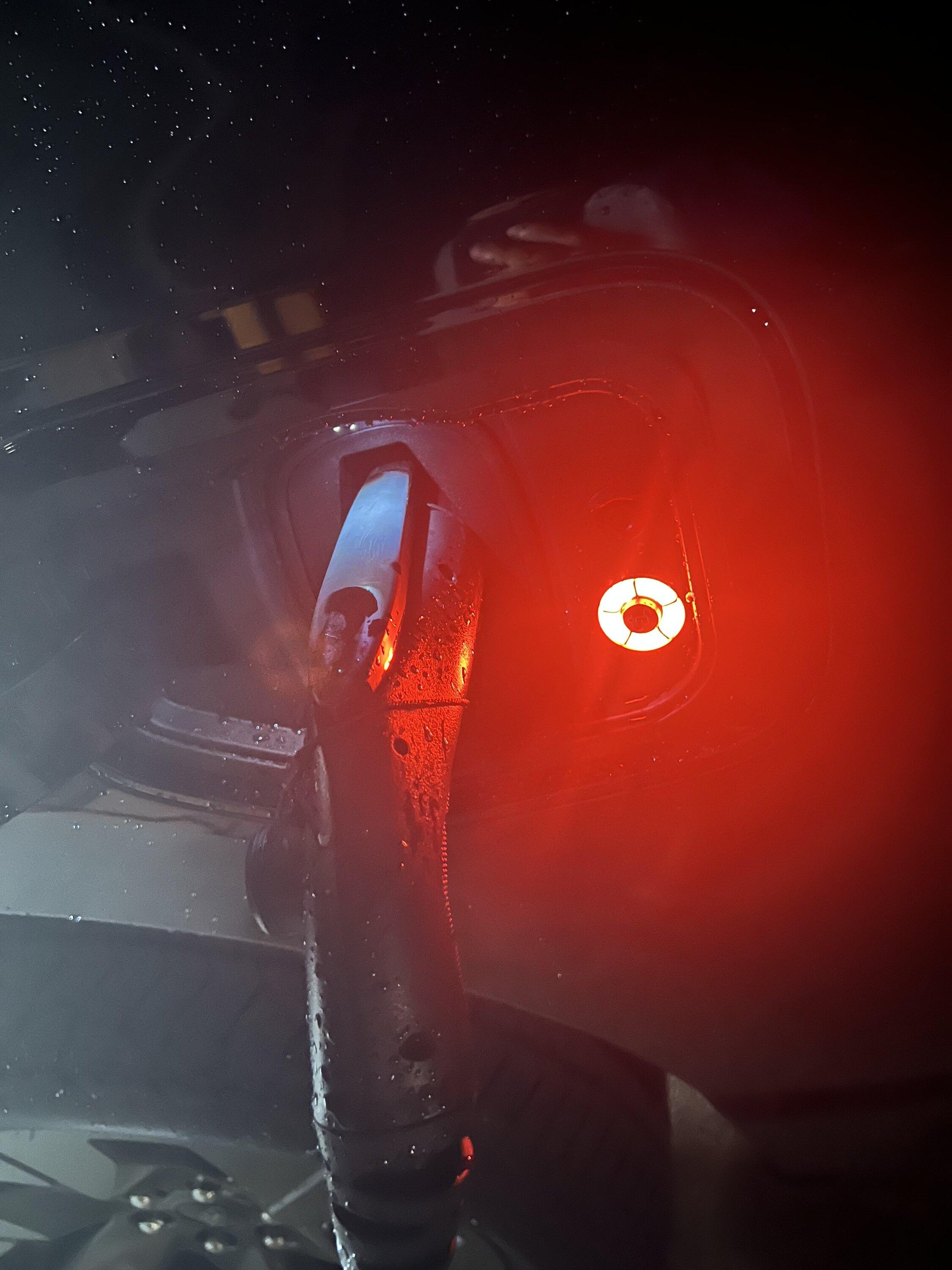

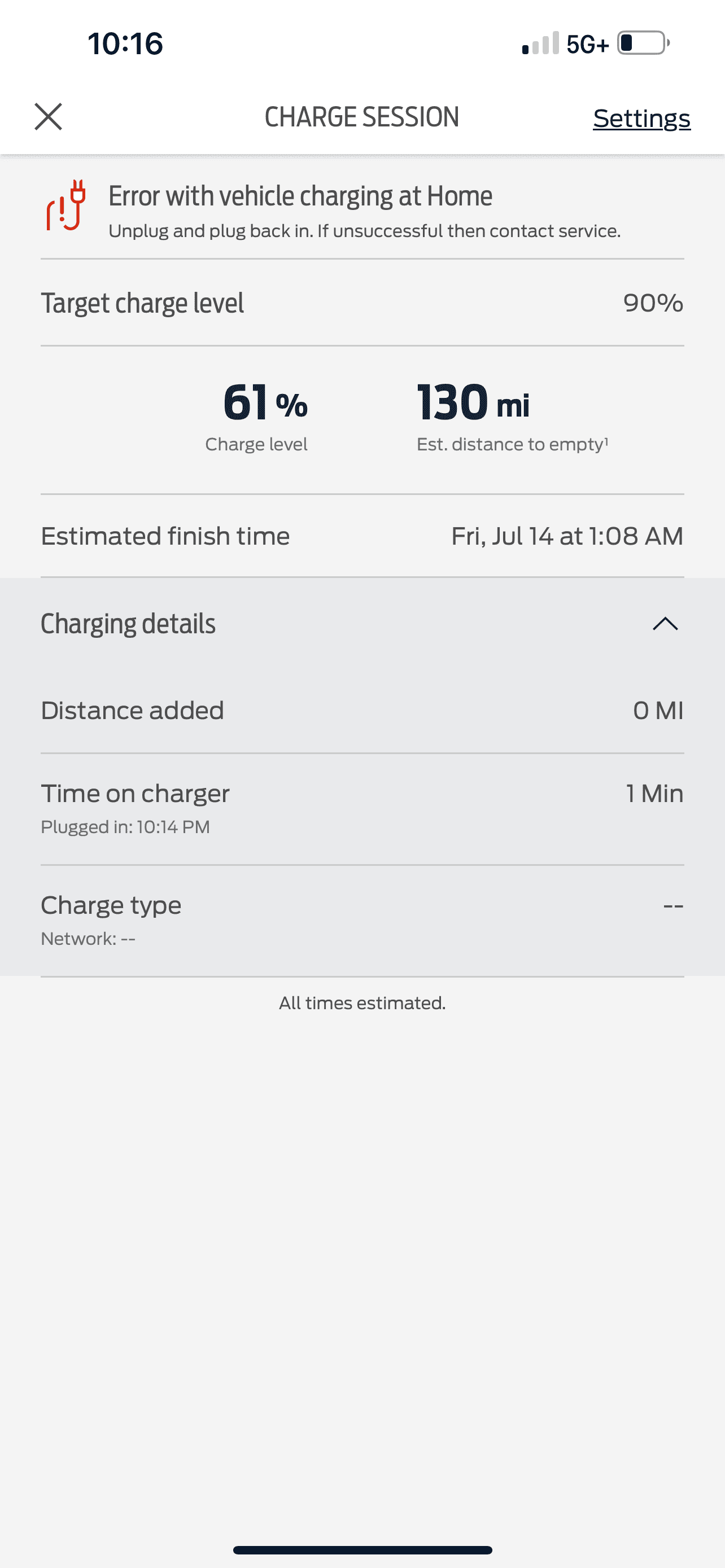

Also not able to charge at home. Receiving red lights and Charge Fault error
