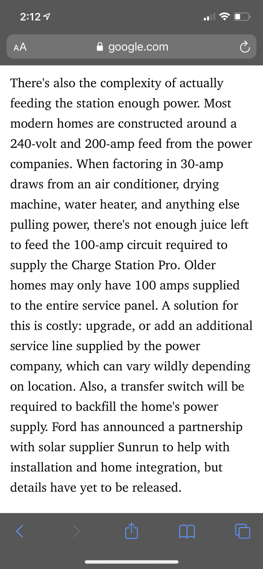

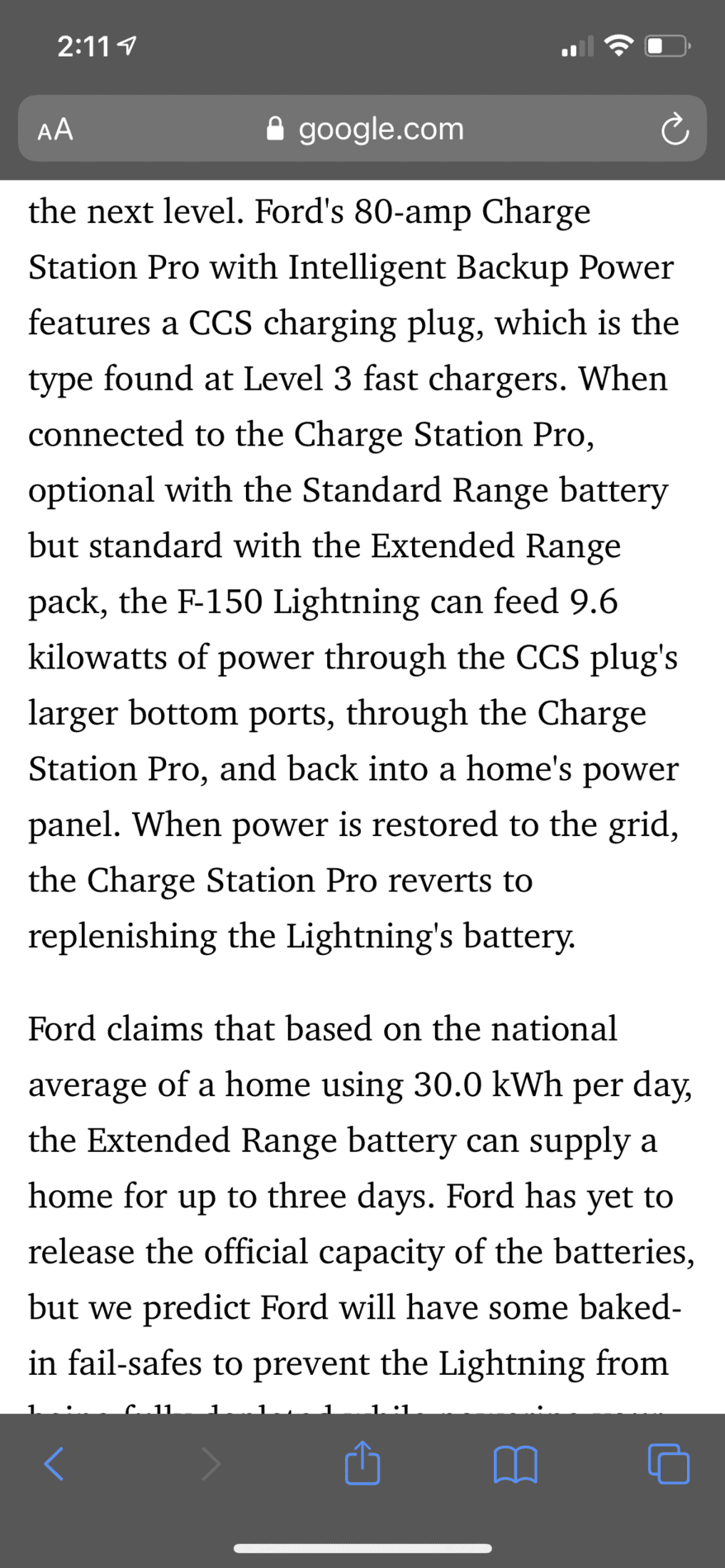

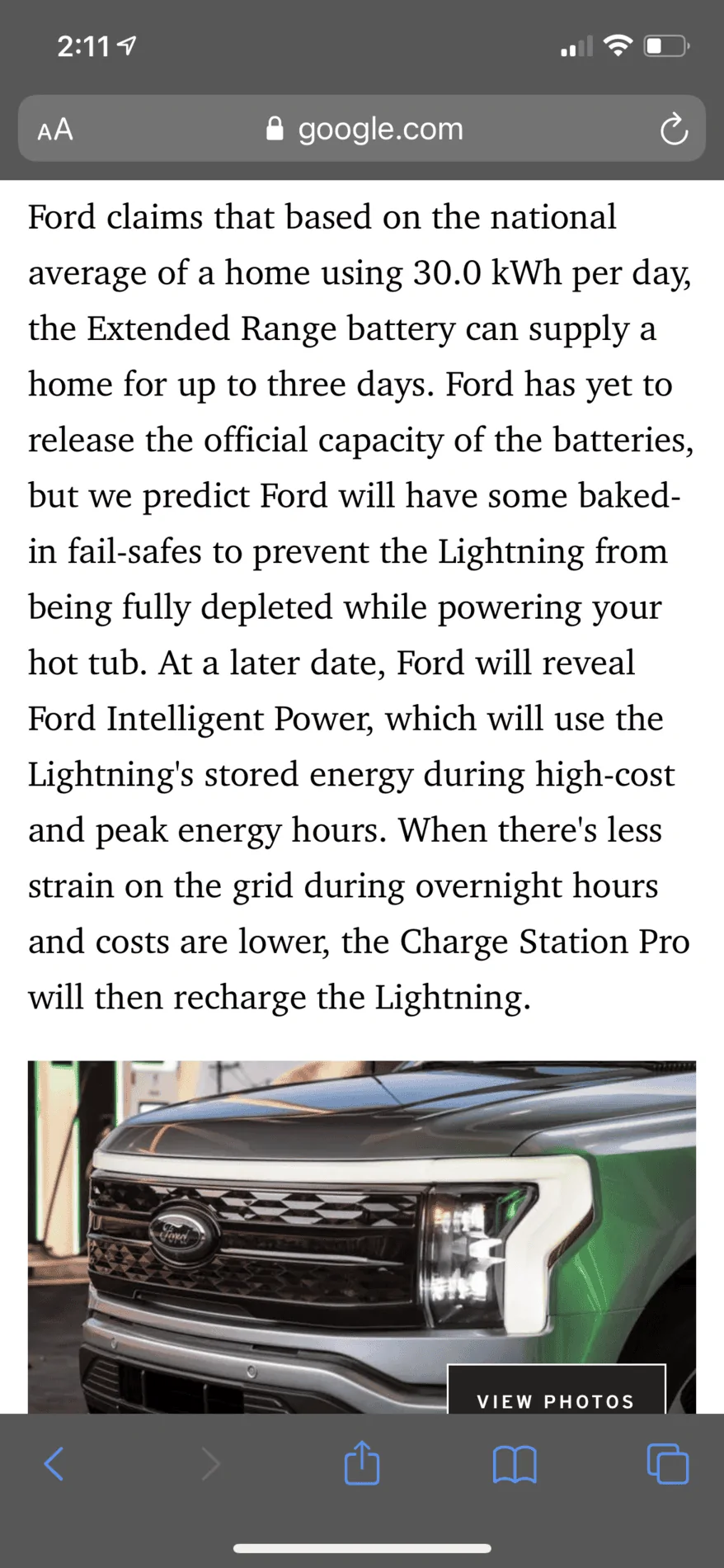

Here is an article, which explains it better than I could. This is exactly what Ford’s fine print says. The things everyone is saying is 1 thing, are actually 2 completely different functions and outcomes, thus the need for an inverter on the wall somewhere.
Ford 80 amp charging station with intelligent back up power - Requirements - Transfer switch needed.
Ford Intelligent Power - Extra equipment needed - (solar panels + inverter installed by Sunrun).
That's the gist of it – the car alone can't service the peak power demands of the house, but with a battery/solar and automatic transfer switch, the car could supply enough power for any given 24hours, and the battery would stand up to the peak demands.
A Lightning or Hybrid could work in a "power shedding" arrangement with a transfer switch.
Of course you really want your fridge and freezer to stay on while the truck is not parked and connected, so a battery-solar makes sense, but the price is a shock.
