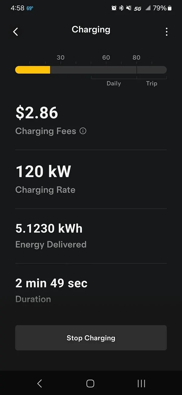

I had a poor charge in Scottsdale. I definitely did not get the full rate.
Ford F-150 Lightning Supercharger Avg Power 1000006743
I have had good luck elsewhere, so hoping that's a one off.

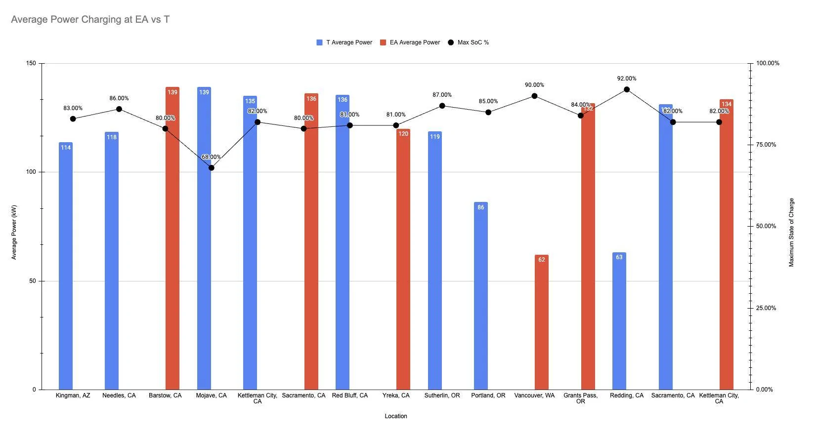

The average power I get from a SC is the same as the average power I get from most other DCFCs.
From a recent road trip:
LocationBrandMax SoC %Total kWhTime on charger (minutes)EA Average PowerT Average Power
Kingman, AZT833619114
Needles, CAT867739118
Barstow, CAEA805122139
Mojave, CAT685122139
Kettleman City, CAT825424135
Sacramento, CAEA805926136
Red Bluff, CAT815223136
Yreka, CAEA818241120
Sutherlin, ORT878945119
Portland, ORT85463286
Vancouver, WAEA90302962
Grants Pass, OREA846831132
Redding, CAT92393763
Sacramento, CAT829443131
Kettleman City, CAEA826931134

Do you record the peak charge rate?

Very rarely. It's not something that's easily extracted from the FordPass app and I've been having issues with the EA app not giving me my data. I don't know if the T app includes it. Finally, I only sometimes remember to turn on CarScanner.
I don't trust my own eyewitness accounting since I rarely stay at the charger after confirming that the charge has started. My "feeling" of what the peaks are is similar for both. I think it's important to distinguish between "peak" and "spike." A peak should last at least a minute or two to be considered valid. A spike lasts less than a minute and may be a spurious data point for all the good it does for charging the vehicle.
To me the peak is a meaningless number unless I'm only charging for 5 to 10 minutes, and I've only once done that (out of hundreds of DCFCs). I have a record of charging at a T charger for 9 minutes. In those 9 minutes the charger added 25 kWh for a 167 kW average. There was a very short spike to about 170 kW. We unplugged at 49% SoC, so this was in the sweet spot range of highest charge rates.

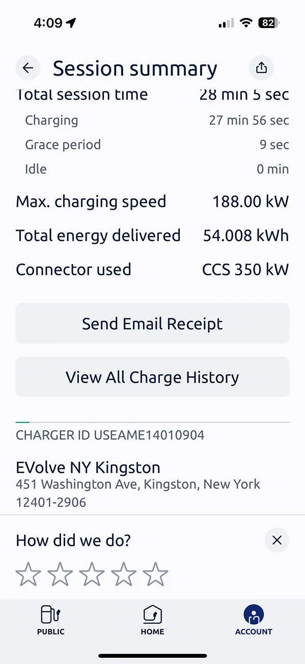

I've hit 188kW and 178kW max on a newer EA charger in Kingston NY. It lasted a few minutes at most. Still took 28 minutes to go from 49% to 85%, tanking down to 60ish kW at 80%, so still followed the charge curve. Warm battery and a cold day!

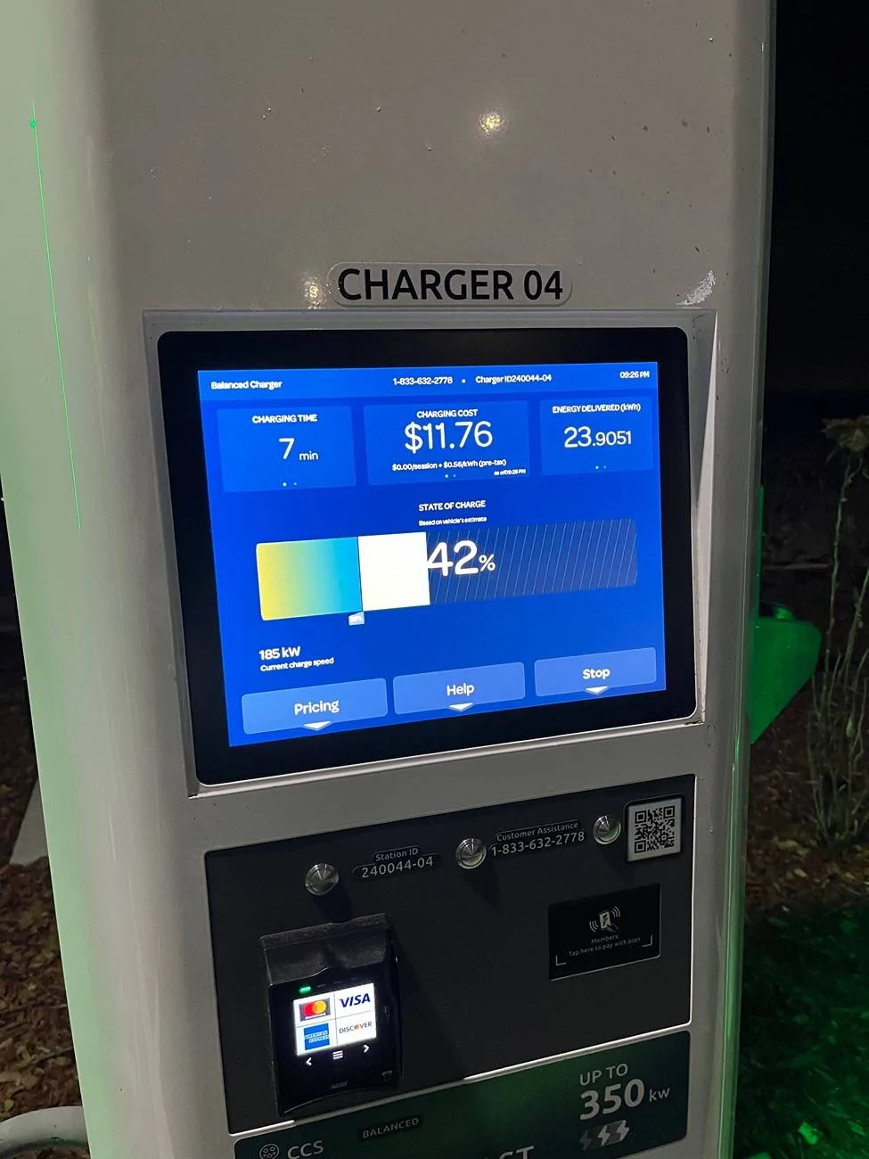

EA station charger screen picture after approximately 7 minutes of charging with battery initial state of charge at 18%.

I'm curious if we get an improved charge curve at some point. I don't recall anyone topping 175kW when I was following this closely.
EDIT: This is from @tommolog original charign test report. He never saw over 170kW even when starting the charge at multiple different SoC. 40% and 50% had the best peak rates.
https://insideevs.com/news/615115/ford-f150-lightning-charging-analysis/
Ford F-150 Lightning Supercharger Avg Power IMG_1350
EDIT #2: Here's a more recent thread showing a 195kW charging rate on an EA station.
https://www.f150lightningforum.com/forum/threads/195kw-charging-speed.19647/
