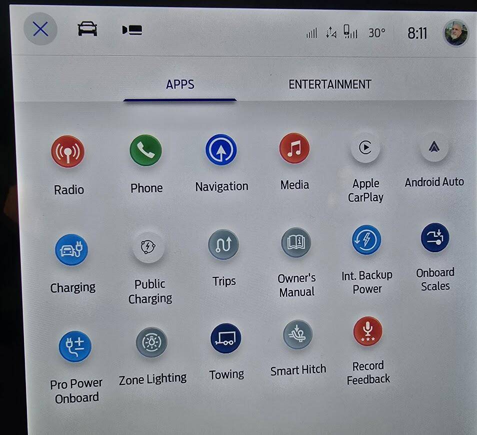

Thanks.. But I can't even find the 1 time charge limit setting. It wasn't visible in the FP app while charging, and I simply can't find the Charging part of Sync.
4,292
5,738
Charging is it’s own app on the “Home” screen.

As soon as you begin your public charging session take a look at the charging app on the sync APPS screen, the slider will be at the default 90% hit the + or swipe it to the right to increase the value then click save to store the new value.

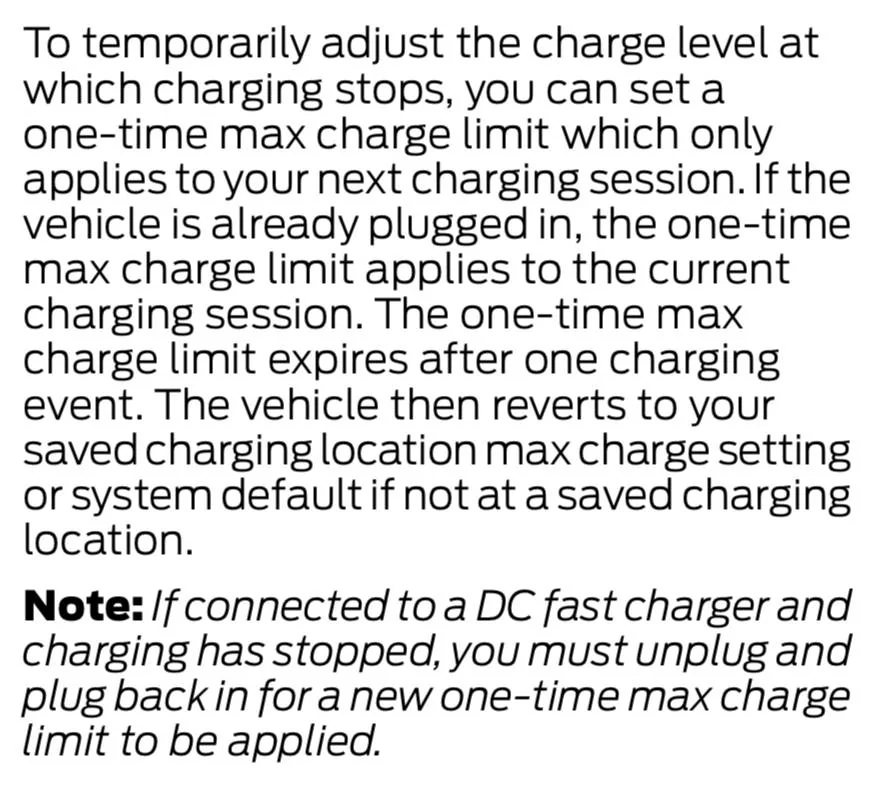

Thanks for this TaxMan....I just encountered this yesterday as well.
I was charging at a supercharger before bringing our new travel trailer home, and I had planned to charge to 100%. Yes I know it is slow after 80%, and slow AF after 85%, but I had the time and the charger had tons of empty stalls. I wanted to get to 100% because I had 180kms of towing ahead of me, with a new trailer i had only test-towed for half that distance...on a slower highway.
Anyways....in the App, I had set the charge to 100%. Then I went inside an outdoor store that was closing down for some gear, and got the notification my truck hit 90% and stopped.
I checked the app, it was still set to 100%. I hit to try and start the charge again from the phone, no dice. Went into the truck and changed the Sync setting for 100% one time charge limit, and reconnected the charger, and didn't work again either.
Went to the trailer store, and while sitting there for 2+ hours of paperwork and shit, got my truck charging on a level 1 charger up to 92%, but was still frustrating to not get that 100% I was looking for. I got home with only 7% SOC...that extra 8% I was missing woulda been really nice!!

I'm not certain it's been a while since I did DCFC session, I do not think the 100% button on the Fordpass app applies to the DCFC charging session limit, could be but I have never tested that method of operation.
Tried & true, is use the Sync App control to increase the default, it should work before or during the active session.
