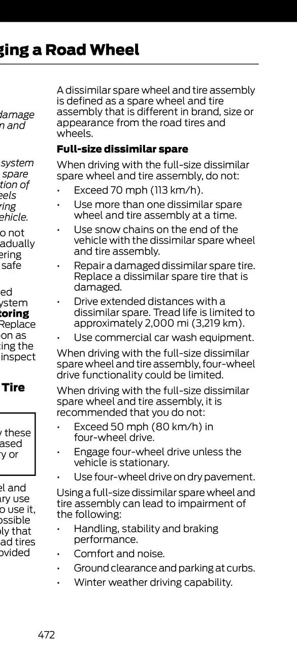

Max speed is 70 mph when using a full sized dissimilar spare according to the owner's manual. It also says max speed is 50 mph when four-wheel-drive is engaged, which is not applicable to a Lightning and tells me it's generic information. My guess is the limit is due to limitations of a differential, which Lightning has so 70 mph seems right to me. That's what I did when I had to use a spare.

Source? My screenshot above is from page 472 of the 2022 Lightning Owner's Manual.
I looked at the tire. Says TEMPORARY SPARE in big letters. That was a big clue.
Okay. Why do you think the limit is 50 mph when the Owner's Manual says it's 70?
