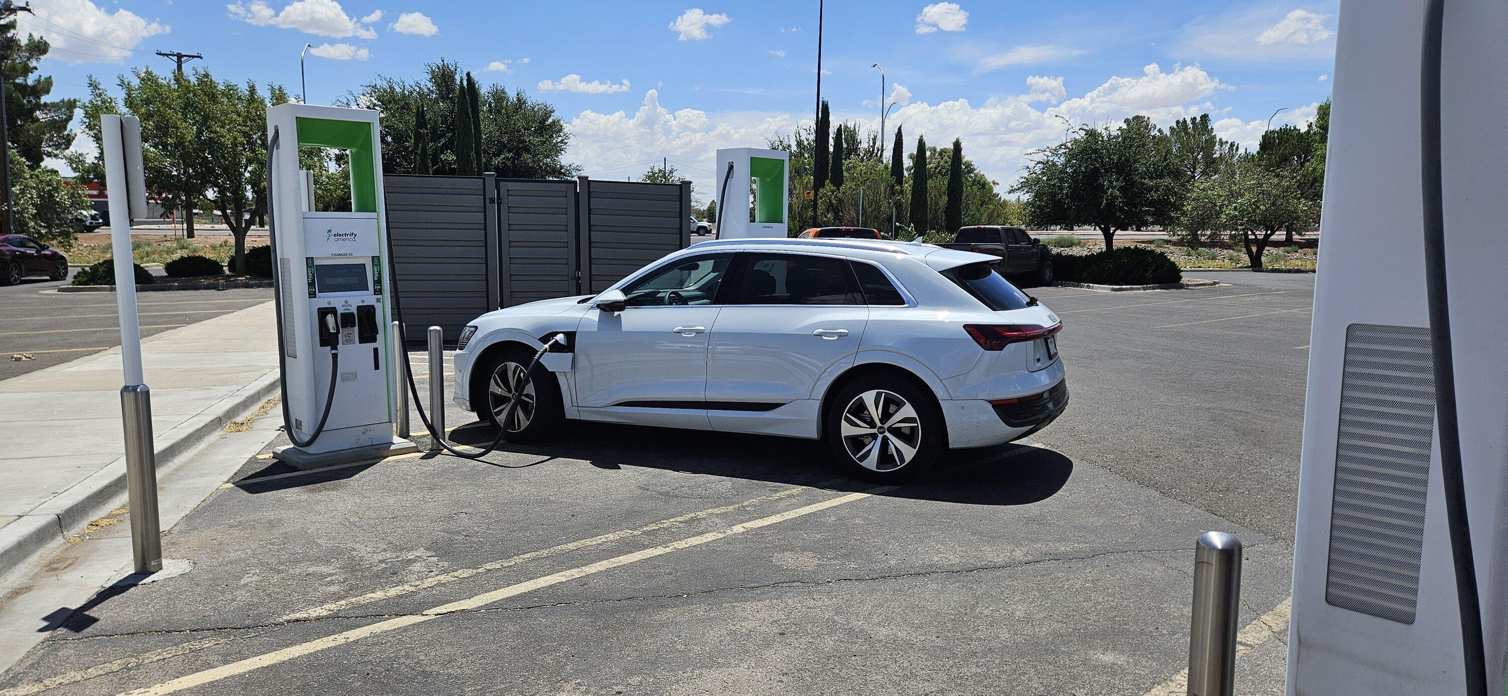

Fast forward to today....*sigh*... it was a rough day. Left like normal with 85% and made it to Deming. Then I was greeted with this:
Ford F-150 Lightning TPMS saved me, plus a bonus rant 20240811_133246
Yep, he's blocking 3 spots. Brand new e-Tron, this fella was over 90%. I tried charging on the same stall that I used 24 hours prior and it was stuck in the reboot screen. Tried the other, and it kept faulting after a couple minutes. So we had to wait for the owner to return. Was an old guy and his wife. I waited for them to load their shopping bags and when I faulted for the 3rd time I resigned myself to asking him to move. I tried everything in the book to convince him. He claimed the cord was too short if he pulled in normally and he HAD to have 100% charge so he could make it to Tucson. He spent more time waiting for 100% then if he had just done a quick top up in Benson. I was so angry when I gave up talking to him, I was shaking when I got back in my car. He was the grumpiest, rudest, most inconsiderate old man I've ever encountered.
