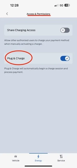

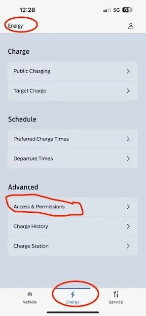

I managed to (after disabling Plug & Charge, though not sure if this actually did anything at all...) activate the charger in the Tesla App via the pedestal ID and location, and I successfully charged the truck!
