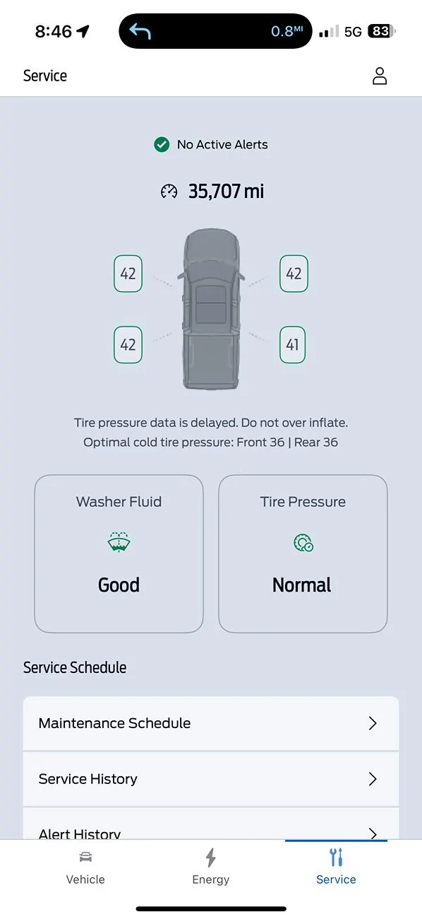

Trucks at dealership for TSB. This is new, or was this in the most recent beta release?
Your truck has nothing to do with how the app looks and you know if you received the email from Ford and are in the beta. If you are posting someone else's screen shot and you don't have it in your version of the app, then you know they are violating their terms of the beta program.
