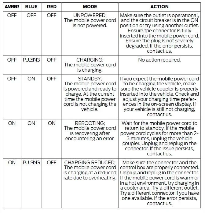

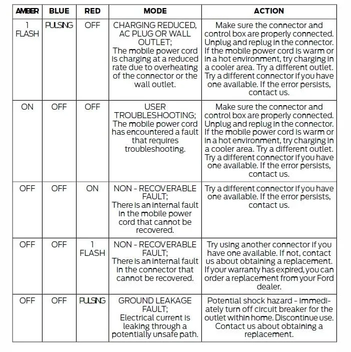

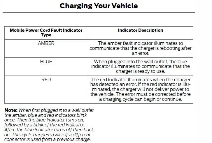

If you look at the fault indication table for the FMobil it might tell you something:
Ford F-150 Lightning Unable to charge, breaker trips error codes 1
Ford F-150 Lightning Unable to charge, breaker trips error codes 2
Ford F-150 Lightning Unable to charge, breaker trips error codes 3
