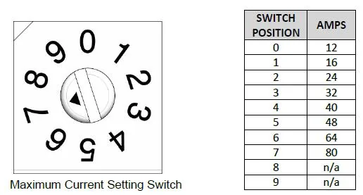

Then hard wire the FCSP. Set the dial based on breaker size x 0.8 (e.g. 60A breaker =48A charge setting, 50A breaker=40A charge setting):

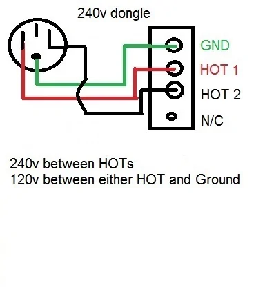

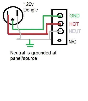

I had a 6-50 outlet for my GE Watt Station and I just bought a heavy-duty adapter to accommodate the 14-50 plug on the MPC - works fine. Don't need a neutral anyway for the 240V dongle (see attached images).
